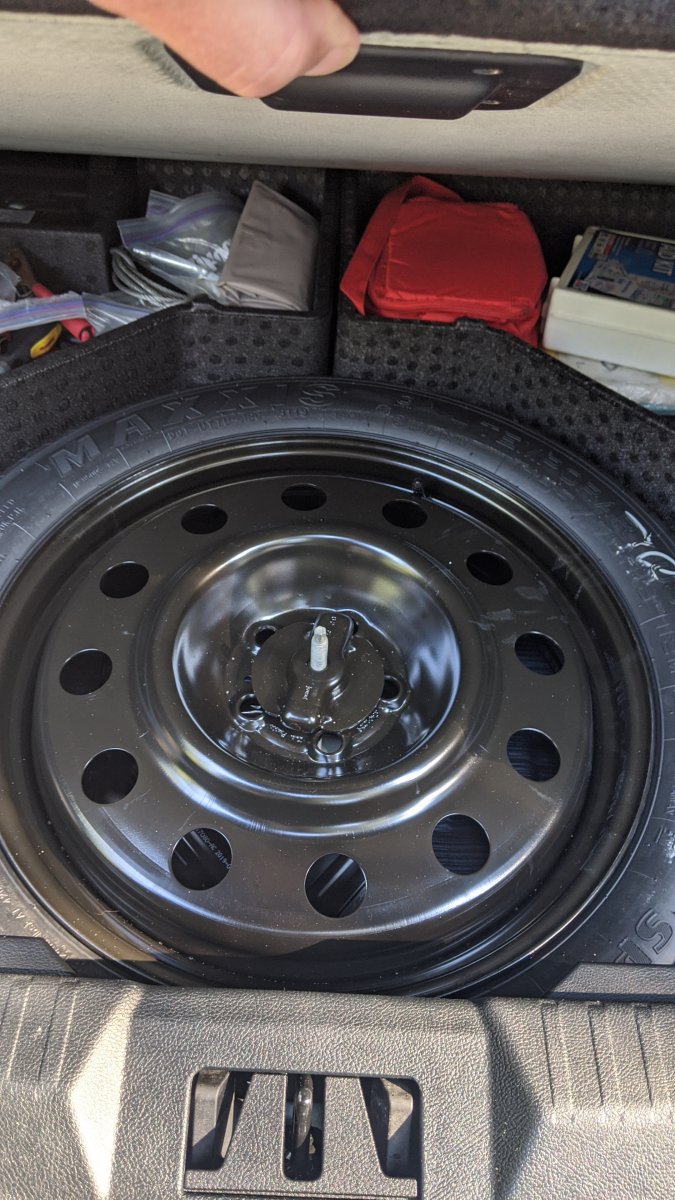

Snoking Posted September 9, 2020 Report Share Posted September 9, 2020 In full size, does that include width? I do not think the spare tire compartment is not deep enough for that . I can look later this morning. We have the 20" rims and a skinny spare tire. Chris Quote Link to comment Share on other sites More sharing options...
Snoking Posted September 10, 2020 Report Share Posted September 10, 2020 Here is a picture of the temp spare(skinny) in our 2020 Edge ST Quote Link to comment Share on other sites More sharing options...
handfiler Posted September 10, 2020 Report Share Posted September 10, 2020 On 9/8/2020 at 8:50 PM, mrnaglejr said: Can you fit a full size spare in a 2020 Edge ST with 21” rims? You cant. Not only is the tire recess not deep enough, the diameter of it is not large enough. Quote Link to comment Share on other sites More sharing options...

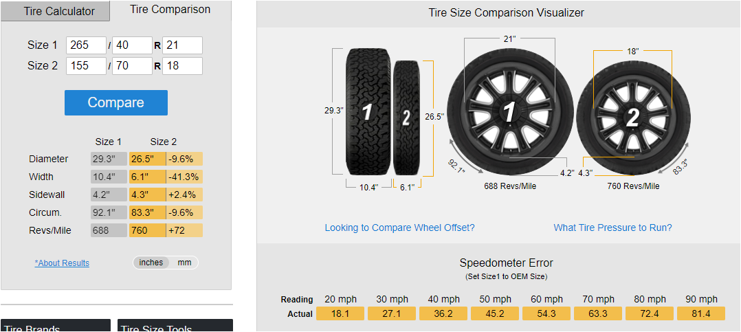

omar302 Posted September 10, 2020 Report Share Posted September 10, 2020 Just to visualize the difference in size between the spare & regular wheel/tire: 1 Quote Link to comment Share on other sites More sharing options...
dajo2012 Posted September 10, 2020 Report Share Posted September 10, 2020 9 hours ago, Snoking said: Here is a picture of the temp spare(skinny) in our 2020 Edge ST Did your 2020 ST come with this spare or did you add it? Quote Link to comment Share on other sites More sharing options...
ONEDGE16 Posted September 10, 2020 Report Share Posted September 10, 2020 (edited) The ST with performance brake package and summer tires will not get a spare tire. You will get a repair kit instead. The ST without the performance brake package will get the mini spare tire. Edited September 10, 2020 by ONEDGE16 1 Quote Link to comment Share on other sites More sharing options...

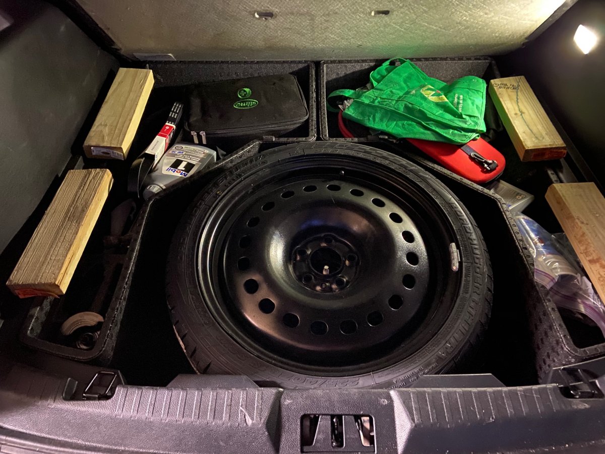

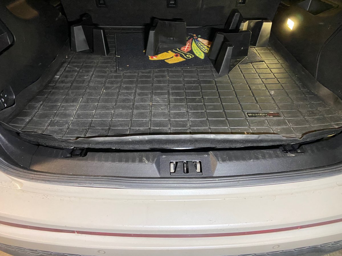

CharlieB Posted September 14, 2020 Report Share Posted September 14, 2020 Have a 2015 Edge Sport with the 21" factory wheels. I (Actually my wife) wanted something better for a spare so I researched what you can do for a more durable spare tire. First, nothing wider than the skinny temp spare will fit under the rear cargo floor without raising it up some. My solution meant the cargo floor (spare tire cover) needs to raised up 1.5". Since a 2 x 4 is between 1.5 and 1and 5/8" in thickness I cut a 2 x 4 up so it rests on the ledge where the cargo floor rests and now the cargo floor rests on top of the 2" x 4"s laying on their sides. There are more elegant solutions but for now I used the Easy button. That earlier photo of the 2020 Edge spare looks identical to the 2015 we have. OK so what wheel fits the 2015 Sport with the 345mm front brake rotors. Now here's where I got lucky. I have an obsession with the '90 - '95 Thunderbird SC's which also use the 5 - 108mm bolt pattern, after test fitting several T-bird wheels I had, I determined you need an 18" steel wheel to clear the brakes. So I found a steel wheel part number X48508 from RTX (available from Amazon) 18X7.5 Bolt Pattern: 5-108, Center Bore: 63.4 with an offset that works on the Edge. It's a Volvo SUV wheel, thank you Ford for the parts bin engineering when you owned Volvo. Now for a tire. To fit in the spare tire well you need to keep the tire diameter below 26" preferable closer to 25" and it has to fit on a 7.5" wide wheel. One possibility is a 225/40R18 with an XL load capacity as the Edge is no feather weight. Since tire diameters vary by manufacturer you need to check this out before purchasing a tire. When I have an opportunity I'll snap a photo of the tire in place and post it in the future. The spare tire hold down bolt isn't long enough to extend thru the wider wheel, but the jack is secured with its hold down and nothing rattles. With the Covid 19 pandemic my wife needs to commute monthly between Central Texas and the Chicago area for family, she's not comfortable flying right now so she's driving and wanted a real spare. BTW love the Edge Sport, it leaves my stock Thunderbird SC in the dust and runs neck and neck with my Modded T-Bird. Love my modded T-Bird as it's one of the rare 5 speed cars, and there's something about twin screw blower whine. For my wife as a daily and for longer trips the Edge Sport is pretty stealthy highway cruiser. 1 Quote Link to comment Share on other sites More sharing options...

CharlieB Posted September 20, 2020 Report Share Posted September 20, 2020 Our Edge is FWD (wish it was AWD but we got a great deal on it) so I don't have to worry about the AWD and different diameter tires. My wife is very capable of changing a tire, when she travels she has a small floor jack and my old cordless impact (all in a travel tool tote). It takes up some space but the piece of mind is worth it. As our vehicles age I carry more spare parts and tools. I have an F250 with the 7.3 diesel with over 300K on it. The spare parts are now in their own tote, separate from the tools. A couple of photos of the larger spare in the rear area and the raised rear cover. Quote Link to comment Share on other sites More sharing options...
