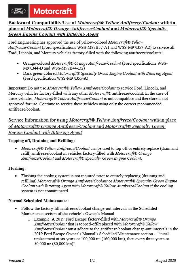

1004ron Posted September 7, 2020 Report Share Posted September 7, 2020 (edited) I would rather trust the official notice from Ford Corp. than a few guys at the local dealership. Did you see the link I attached to another thread on the same topic, and the PDF included? www.fcsdchemicalsandlubricants.com/quickref/FCSD%20Motorcraft%20Yellow%20Antifreeze-Coolant%20Backward%20Compatability.pdf Version 2 August 2020 Backward Compatibility/Use of Motorcraft® Yellow Antifreeze/Coolant with/in place of Motorcraft® Orange Antifreeze/Coolant and Motorcraft® Specialty Green Engine Coolant with Bittering Agent Ford Engineering has approved the use of yellow-colored Motorcraft® Yellow Antifreeze/Coolant (Ford specifications WSS-M97B57-A1 and WSS-M97B57-A2) to service all Ford, Lincoln, and Mercury vehicles factory-filled with the following antifreeze/coolants: • Orange-colored Motorcraft® Orange Antifreeze/Coolant (Ford specifications WSS-M97B44-D and WSS-M97B44-D2) • Dark green-colored Motorcraft® Specialty Green Engine Coolant with Bittering Agent (Ford specification WSS-M97B55-A) Important: Do not use Motorcraft® Yellow Antifreeze/Coolant to service Ford, Lincoln, and Mercury vehicles factory-filled with any other Motorcraft® antifreeze/coolant. In the case of these vehicles, Motorcraft® Yellow Antifreeze/Coolant is not compatible and therefore is not approved for use. Continue to service these vehicles using only the correct recommended antifreeze/coolant. Service Information for using Motorcraft® Yellow Antifreeze/Coolant with/in place of Motorcraft® Orange Antifreeze/Coolant and Motorcraft® Specialty Green Engine Coolant with Bittering Agent Topping off, Draining and Refilling: • Motorcraft® Yellow Antifreeze/Coolant can be used to top-off or entirely replace (drain and refill) antifreeze/coolant in vehicles factory-filled with Motorcraft® Orange Antifreeze/Coolant and Motorcraft® Specialty Green Engine Coolant. Flushing: • Flushing the cooling system is not required prior to entirely replacing (draining and refilling) Motorcraft® Orange Antifreeze/Coolant or Motorcraft® Specialty Green Engine Coolant with Bittering Agent with Motorcraft® Yellow Antifreeze/Coolant if the cooling system is not contaminated. Normal Scheduled Maintenance: • Follow the factory-fill antifreeze/coolant change-out intervals in the Scheduled Maintenance section of the vehicle’s Owner’s Manual. o Example: A 2019 Ford Escape factory-filled with Motorcraft® Orange Antifreeze/Coolant that is topped-off/replaced with Motorcraft® Yellow Antifreeze/Coolant must adhere to the antifreeze/coolant change-out intervals in the 2019 Ford Escape Owner’s Manual’s Scheduled Maintenance section - “initial replacement at six years or 100,000 mi (160,000 km), then every three years or 50,000 mi (80,000 km)”. This is what it looks like mixed 50/50 Edited September 7, 2020 by 1004ron 2 Quote Link to comment Share on other sites More sharing options...

enigma-2 Posted September 8, 2020 Author Report Share Posted September 8, 2020 7I'm following up on this. Called Lincoln and got the local service manager involved. They also brought in the Ford Area Aervice rep. They sent me a copy of the most current PTI for the 2009 MKX dated 08/23/2030 showing that new yellow is spec'd as a replacement for original gold and green. (This was specific to the 2009 Lincoln MKX). Area service rep (out of Michigan) wasn't certain if the other bulletin (the one 1004ron attached) and will check with Ford Engineering tomorrow. Local dealer did use a full flush and cleaner (acid base) and distilled water so I doubt that there would be any negative reaction, but we'll see what Ford Engineering says. Thanks for adding the bulletin, you stired up a real fuss going all the way to Ford Enginereing. 2 Quote Link to comment Share on other sites More sharing options...
WWWPerfA_ZN0W Posted September 11, 2020 Report Share Posted September 11, 2020 OK, I see where Ford updated their compatibility document in August (prev doc was from July 2020). So YELLOW is basically "universal" for the Edge/MKX/Nautilus platform. https://www.fcsdchemicalsandlubricants.com/quickref/FCSD Motorcraft Yellow Antifreeze-Coolant Backward Compatability.pdf FCSD Motorcraft Yellow Antifreeze-Coolant Backward Compatability.pdf 2 Quote Link to comment Share on other sites More sharing options...
enigma-2 Posted September 11, 2020 Author Report Share Posted September 11, 2020 Area rep says its all good. (As long as you do a full acid flush and rinse). 1 Quote Link to comment Share on other sites More sharing options...

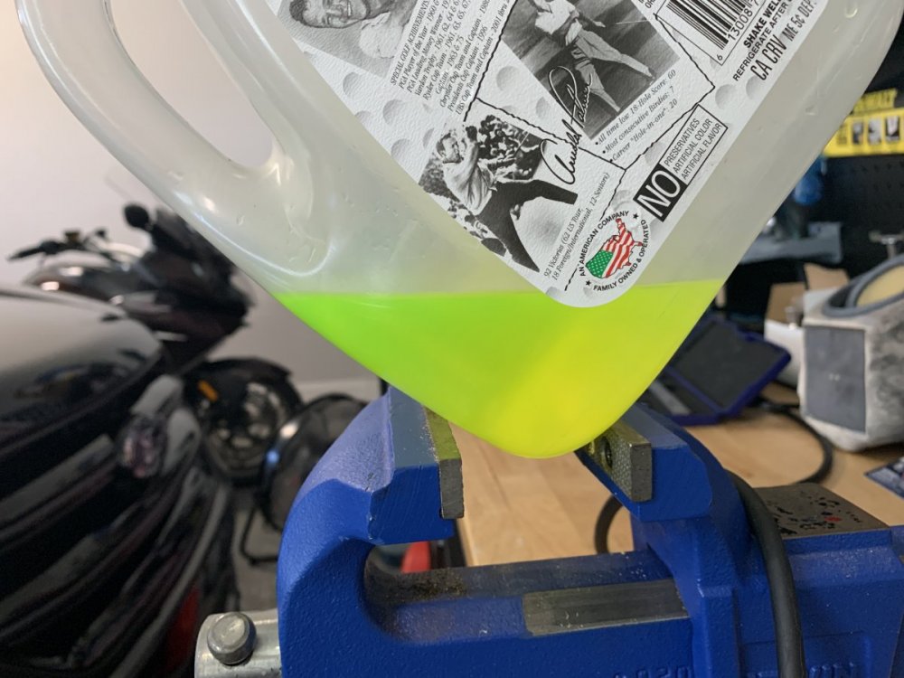

1004ron Posted October 23, 2020 Report Share Posted October 23, 2020 Quote Link to comment Share on other sites More sharing options...
