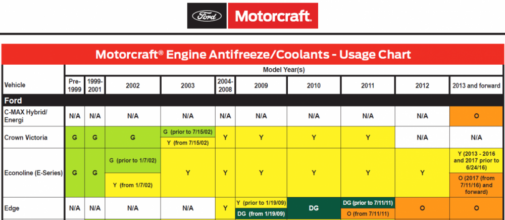

bubbadewsky Posted August 25, 2020 Report Share Posted August 25, 2020 I went to the dealership today for antifreeze for my 2014 Edge and they told me they just changed the recommended antifreeze to a new type green that is not the old green or yellow. Can this be verified Quote Link to comment Share on other sites More sharing options...
dolsen Posted August 25, 2020 Report Share Posted August 25, 2020 this is from 2016, so of course isn't current if there are new "best practices", but a good starting point nonetheless 1 Quote Link to comment Share on other sites More sharing options...

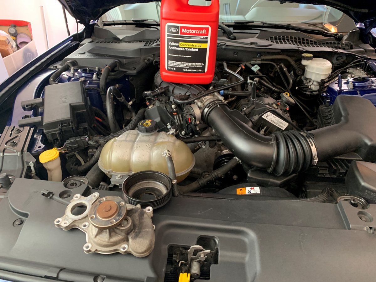

1004ron Posted August 25, 2020 Report Share Posted August 25, 2020 (edited) On 8/25/2020 at 11:04 AM, bubbadewsky said: I went to the dealership today for antifreeze for my 2014 Edge and they told me they just changed the recommended antifreeze to a new type green that is not the old green or yellow. Can this be verified That's correct. My wife's 2015 Mustang and my 2017 Sport used the Orange, and when I recently changed the water pump on the Mustang I found that Ford has changed the coolant spec to Yellow earlier this year. It looks more green than yellow. http://www.fcsdchemicalsandlubricants.com/quickref/FCSD%20Motorcraft%20Yellow%20Antifreeze-Coolant%20Backward%20Compatability.pdf Edited August 27, 2020 by 1004ron 3 Quote Link to comment Share on other sites More sharing options...
WWWPerfA_ZN0W Posted August 26, 2020 Report Share Posted August 26, 2020 Ford may allow mixing orange and yellow. Be a purist. If you are going to use yellow, flush out the orange first. Or switch to an aftermarket Orange, such as from Peak, Prestone, or Zerex. 1 Quote Link to comment Share on other sites More sharing options...
