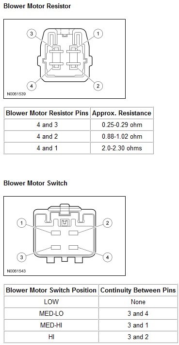

WWWPerfA_ZN0W Posted August 25, 2020 Report Share Posted August 25, 2020 (edited) when a resistor isn't working properly, the blower motor defaults to 4/high speed, basically what you saw with it connected directly to battery. but you said when reconnected, the motor responds to tapping? i don't see why it would do that if the motor is not faulty. are both the blower and resistor new or did you purchase them used? ford/motorcraft brand or something else? just to satisfy my curiousity test the blower motor switch for continuity if you have not already. 2010 Edge Blower Motor Inoperative or Does Not Work Correctly EMTC and DATC.pdf Edited August 25, 2020 by WWWPerfA_ZN0W 1 1 Quote Link to comment Share on other sites More sharing options...
Serg Posted August 25, 2020 Author Report Share Posted August 25, 2020 One of the blowers is from auto parts store not from Ford/motorcraft the other 2 are motorcraft one is the original she had first the other is from Ford. Yes they all still work when test connected straight to battery. As for the resistor I think it’s aftermarket not Ford. even when I have the blower connected under dash but isn’t screwed in place it runs like a 3 then I put it back in place and it starts up again for awhile then go back down to 1 then stops. I have not tested those parts. Whenever my sister has time I will test. As of now we’re getting prepared for Marco ? and get back results later. Thanks 1 Quote Link to comment Share on other sites More sharing options...

Serg Posted September 16, 2020 Author Report Share Posted September 16, 2020 After all the cleaning and such everything is all good. For the ac so i checked the blower motor resistance good and checked blower motor switch for continuity and it was bad. Switched it out for new switch and voila working perfect. After replacing several blower motors even with one from the dealership and also replacing the connector, the resistor and the ac heat control module still same problem the switch was the problem all the time. Yes that was the first thing i checked with the cabin filter. All is good now. Thanks everyone appreciate it very much. 1 Quote Link to comment Share on other sites More sharing options...
