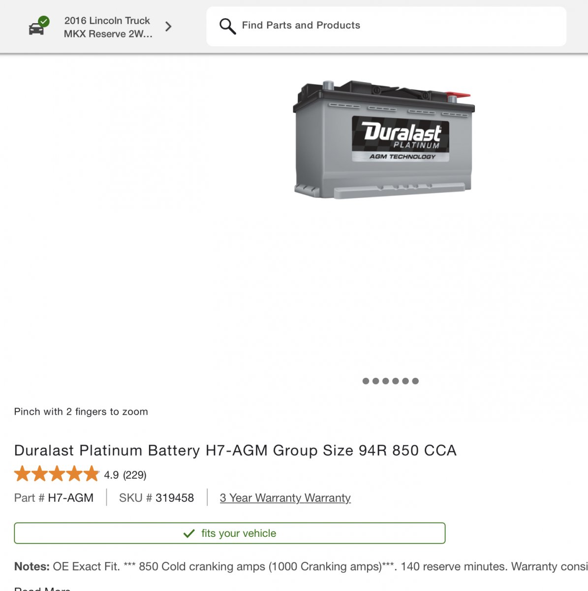

Chipster Posted August 13, 2020 Report Share Posted August 13, 2020 11 minutes ago, akirby said: I just changed the battery on our 2016 MKX (4.5 years - a record for us!). I didn’t do anything and everything works as before. Did not have to do anything. The battery was out for over 1 hour. That's good to know AK, what did you replace it with? (Brand & Group no.) It hear that two different sizes will fit. Looks like the longer battery might be more of a PIA. Quote Link to comment Share on other sites More sharing options...
handfiler Posted August 13, 2020 Report Share Posted August 13, 2020 (edited) 16 minutes ago, akirby said: I just changed the battery on our 2016 MKX (4.5 years - a record for us!). I didn’t do anything and everything works as before. Did not have to do anything. The battery was out for over 1 hour. I think it's hit and miss whether or not you lose the memory settings. Keeping the cables apart during the process definitely helps. Using a memory saver ensures you wont have any issues. Edited August 13, 2020 by handfiler Quote Link to comment Share on other sites More sharing options...
akirby Posted August 13, 2020 Report Share Posted August 13, 2020 2 hours ago, Chipster said: That's good to know AK, what did you replace it with? (Brand & Group no.) It hear that two different sizes will fit. Looks like the longer battery might be more of a PIA. 1 Quote Link to comment Share on other sites More sharing options...
