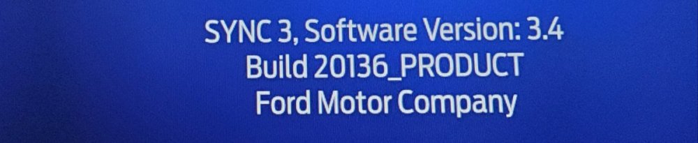

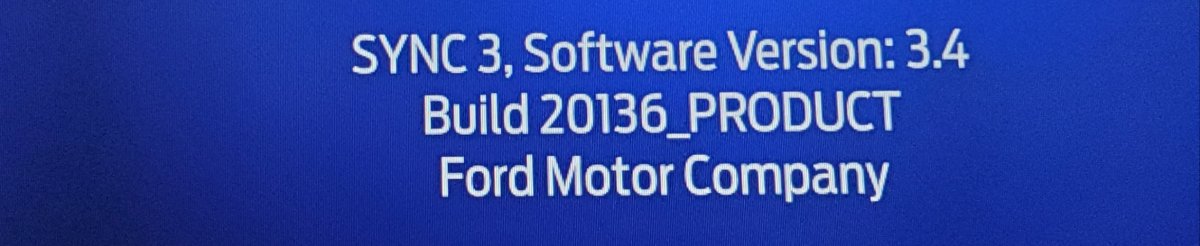

In the  SYNC INFO section of SYNC settings is your SYNC version  listed as SYNC V3.4.3 or SYNC V3.4.43  (as per the instructions.)  Mine says SYNC V3.4.3

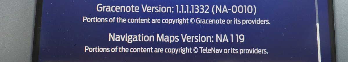

I have successfully installed V3.4.43 on saturday (I downloaded it before it was retracted. No bugs so far) and have downloaded the NA 119 maps to install this weekend. Will let you know if the Maps version gets updated. Currently showing NA117 although I had installed NA118 when it was made available.
I installed the maps update yesterday and it is showing NA 119 version
What version of SYNC is shown on that same screen that you show above?  Mine shows SYNC3, Software Version: 3.4 ( or V3.3.4).   I wonder what happen to the V3.4.43 that was mentioned in the instructions?
