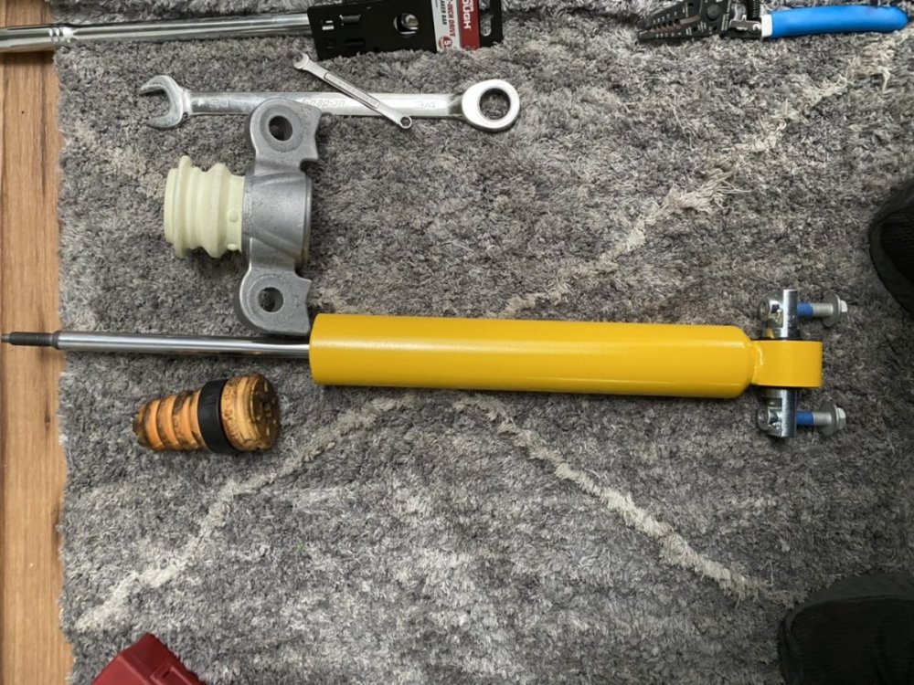

Gmandude Posted July 26, 2020 Report Share Posted July 26, 2020 The ford motorcade rear shocks tend to hit the bump stop to early for my taste. I ordered some bilstein b6. pn 24-283113. Bought a master pro fm1586 bump stop. Cut it out to fit the top butterfly aluminum price that mounts the top of the shocks. I cut the price to fit and had a master mechanic look at it before I put it on. Just polished the aluminum with a wire brush from Walmart the hart brand has nice ones for like 6 bucks. I had some combined covers for the shocks. Can post pics if wanted. 2 Quote Link to comment Share on other sites More sharing options...
Gmandude Posted July 26, 2020 Author Report Share Posted July 26, 2020 (edited) Also strongly suggest buying new bottom bolts the ford dealership only wanted $2.50 per bolt with the dry loctite I have done other suspension mods if anyone is interested Edited July 26, 2020 by Gmandude Quote Link to comment Share on other sites More sharing options...
Special_K Posted July 27, 2020 Report Share Posted July 27, 2020 On 7/25/2020 at 10:29 PM, Gmandude said: The ford motorcade rear shocks tend to hit the bump stop to early for my taste. I ordered some bilstein b6. pn 24-283113. Bought a master pro fm1586 bump stop. Cut it out to fit the top butterfly aluminum price that mounts the top of the shocks. I cut the price to fit and had a master mechanic look at it before I put it on. Just polished the aluminum with a wire brush from Walmart the hart brand has nice ones for like 6 bucks. I had some combined covers for the shocks. Can post pics if wanted. so im currently working with bilstein to get B6 options for the front of the car too so we can balance it out. how did the B6's work for you just being in the rear? 3 Quote Link to comment Share on other sites More sharing options...
Gmandude Posted July 29, 2020 Author Report Share Posted July 29, 2020 It’s been really nice. I have about 60k so they needed replacement anyways. I have only driven maybe 10 miles with them but only seem to loose grip in the front in heavy corners. I changed the bump stop height too. The cars stance seems a little higher in the back but when I do the front it should even out l. They have some on rock auto for my 15 but it looks more complicated and I don’t have a lift or garage haha ? 2 Quote Link to comment Share on other sites More sharing options...

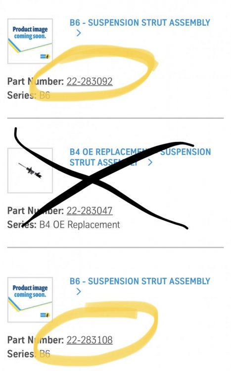

onyxbfly Posted August 1, 2020 Report Share Posted August 1, 2020 13 minutes ago, Gmandude said: I bought some last night based off there catalog they don’t really stock them most places was hard to find both. Will report when they get here and installed. What did you buy exactly? Quote Link to comment Share on other sites More sharing options...
Gmandude Posted August 2, 2020 Author Report Share Posted August 2, 2020 7 hours ago, onyxbfly said: What did you buy exactly? 2 1 Quote Link to comment Share on other sites More sharing options...
Gmandude Posted August 2, 2020 Author Report Share Posted August 2, 2020 2 Quote Link to comment Share on other sites More sharing options...
Xtra Posted August 2, 2020 Report Share Posted August 2, 2020 (edited) On 7/27/2020 at 12:20 PM, Special_K said: so im currently working with bilstein to get B6 options for the front of the car too so we can balance it out. how did the B6's work for you just being in the rear? Bilstein lists B6 front struts for the Edge now, part # 22-283108 for the Right front, and 22-283092 for the Left Front. Is this what you are referring to? The rears are listed as part # 24-283113 - Rear 4600 Heavy Duty B6. Bilstein states these are the same shocks and struts that are used in NASCAR Super Trucks, SCORE, and Pro-Truck competitions. Am I missing something here? Edited August 2, 2020 by Xtra 2 Quote Link to comment Share on other sites More sharing options...
onyxbfly Posted August 2, 2020 Report Share Posted August 2, 2020 4 hours ago, Xtra said: Bilstein lists B6 front struts for the Edge now, part # 22-283108 for the Right front, and 22-283092 for the Left Front. Is this what you are referring to? The rears are listed as part # 24-283113 - Rear 4600 Heavy Duty B6. Bilstein states these are the same shocks and struts that are used in NASCAR Super Trucks, SCORE, and Pro-Truck competitions. Am I missing something here? Spoke with Special K earlier today, those are the correct part numbers for the Bilsteins that he and his dad developed. 2 Quote Link to comment Share on other sites More sharing options...
