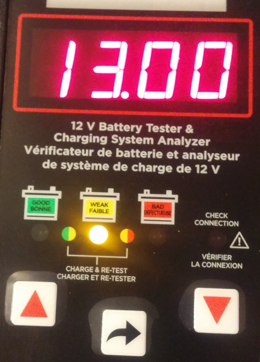

That thing that goes on and off (clutch?) is where I think I have a problem: when it's cycling it gets harder to turn/run and longer to run/complete the cycle.  I first noticed it when being idle I saw the rpm gauge in the cluster panel going down to almost 0.5 x 1000 rpm, which it's not bad EXCEPT that I actually noticed/felt it because the car was making some trembles as if it's going to suddenly stop (it has never stopped btw).  A couple of times I've connected one of those BA7 battery testers and measured the current (battery voltage) while the compressor was on (I actually made a video the second time I measured it but I don't think I can posted here; please let me know if I can send it to you, or anyone else interested, somehow).  Anyway, this second time, when I started measuring the voltage, the BA7 was oscillating picking up to 14.29 volts when the clutch (?) was not running and picking down to 12.09 after the clutch was engaged cycling on.  I couldn't capture those exact pick readings but you can get the idea.
Also, I can see the BA7 displaying the green/good battery when the clutch was not on and the changing to yellow/weak battery when the clutch was engaged in the cycle.  I'm going to try to post pictures of that (not sure how many pictures I can upload in a single post).
