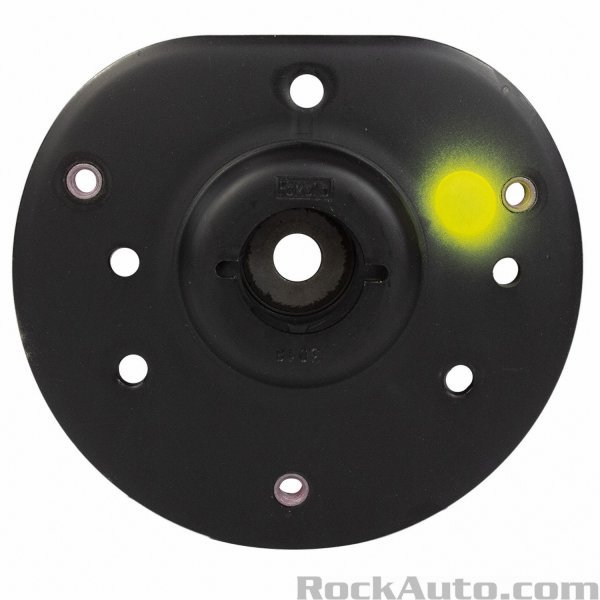

shumax Posted July 18, 2020 Author Report Share Posted July 18, 2020 Can anyone tell me how to orient the new mount? That yellow dot means something - it's been a while since I've done these. I know that means something; just can't remember what/where that needs to line up. Also, anyone have suggestions on a spring compressor other than the ones you can use from AutoZone? Those babies are scary... Thanks again, Shumax Quote Link to comment Share on other sites More sharing options...
