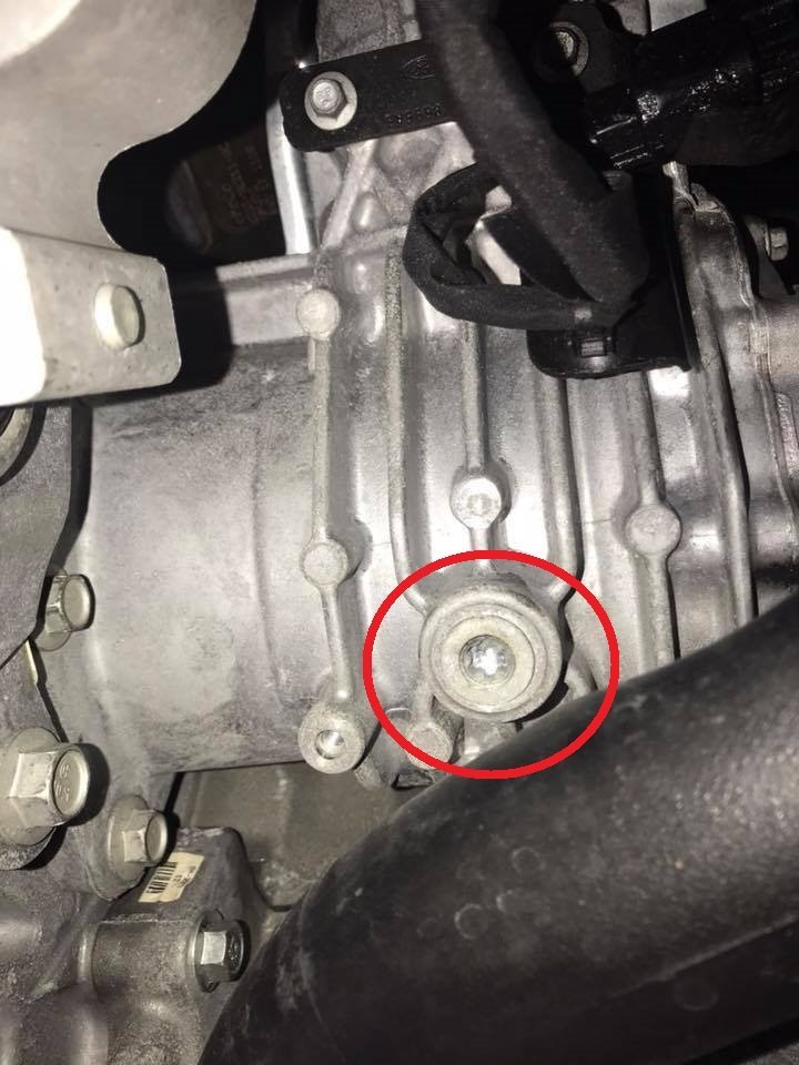

my2k2zx2 Posted July 11, 2020 Report Share Posted July 11, 2020 I'm planning on changing the PTU fluid. What I'm seeing doesn't look like anything I've seen on other Edge PTU. The ones that I've seen had the fill and drain on the same side. I think mine has the fill on the side and the drain on the bottom and both appear to need a T50 to remove. Would that be the correct fill & drain plugs? Quote Link to comment Share on other sites More sharing options...
WWWPerfA_ZN0W Posted July 12, 2020 Report Share Posted July 12, 2020 I don't have a pic of the fill plug, but it seems you have identified them correctly, as a t50 is required to remove them. May be a struggle to remove the drain plug with the intake tubing in place, so be prepared to remove that tube first. Plus you don't want to make a mess if the fluid splatters all over the tube etc. Pic of drain plug: Quote Link to comment Share on other sites More sharing options...
my2k2zx2 Posted July 12, 2020 Author Report Share Posted July 12, 2020 (edited) Yeah, I think that's what I'm looking at for the drain. How easy is it to remove the intake tube? Or would it be enough to cover things with foil while I'm doing the drain/refill? https://imgur.com/GEndJjW Edited July 12, 2020 by my2k2zx2 Quote Link to comment Share on other sites More sharing options...
