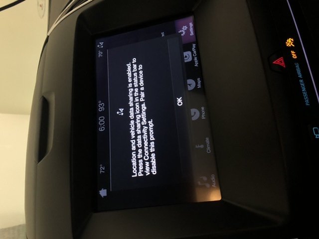

Itsdjellz Posted July 7, 2020 Report Share Posted July 7, 2020 Is there any easy to get rid of this during startup? Quote Link to comment Share on other sites More sharing options...
Itsdjellz Posted July 7, 2020 Author Report Share Posted July 7, 2020 I'm not sure why the picture uploaded sideways because I uploaded it the right way Quote Link to comment Share on other sites More sharing options...
basment Posted July 7, 2020 Report Share Posted July 7, 2020 Mine does that if a phone is not connected. Quote Link to comment Share on other sites More sharing options...
DaMiFo Posted July 7, 2020 Report Share Posted July 7, 2020 The system will show that popup when you allow SYNC to track/share your vehicle data and location, but it does not see a phone connected to the system via bluetooth. Either have a paired phone with you when you start the car, or disabled the sharing services (such as being able to track & see vehicle info from FordPass). Quote Link to comment Share on other sites More sharing options...
