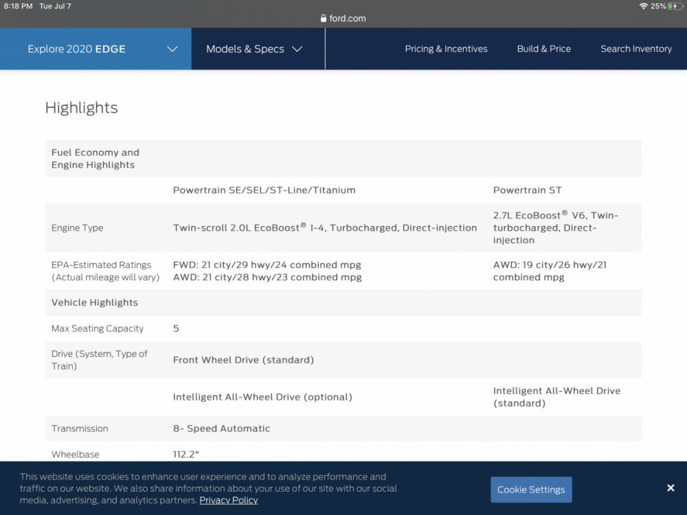

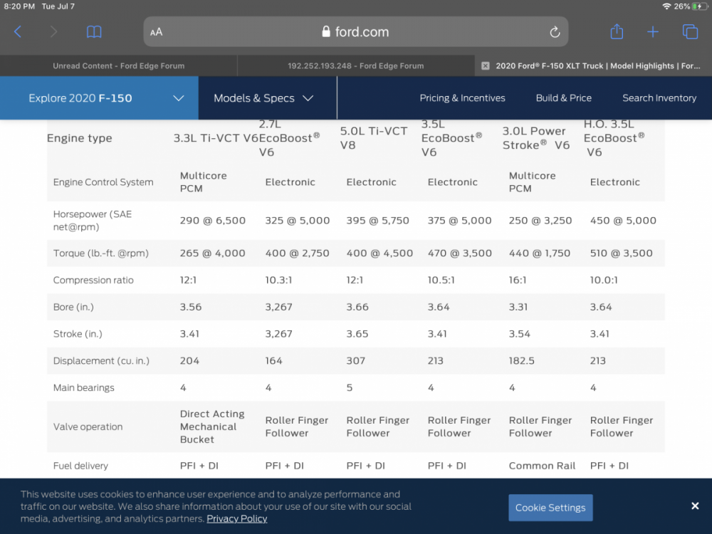

omar302 Posted July 7, 2020 Report Share Posted July 7, 2020 (edited) As @onyxbfly stated above, the Edge still uses Direct Injection only. The F-150 got dual injection in 2017 for the 3.5 EcoBoost only, then in 2018 the rest also got it. But all other EcoBoost Engines (AFAIK, and as per Ford's website as of today 07/07/2020) are still Direct Injection only, even the new Explorer, which was a clean new 2020 model & the first application of the 3.0 EcoBoost in longitudinal form. Edit: The 2018+ Expedition is also PFI+DI like the F-150, although Ford's website states its only DI. So there goes relying on Ford as a credible source ?. Edited July 7, 2020 by omar302 2 Quote Link to comment Share on other sites More sharing options...

akirby Posted July 7, 2020 Report Share Posted July 7, 2020 24 minutes ago, THE_BOLT said: I'm sorry...as of 2018 all ford EcoBoost engines have dual injection. They call something else like dual fuel Im sorry but that’s incorrect. Only the 1.5L dragon (3 cylinder) and the 2nd gen 2.7 and 3.5 in RWD applications get dual injection. All the rest including 2.0, 2.3, transverse 2.7 and 3.0 are direct injection. Quote Link to comment Share on other sites More sharing options...
akirby Posted July 7, 2020 Report Share Posted July 7, 2020 1 minute ago, THE_BOLT said: Seriously the only difference between the 2.7 engine in the F-150 and Edge is intake manifold, throttle body, exhaust manifold and intake tubing...oil pump drive possibly too. Which goes for all the engines! The blocks and heads are drilled and tapped with the same oil galleys, injector holes and so on...unless you have the H.O. EcoBoost engine like in the Raptor. The only reason that everything you read says its for the F-150 is because that's Fords bread n butter. Wrong. Edge and Nautilus get the first gen 2.7 with direct injection only. F150 gets the 2nd gen 2.7L with dual injection. https://en.wikipedia.org/wiki/Ford_EcoBoost_engine Quote Link to comment Share on other sites More sharing options...

akirby Posted July 8, 2020 Report Share Posted July 8, 2020 59 minutes ago, THE_BOLT said: How do you argue that with someone who builds them How do build them and not know the difference? Edge ST is DI only. F150 is DI and PI. Even Ford says so. 2 Quote Link to comment Share on other sites More sharing options...
dajo2012 Posted July 8, 2020 Report Share Posted July 8, 2020 1 hour ago, THE_BOLT said: How do you argue that with someone who builds them Because I have actually looked at mine there is not any extra injectors. Just the original DI injectors (6). Quote Link to comment Share on other sites More sharing options...
