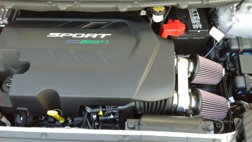

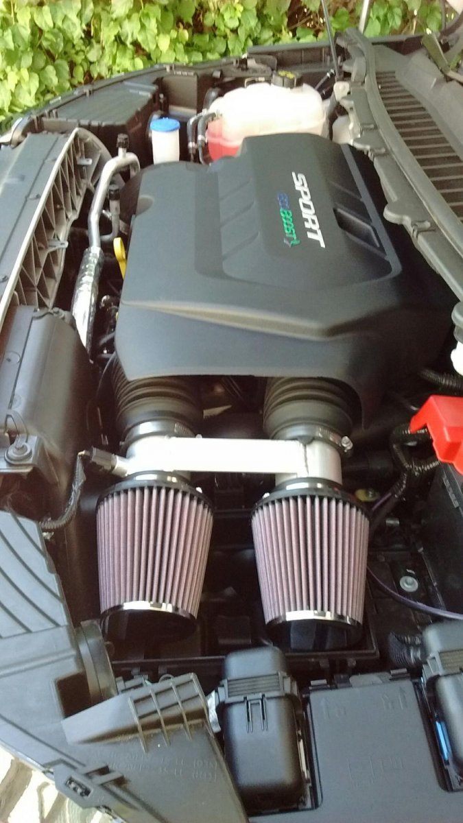

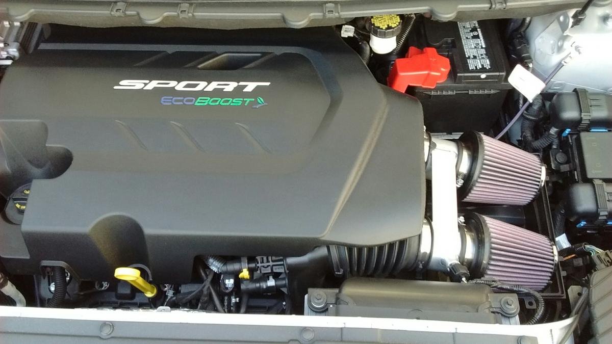

tyyrael Posted June 13, 2020 Report Share Posted June 13, 2020 Been skimming through the articles and I'm still struggling to accept that the Edge Sport 2.7 still doesn't have any support for aftermarket intake systems. I know there are a lot of reasons and the engine bay heat issue and so forth and so forth. Today I stumbled across something that looks like it might fit, but I'm not going to pull the trigger on something this expensive without knowing first. The Cobb Tuning cold air intake system for the 3.5 Ecoboost F150 looks like it has the same size box that would attach to the top of the Edge Sport airbox, but I'm not finding any information that would suggest it is the same airbox. (see the pics below) The second intake I found was from an image search I was doing for the "dual inlet air filters". This looks like a solid way to construct a good intake (but I have never fabricated a box for one) (last picture) Anyway, I just wanted to touch base with the forum and see if anyone else has had any luck building a cool intake system that works and to also find out if anyone would just happen to know if the Cobb box intake in the pictures would fit on top of the factory bottom portion of the Edge Sport box. If it did, then the only change would be two shorter pipes. Quote Link to comment Share on other sites More sharing options...

Xtra Posted June 14, 2020 Report Share Posted June 14, 2020 (edited) tyyrael , I built this years ago and It was a big fail !! The underhood temps of the 2.7EB Edge are so extreme that it actually took power away. When everything is cold upon startup it works great, as soon as the car gets up to temp and everything gets heat soaked power drops way off and warning lights come on. Snmjin and I both have answers to the CAI problem, but getting these items into production is difficult. Edited June 14, 2020 by Xtra 2 Quote Link to comment Share on other sites More sharing options...

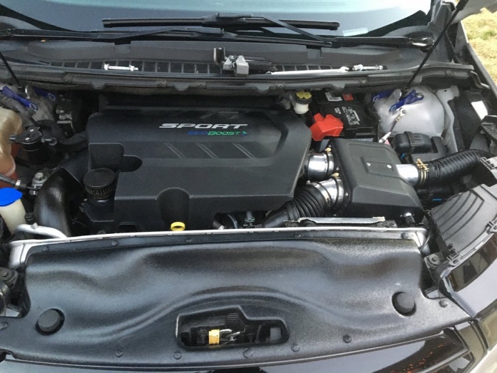

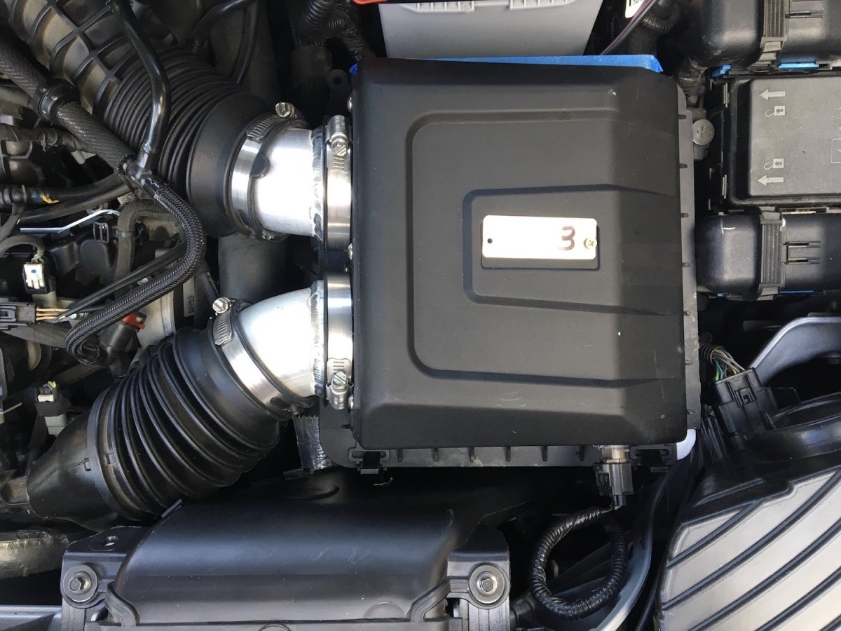

Xtra Posted September 17, 2022 Report Share Posted September 17, 2022 (edited) Have created the V3 Cold Air Intake for the Edge ST , Edge Sport and the Lincoln Nautilus with the 2.7EB. Available with or with out an Auxiliary Air Intake that removes any snorkel restrictions while providing cool clean air to the engine. The standard V3 CAI installed in a 2016 Edge Sport The V3 Cold Air Intake with the optional Aux Air Intake This is the complete Cold Air Intake V2, V3 system with the V2 Ram Air in the foreground. To order PM me. You must be a forum member to order. For more info on the V3 go here : For more info on the V2 Ram Air go here. Edited September 17, 2022 by Xtra Quote Link to comment Share on other sites More sharing options...

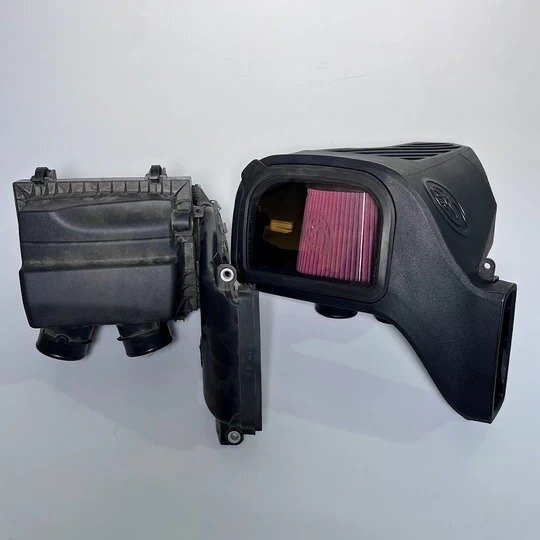

dnr924 Posted January 29 Report Share Posted January 29 COLD AIR INTAKE FOR 2015-2018 EDGE SPORT & 2019-2024 FORD EDGE ST – S&B They make a nice box and filter system for the Ford Edge Sport 2.7. Quote Link to comment Share on other sites More sharing options...
