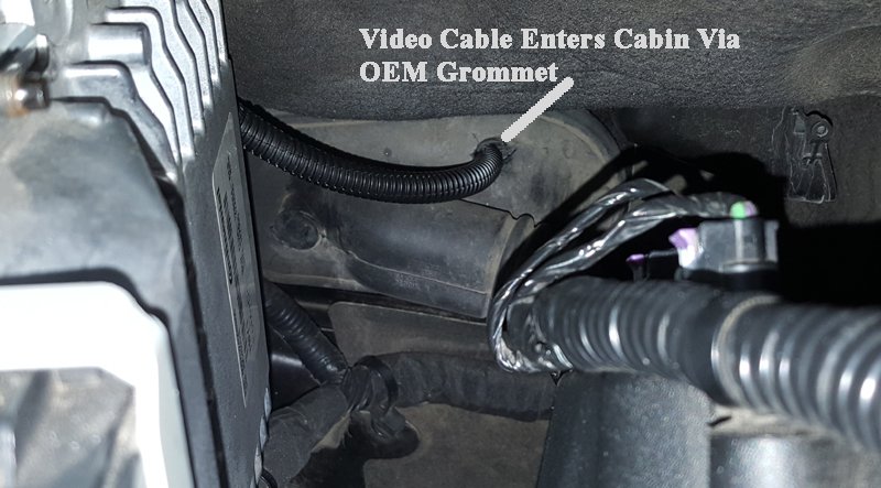

Fredj72 Posted May 18, 2020 Report Share Posted May 18, 2020 First, I hope posted this in the right place.I'm trying to run wiring for underglow on my sel through the firewall. I can't seem to find any where besides the wiring for the harness. Any help would be greatly appreciated. Quote Link to comment Share on other sites More sharing options...
Gadgetjq Posted May 18, 2020 Report Share Posted May 18, 2020 On 5/18/2020 at 12:44 AM, Fredj72 said: First, I hope posted this in the right place.I'm trying to run wiring for underglow on my sel through the firewall. I can't seem to find any where besides the wiring for the harness. Any help would be greatly appreciated. Expand Hi Fred, You're on the right track. There are two grommets in the firewall. One is below the battery holder (battery has to come out to find it) the other is on the passenger side and is the one I used to run my front camera wiring (see pic). If you look closely you'll see a circle molded into the grommet. That can be the path for your underglow wiring. To get through it I pulled the grommet away from the firewall enough to get a finger behind it in the area of that circle and confirm there was no factory wiring in that spot. Then I used a sharp blade to carve out the circle. The grommet under the battery might have the same design, I never looked. Quote Link to comment Share on other sites More sharing options...

Fredj72 Posted June 15, 2020 Author Report Share Posted June 15, 2020 Where is the entrance through the cabin? Is it behind the glove box? I'm looking at what looks like a compressor under the airbag? Idk lol. Help please. Quote Link to comment Share on other sites More sharing options...
Gadgetjq Posted June 15, 2020 Report Share Posted June 15, 2020 (edited) Yes, using the grommet shown above your wire will enter the cabin 'behind' the heater box. The best way to reach it is to lower the glove box lid then reach through that opening to find the wire you've pushed in from the engine compartment. Edited June 15, 2020 by Gadgetjq Quote Link to comment Share on other sites More sharing options...
Brockdog12 Posted July 5, 2023 Report Share Posted July 5, 2023 I've tried the passenger side grommet and am hitting something with my wire feed after making a small hole, doesn't appear trying any direction makes a difference. Should be simple enough, but no success. Thanks! Quote Link to comment Share on other sites More sharing options...
