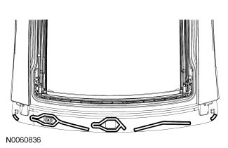

Refer to the urethane adhesive path illustration and begin cutting at the center of the front trim panel and work through towards the opposite corners.

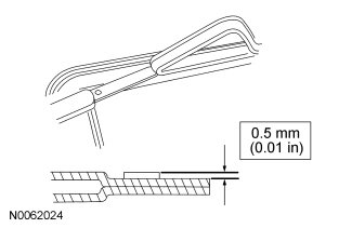

               Using an appropriate tool, trim the urethane adhesive and pads leaving no more than 0.5 mm (0.01 in) base of original equipment urethane along the roof opening module surface.
