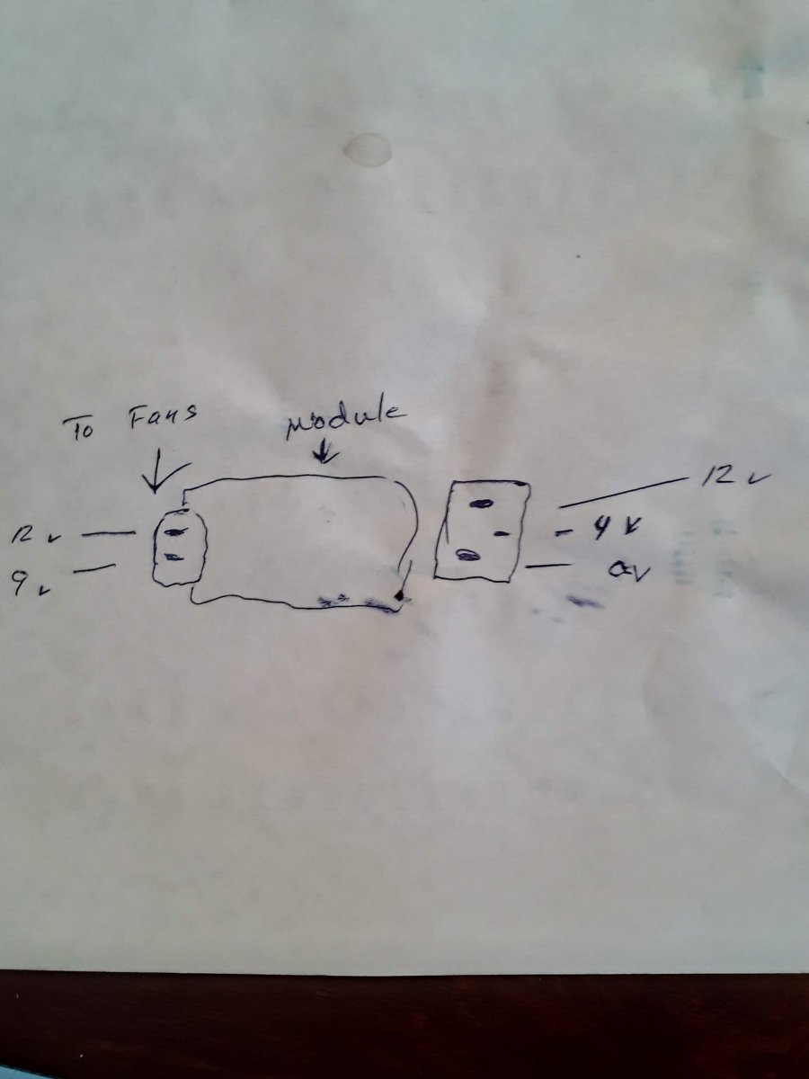

sixpack.sid Posted April 18, 2020 Report Share Posted April 18, 2020 Hi! I have an 09 Edge that is overheating. The fans are not working. When I turn on the AC, I get nothing. I drew a diagram, see below. I checked the voltage. I'm getting both positive volts out to the fans, when I think there should be a ground to it. Is it possible it's the module? Even with the key off, it's showing the same except the plug with 4v shows 0v. I did take a jumper wire from battery to the fans and both fans work. What am I missing? Any help would be greatly appreciated! Quote Link to comment Share on other sites More sharing options...

sixpack.sid Posted April 19, 2020 Author Report Share Posted April 19, 2020 Ok, thanks for the reply. I did turn on the AC and the fans did not come on. But when I jumped it to the battery, both fans did work. Quote Link to comment Share on other sites More sharing options...
