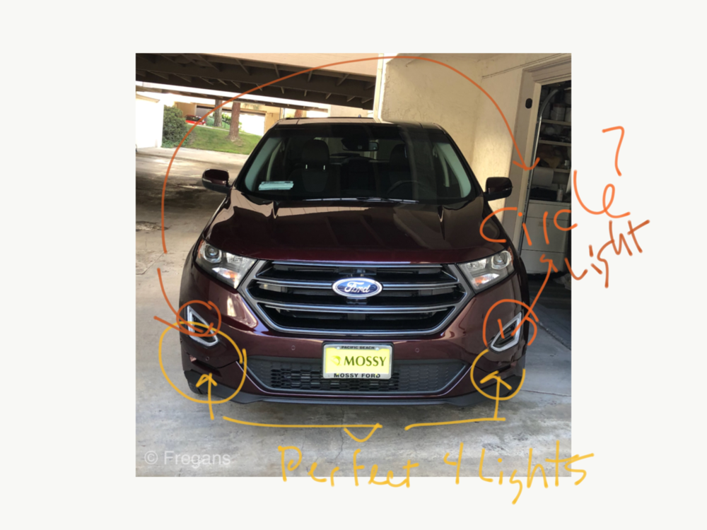

UrbanFree Posted April 16, 2020 Report Share Posted April 16, 2020 Has anyone been able to get lights in here? If so any recommendations? thanks Quote Link to comment Share on other sites More sharing options...
Gadgetjq Posted April 17, 2020 Report Share Posted April 17, 2020 Hi UF, The area you have marked "circle lights" won't work for a North American Edge but would for the European version. The difference is the bumper 'behind' the bumper cover. For the North American version it's wider and will interfere with anything you'd want to install in that space. Those lower areas though it's a big maybe. You'd probably have to take the front cover off and mount lights to a custom made bracket. Otherwise you'd just be attaching the light to plastic and it wouldn't last long. Here's an 'example' (not a recommendation) for a design you might consider for that space: https://amzn.to/3cpPknV . Shop around, there are vast differences in quality available. Essentially, you'll get what you pay for. Quote Link to comment Share on other sites More sharing options...
soUNTOUCHABLE Posted May 6, 2020 Report Share Posted May 6, 2020 (edited) I've been thinking alot about that area youve circled, not the signature lights, but the little indents in the bumper. Something small, like a 6x1.5" light bar would fit there. It would take some significant fab skills. I'm still rolling the execution around but IF i decide to give it a shot, I'd go with something like one of these: or even better, some of these: My bumper is different than yours though, since mine is a Ti and yours is a Sport. The spaces appear to be pretty close to the same size, but impossible to know for sure without a direct comparison. I've been thinking of doing either those small gaps on the front sides of the bumper or the long thin strip in the center. Haven't decided yet. Edited May 6, 2020 by soUNTOUCHABLE Quote Link to comment Share on other sites More sharing options...
Nick Halstead Posted May 7, 2020 Report Share Posted May 7, 2020 a member here has put lights in those 2 lil spots. you will not get a lot of usable light out of the area though. Quote Link to comment Share on other sites More sharing options...
