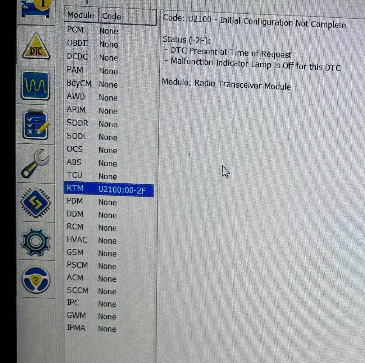

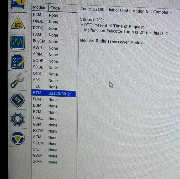

Wubster100 Posted April 20, 2024 Report Share Posted April 20, 2024 I got my new 900mhz RTM and key fob. I remove the old 300mhz RTM and replaced it with the new 900mhz RTM. As expected, my old 300mhz key fob only works in the emergency slot, and I lost TPMS. I got a DTC: RTM U2100:00-2F Initial Configuration Not Complete. I went to the AsBuilt Configuration for the RTM and I loaded factory data from the internet. Then I did the module reset for the RTM. The DTC still remained. I did the tire pressure monitoring system train, and I was asked to retrain the front left tire. I don’t have the TPMS learning tool so I let about 6psi out of the tire instead. It didn’t seem to do anything so I just aborted the TPMS procedure. I took a drive and about a minute later my tire pressures started to pop up in the IPC because they automatically learned. I have tried to do the RTM module reset multiple times but the DTC still remains. Maybe I have to plug in my 300mhz RTM and save the AsBuilt data and write it to the new 900mhz RTM?? I only have one 300mhz key, and I haven’t programmed any 900mhz keys yet. Quote Link to comment Share on other sites More sharing options...
Wubster100 Posted April 20, 2024 Report Share Posted April 20, 2024 11 hours ago, Wubster100 said: Maybe I have to plug in my 300mhz RTM and save the AsBuilt data and write it to the new 900mhz RTM?? I removed the new 900mhz RTM and installed the 300mhz RTM. The DTC went away. I saved the AsBuilt data file to my computer. I installed the 900mhz RTM again and I wrote the AsBuilt file that I just saved to it. It said no data to write, but I just did the force write anyway and the DTC disappeared. I did the RTM module reboot and TPMS relearn mode. I went for a short drive and the tire pressures are working again with the 900mhz RTM. Now all I need to do is get a locksmith to program my 900mhz key. 2 Quote Link to comment Share on other sites More sharing options...
