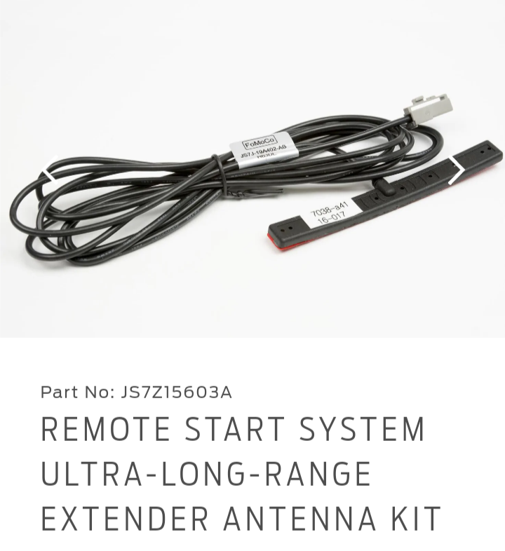

spartaman10 Posted December 15, 2022 Report Share Posted December 15, 2022 Hello to all, Has anyone installed the extended range antenna on this factory setup ? I can't find the alarm/ remote start unit in my car or where this will plug into. It's suppose to mount via 3M tape under the rear view mirror, go down the driver's side pillar "into the IP" and connect to VSS. I have a 2018 Titanium 301A. Thank you all very very much! Quote Link to comment Share on other sites More sharing options...

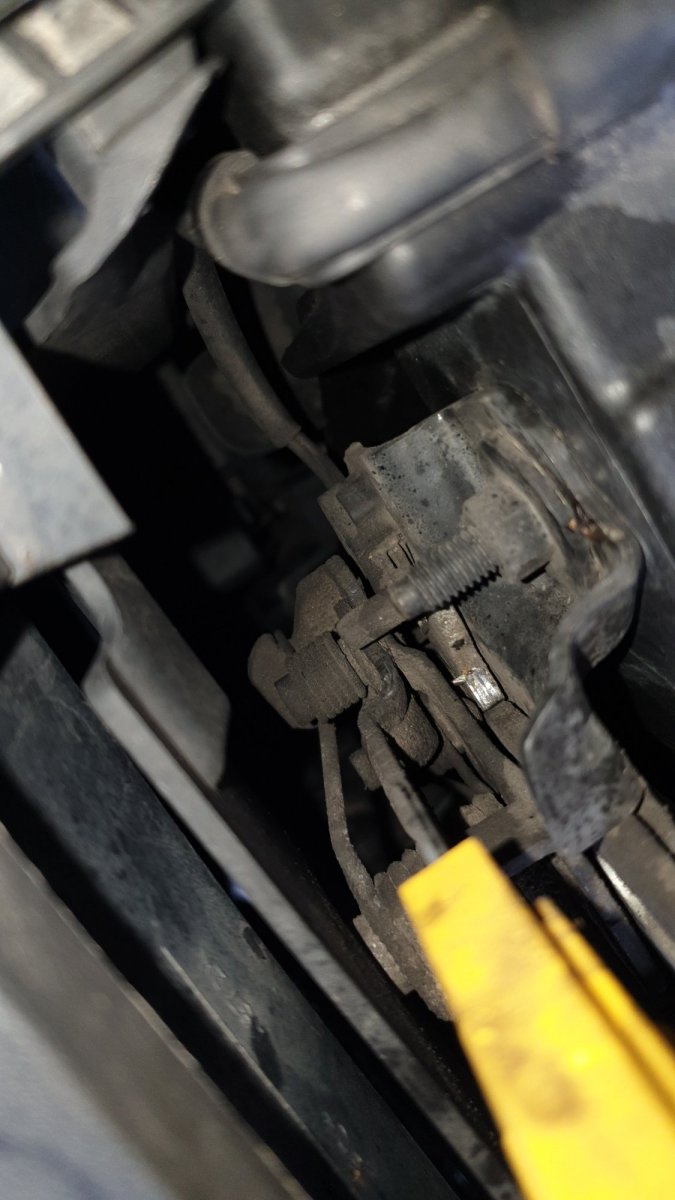

wone Posted November 30, 2023 Report Share Posted November 30, 2023 I have exactly the same problem where everything is programmed, through Forscan everything allowed, but the car only buds and flashes lights. I don't see any Horn Honk and Light item in Bdycm. Will you advise me where to find her? Where can I find a hood latch switch? I have the same problem that the car only buds and flashes. Thank you Quote Link to comment Share on other sites More sharing options...
omar302 Posted December 1, 2023 Report Share Posted December 1, 2023 (edited) 7 hours ago, wone said: I have exactly the same problem where everything is programmed, through Forscan everything allowed, but the car only buds and flashes lights. I don't see any Horn Honk and Light item in Bdycm. Will you advise me where to find her? Where can I find a hood latch switch? I have the same problem that the car only buds and flashes. Thank you Did you follow all the steps mentioned in the original post? Did you replace the RTM? Did you enable Hood Switch in BCM? Did you enable remote start in FCIM & SCCM? Note: your Edge is a EU model, that could also be an issue. It is diesel, right? Auto or Manual? That could also be an issue. Edited December 1, 2023 by omar302 Quote Link to comment Share on other sites More sharing options...
papinist Posted December 1, 2023 Report Share Posted December 1, 2023 6 hours ago, omar302 said: Note: your Edge is a EU model, that could also be an issue. This is the reason why he can't get it enabled. We already have the hood latch switch installed, it only needs to be enabled.. but neither after enabling all things nor with external hardware (can't remember the name of what I tried) we can have the remote start. Quote Link to comment Share on other sites More sharing options...
wone Posted December 1, 2023 Report Share Posted December 1, 2023 1 hour ago, papinist said: This is the reason why he can't get it enabled. We already have the hood latch switch installed, it only needs to be enabled.. but neither after enabling all things nor with external hardware (can't remember the name of what I tried) we can have the remote start. I also have the EU version, slot machine and everything is allowed, but unfortunately nothing. I still have to check the switch, but it just won't work. It is surprising that another person on the Czech forum with the same version as I have without a problem launched and it is going. Then I don't know Quote Link to comment Share on other sites More sharing options...
wone Posted December 1, 2023 Report Share Posted December 1, 2023 That's how I have it. Some wires lead to it, so the sensor is apparently connected there. Unfortunately, it doesn't work anyway, except that the sensor does not work. Quote Link to comment Share on other sites More sharing options...
