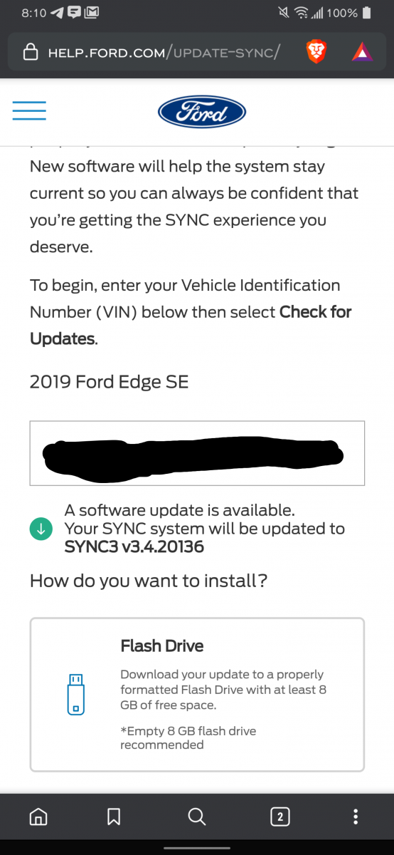

IcyFridge Posted October 6, 2020 Report Share Posted October 6, 2020 (edited) I have the base 4" version. When I put in my VIN on Ford's site, it says sync 3.4 update is available. Not sure if there's a separate update or if the 3.4 file works with mine too? Mine says it currently has the sync 3.3 on it. Odd... Edited October 6, 2020 by IcyFridge Quote Link to comment Share on other sites More sharing options...

IcyFridge Posted October 7, 2020 Report Share Posted October 7, 2020 18 minutes ago, DaMiFo said: Yes, the systems with the 4" screen are completely different versions of SYNC compared to SYNC 3. So it still would use the Sync3 3.4 update? right now it says I have the SYNC3 3.3.#### firmware. Quote Link to comment Share on other sites More sharing options...
jmr061 Posted October 7, 2020 Report Share Posted October 7, 2020 3 hours ago, IcyFridge said: So it still would use the Sync3 3.4 update? right now it says I have the SYNC3 3.3.#### firmware. Use the proper update supplied by Ford through the Ford SYNC update site. Quote Link to comment Share on other sites More sharing options...
IcyFridge Posted October 7, 2020 Report Share Posted October 7, 2020 7 hours ago, jmr061 said: Use the proper update supplied by Ford through the Ford SYNC update site. That's what I'm using and that's why I'm asking here. Here's a screenshot. That's why Im asking if it is designed to work with the 4.2" screen? My 4.2" screen says it has SYNC3 3.3.### right now. Quote Link to comment Share on other sites More sharing options...
jmr061 Posted October 7, 2020 Report Share Posted October 7, 2020 2 hours ago, IcyFridge said: That's what I'm using and that's why I'm asking here. Here's a screenshot. That's why Im asking if it is designed to work with the 4.2" screen? My 4.2" screen says it has SYNC3 3.3.### right now. Install it, that is the update meant for your vehicle. Your vehicle has what Ford refers to as SYNC3 Lite. Quote Link to comment Share on other sites More sharing options...
IcyFridge Posted October 7, 2020 Report Share Posted October 7, 2020 44 minutes ago, jmr061 said: Install it, that is the update meant for your vehicle. Your vehicle has what Ford refers to as SYNC3 Lite. Perfect answer. That clarifies so much!!! Never knew there was a Sync 3 lite. Quote Link to comment Share on other sites More sharing options...
DaMiFo Posted October 7, 2020 Report Share Posted October 7, 2020 (edited) 20 hours ago, IcyFridge said: So it still would use the Sync3 3.4 update? right now it says I have the SYNC3 3.3.#### firmware. Yes, it's version 3.4 of "SYNC with MyFord" (see comparison here). When you see people talk about SYNC 3 ver 3.3 or 3.4, that's referring to the 8" screens. Your newest version of "SYNC with MyFord" just happens to the same version number as SYNC 3 v3.4. As IcyFridge said, if you enter your VIN with Ford (as you have), just install the file they give you, it's the correct one. If for some reason you download the wrong version from a forum or something, it will give you an error message and it won't install - so that's not something you have to worry about accidentally doing. Edited October 7, 2020 by DaMiFo Quote Link to comment Share on other sites More sharing options...
