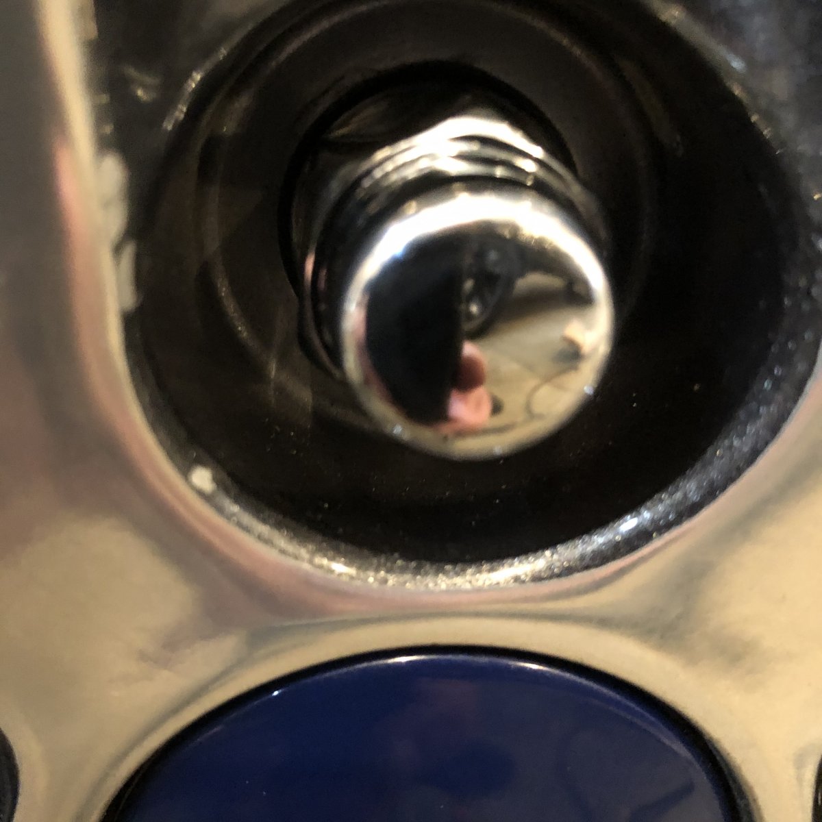

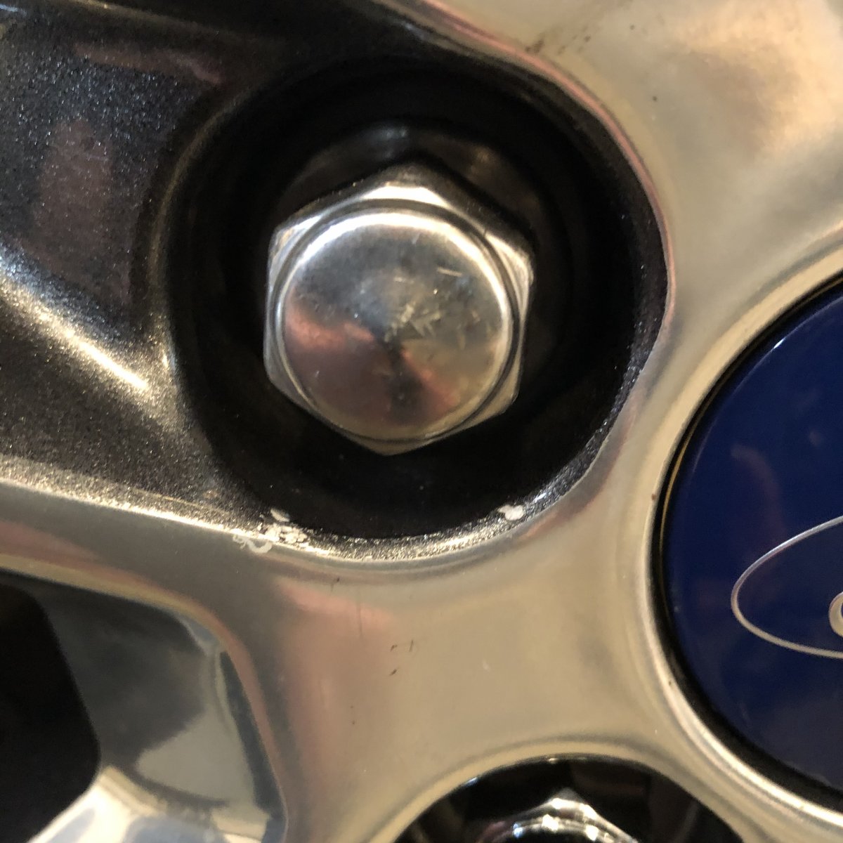

shumax Posted April 5, 2020 Report Share Posted April 5, 2020 (edited) The lug nuts on my 2016 Sport have swollen and need to be replaced. Not wanting to deal with it again, I did NOT buy the Motorcraft lug nuts. Instead, I got these on Amazon: https://www.amazon.com/DPAccessories-D3718-2305-20-Chrome-14x1-5/dp/B00I82CIAM/ref=au_as_r?_encoding=UTF8&Make=Ford%7C54&Model=Edge%7C5858&Year=2016%7C2016&ie=UTF8&n=15684181&newVehicle=1&s=automotive&vehicleId=1&vehicleType=automotive Nice quality and look sharp. My concern? I bolted them up and they thread right up, but they don't have as "fat" an end as the OEM ones. The taper seems shorter on these compared to OEM. They tightened right up and seem to fit flush. I'm just concerned they don't fit right as they aren't overlapping the edge of the lug hole on the rim as much as the OEM versions. Given my wife and kids are in this car, I want to be 200% sure. Can you experts put an eye ball on this and provide feedback? The OEM nut is the top photo. See how the taper flares out to the sides, just a bit? Next photo are the replacements - note, no flare to them. Perhaps that doesn't matter? The taper of the new lug nuts seats in that hole well enough and doesn't seem like the lug hole could go over the lug. Perhaps I'm fine? Thanks, Shumax Edited April 5, 2020 by shumax Quote Link to comment Share on other sites More sharing options...

ezndo Posted April 7, 2020 Report Share Posted April 7, 2020 Just replaced the lug nuts on my 2016 Sport, 21”wheel w/Gorilla black lugs p/n 61147BCX. I contacted Gorilla and these were recommended by them. CJ Pony Parts had the best price. Quote Link to comment Share on other sites More sharing options...
shumax Posted April 7, 2020 Author Report Share Posted April 7, 2020 Can u post a photo of them in the lug hole as I did above? Would really appreciate it - thanks! Quote Link to comment Share on other sites More sharing options...
ezndo Posted April 7, 2020 Report Share Posted April 7, 2020 Black makes it difficult to see... Quote Link to comment Share on other sites More sharing options...
shumax Posted April 7, 2020 Author Report Share Posted April 7, 2020 Hey, thanks so much for doing that! Yours appear to seat in the lug hole like mine. Did you notice that they didn't seem to flange out, and as long, as the OEM version? That's my concern with what I have. They "say" they fit, but they certainly didn't have the same flange and length of taper at the OEM version. Just makes me nervous... Quote Link to comment Share on other sites More sharing options...
ezndo Posted April 7, 2020 Report Share Posted April 7, 2020 Well, I initially shared your concerns when I replaced the lug nuts on my Raptor last year. They are similar in shape to these in that they do not have the same flair or bulge. I’ve had no issues with them, and my Raptor is much heavier and gets driven much harder than my Edge. Quote Link to comment Share on other sites More sharing options...
