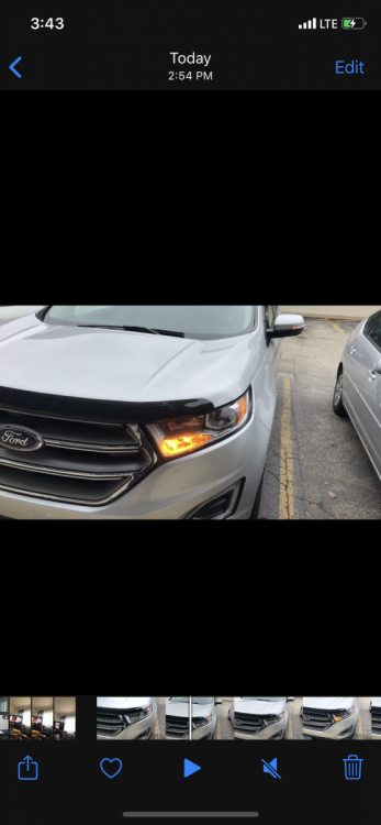

Ruben Posted April 5, 2020 Report Share Posted April 5, 2020 (edited) Hi i just install led turn signal from lasfit for my 2017 ford edge titanium. So interesting thing is when my car light is off turn signal work perfectly fine but when i turn lights on it act differently like turn signal go dimmer and it will get hyper flash. So again when my car light are off it work fine but when its on it just doesn’t work as it should be. Is there way to stop this. Please help I literally search everything cant find anything. Thanks here is video of whats happening: From inside and outside https://drive.google.com/file/d/1Gpo3yU8kZ4Gl79GmW0V-1-BiUtxktH9o/view?usp=drivesdk https://drive.google.com/file/d/1MYfp5SWTFbNfEjtFh6y7h7NziNZFcSyc/view?usp=drivesdk Edited April 5, 2020 by Ruben Quote Link to comment Share on other sites More sharing options...
omar302 Posted April 5, 2020 Report Share Posted April 5, 2020 I believe your problem is coming from the fact that the parking light is the same turn signal bulb only with 5 volts. In other words, for the bulb to function as a turn signal it is supplied with 12 volts and when parking light is required it is supplied with 5 volts. So with parking light and turn signal on, it is switching from 5v to 12v and so on which is not playing nice with LED bulb. In this post I had disabled the 5V parking light function (position light). Might want to try it. Also, could you please post a comparison between stock and LED signals? Preferable right & left at the same time? I have tried several LED signal bulbs but they were always noticably less bright than the stock bulb. 1 1 Quote Link to comment Share on other sites More sharing options...
Ruben Posted April 5, 2020 Author Report Share Posted April 5, 2020 I was looking literally everything as possible thanks i did as your instructions. Now its works perfectly fine. You might wanna try this one. If you buy from ebay its $15 dollars less than their official website. You will not regret it. Its heck of bright led you can find. I will have link below https://www.ebay.com/itm/123746144708 1 Quote Link to comment Share on other sites More sharing options...

Gadgetjq Posted April 7, 2020 Report Share Posted April 7, 2020 20 hours ago, Ruben said: Hi Ruben, I believe you installed the wrong type of switchback harness. As Omar pointed out the voltage drop is causing part of your problem, the lack of a proper resistor is causing another. The style you 'need' looks like the one in this link (it's installed in my '16 with no issues for nearly a year) https://amzn.to/2V47Qv6 Notice there's an extra wire. It's there to power the white (parking/drl) lights when turn signals aren't operating. It's plugged into a switched circuit in the engine compartment fuse box using an Add-a-Fuse. With this setup the white leds are getting full power all the time. About the hyperflash, there are two ways to fix it. Either use 6 ohm resistors as shown in the link or, if you have and know how to use FORScan simply turn off hyperflash. With that done you don't need the resistors. It 'might' (no guarantees) even work in your situation. Here's the code change needed via FORScan: Toggle Hyperflash On/Off Front (Bulbs) 16-19MY BCM 726-27-01 x*xx xxxx xxzz 0=Disabled, 1=Enabled (Default) — Rear (Bulbs) 16-19MY BCM 726-27-02 xxxx xxxx x*zz 0=Disabled, 1=Enabled (Default) 2 Quote Link to comment Share on other sites More sharing options...
