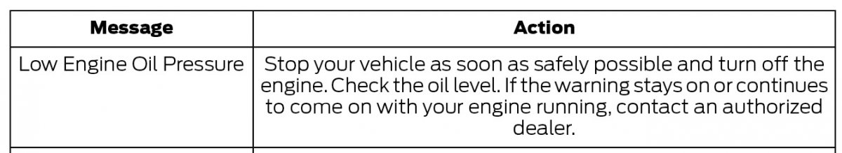

1004ron Posted April 3, 2020 Report Share Posted April 3, 2020 (edited) On 4/3/2020 at 11:12 PM, Ejrivar said: Even tho it had full oil? Expand The light that came on is a low oil pressure indication and that means STOP - it's not an oil level indicator - take a look at the owners manual. Although the owners manual covers this, I believe it should be a little more persuasive. If the engine was shut off immediately the first time the low oil pressure light cam on, you would not be facing the cost of a new engine. Edited April 3, 2020 by 1004ron Quote Link to comment Share on other sites More sharing options...
