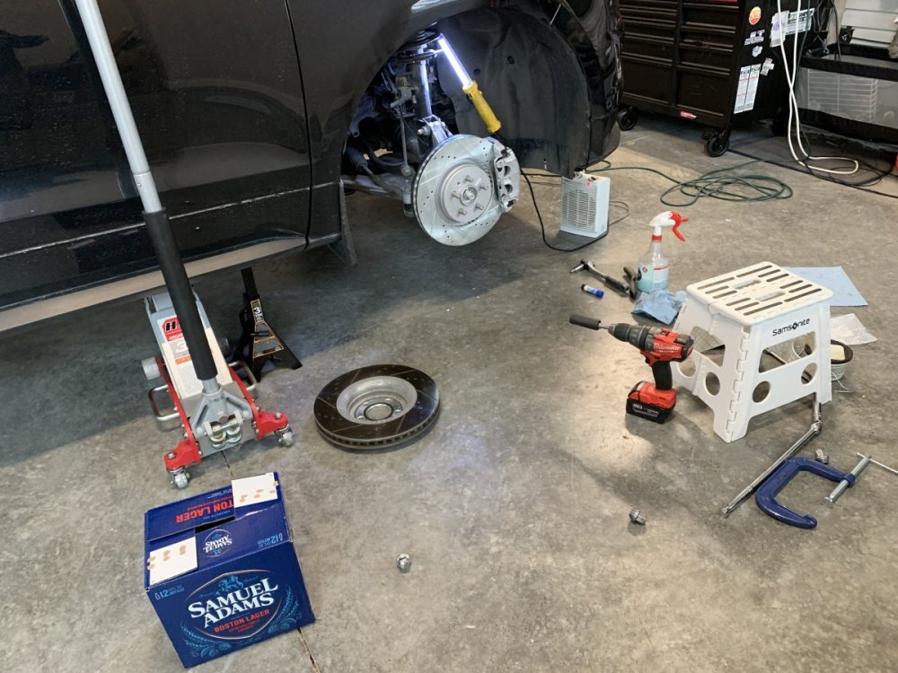

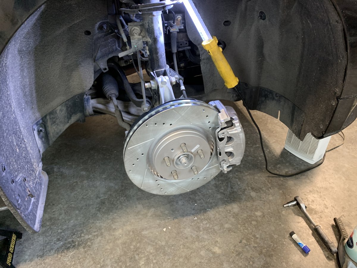

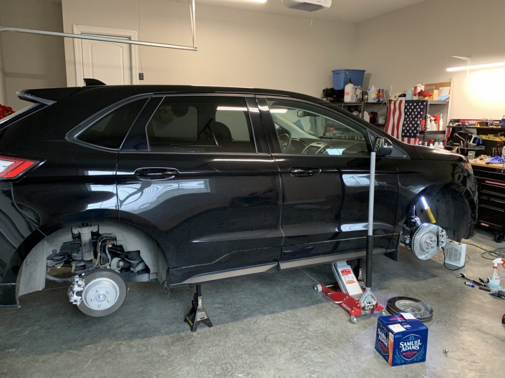

1004ron Posted April 3, 2020 Report Share Posted April 3, 2020 (edited) I cant help with the torque values as I don't use one for this job. In the last picture you'll see the Loctite thread lock stick. I use a jack with a weld/bead/seam protector in the location seen in the attached photo and then position the jack stands, also with protectors, on the locations marked on the beads as the standard jacking points. The position that I have the floor jack lifts the front and rear evenly - center of gravity. Edited April 3, 2020 by 1004ron Quote Link to comment Share on other sites More sharing options...
