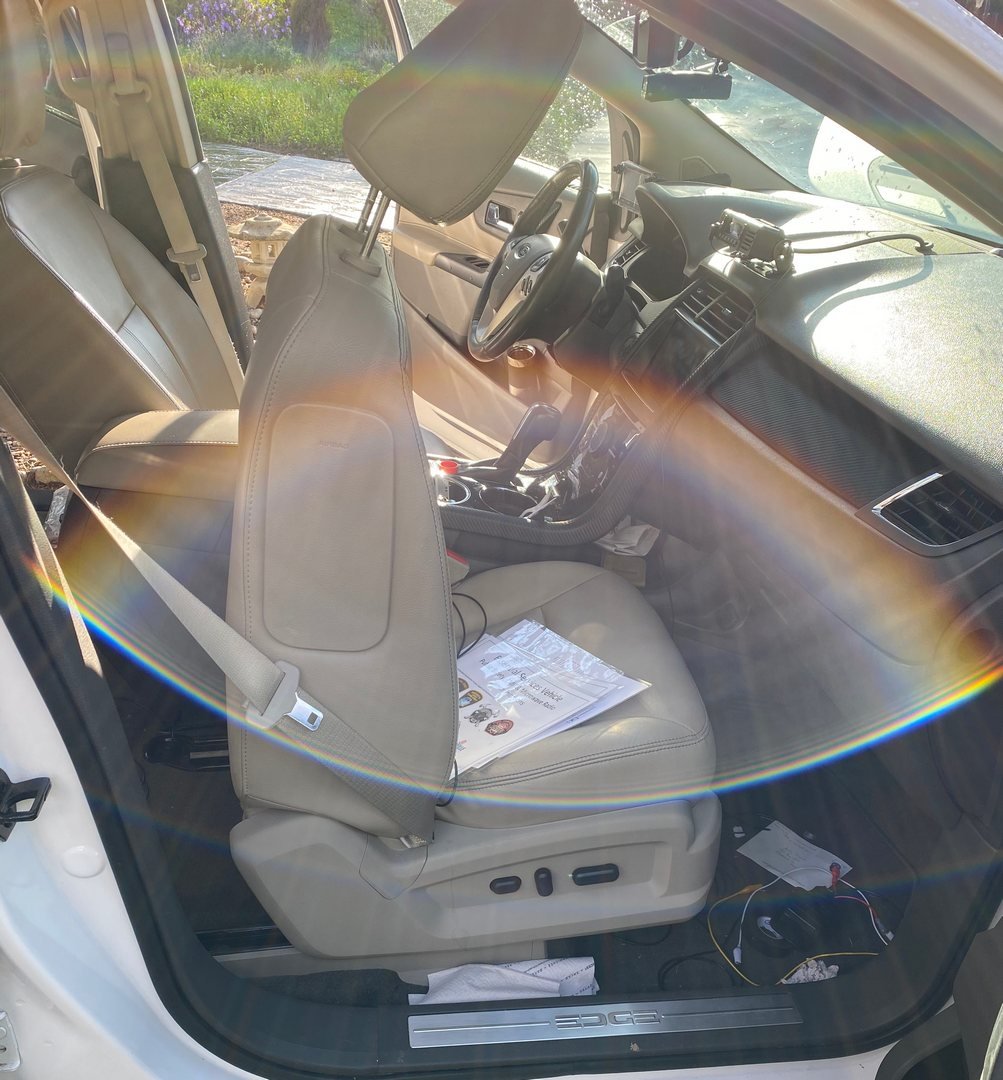

I am working on my 2012 Ford Edge Limited and ran the powered passenger side set all the way forward and tilted the back all the way forward.  Now when I go to move it back, the seat will not move at all.
I have been thorough the manual looking for a passenger side seat or passenger side "anything" and cannot find a fuse listed for it.  Drivers side seat is listed, still works and the fuse is fine.
In trouble shooting I studied the drivers side and then made sure all the wiring harness is connected, and listened to the clicks and relays turning on and off when you press a button.  No sound from the passenger side.
I did hook 12 volts up directly to the  front back motor so at least I could move the seat back, but the back rest is still tilted forward.   No way to get to the back rest connector unless you take the seat all the way out.
Any thoughts on what fuse the passenger seat motors are on?
