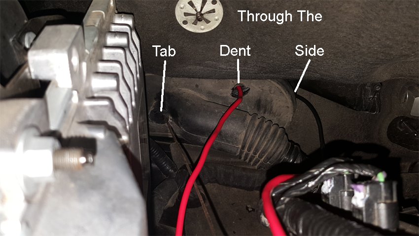

All due respect (and I respect the hell out of anyone who dives in to do their own work) I have one suggestion.  The video shows penetration of the firewall around the 'edge' of the grommet.  While it's certainly the easiest (and maybe most realistic) way to pull 12 feet of heavy cable through it also seems to be asking for trouble with the wire insulation squeezed between a sharp metal edge on one side and the grommet edge on the other.  Maybe a thin metal collar around the wire would help protect it.
I just had to do this for a different sort of project (adding a front camera) and spent quite a bit of time working with that grommet.  There are actually three ways through.  For each you'll pull the grommet away from the body so you can reach behind it and make sure no vehicle wiring is in your path.
1. Around the edge as shown in the video.  This is definitely the easiest.  You should wrap extra tape or put something like a piece of metal tubing around your wire to protect it from the sharp metal body.
2. Cut off the rubber teat (there's probably a technical term) that protrudes from the grommet then, using a small but very sharp knife carefully cut out that section of the grommet.

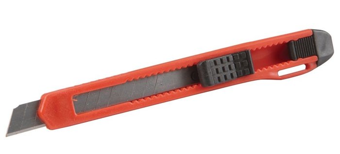

3. As you look at the grommet you'll notice an indentation or circled area.  That's actually the best way through.  The grommet is a little thinner in that spot and there's no vehicle wiring directly behind the area.  It's very easy to use a sharp knife or snap blade (shown below) to very carefully carve a circle in whatever size you need for your wire.  I'd suggest not caving to the urge to use an electric drill.
To route wiring through the opening I suggest you use a piece of stiff wire (16 gauge works well) shoving at least a foot through the grommet.  That will give you enough slack to find behind the heater box (reaching through the glove box opening) to find that fishing wire.  Attach your power or other wire to that and (best with a helper) pull it all through.   Now you have a well protected power wire with no worries it'll ever short against the body of the car and create the dastardly magic smoke.
The photo below shows the three ways through the firewall.  At the far left is a piece of stiff wire pushed through the area where the tab/teat was removed (kind of hard to see), in the center is the 'dent' penetration and at right is wire routed through the side between the grommet and body.
Cheers!
