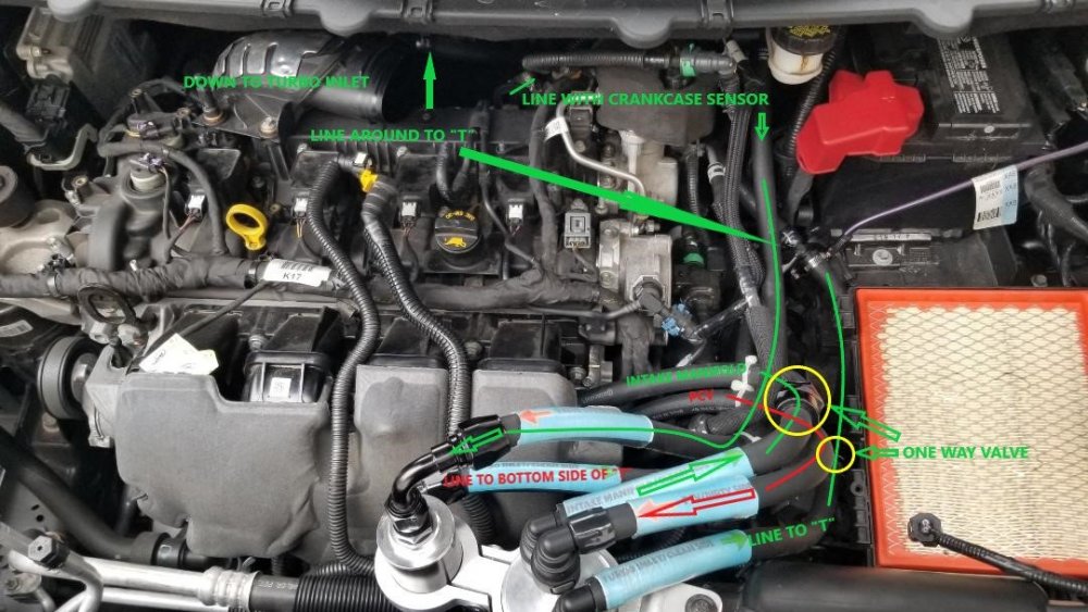

DrivingofftheEdge Posted October 9, 2020 Author Report Share Posted October 9, 2020 Actually my cans are mounted between the rad fans and the intake cover. I sent james at RXP a schematic of how everything is ran and it's how he says to run it 1 Quote Link to comment Share on other sites More sharing options...

DrivingofftheEdge Posted January 1, 2021 Author Report Share Posted January 1, 2021 I sent james a schematic and he said everything looks good. I'm just waiting for his reply to my recent email. I'd hate to take this system off because of a lack of communication. Quote Link to comment Share on other sites More sharing options...
DrivingofftheEdge Posted January 9, 2021 Author Report Share Posted January 9, 2021 Ok well......... cant get a hold of James at RXP. So I'll ask the community for ideas. This is the schematic I sent to him a few months ago. The only part that is a bit of a question mark is the port on the rear of the valve cover. Some people I see plug it off and put a filter on the fitting on the side of the small can. There doesnt seem to be any straight forward instructions on the 2.0 with the new dual can set up. Quote Link to comment Share on other sites More sharing options...

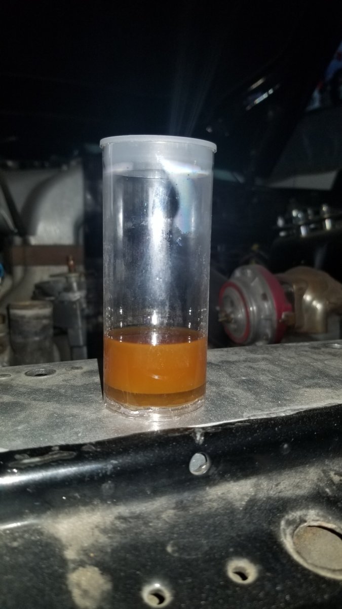

Cerberus Posted February 8, 2024 Report Share Posted February 8, 2024 2 hours ago, uspc40 said: I got my 2020 ST last August, roughly 20k miles on it. Is an oil separator really necessary? People seem to like the J&L, just wondering if this is necessary, or just engine bling..... I have the J&L and have to empty it every couple months, particularly in cooler weather which helps the vapors condense in the CC whether it is necessary..? that's a harder thing to answer. I'd say its a good thing for keeping some garbage out of the intake tract 2 Quote Link to comment Share on other sites More sharing options...
txaggie Posted February 8, 2024 Report Share Posted February 8, 2024 Totally agree with Cerberus. I empty mine every 1000miles and it has about as much as what his picture shows. I added the JLT unit the first week I bought it (2019 ST with 56k miles). Pretty sure I don't want all of that liquid going back into the motor, so for the price and ease of installation and maintenance, I consider it money/time well spent. 1 Quote Link to comment Share on other sites More sharing options...
