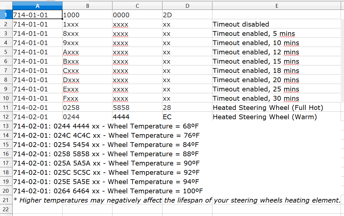

First let the warranty do its job.  The ultimate fix would probably be a whole new steering wheel.
Another possible solution: Use FORScan to check/change settings.  Here's a paste from the F150 spreadsheet that 'should' work in your Edge (not a lot of feedback for 2020 models yet).
