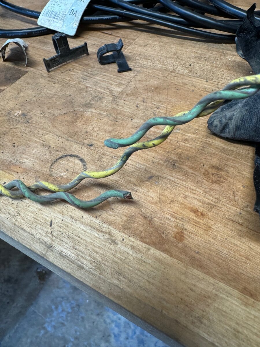

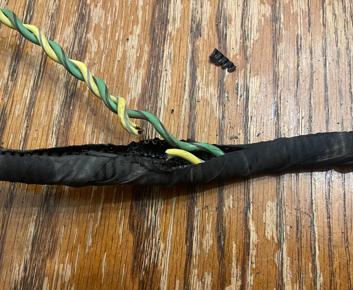

tupac0505 Posted November 22, 2024 Report Share Posted November 22, 2024 On 3/18/2022 at 10:02 AM, Dallas150 said: Hello all. This is kind of a dead thread but I figured I’d post what I’ve found given this happened to me on my MKX. Turned out to just be the wiring harness from the vehicle to the parking brake motor. The failure message was intermittent as some on here also had. Would come on and go away and so on. Scanner displayed 2 codes in ABS module. One for parking brake malfunction and the other for left parking brake motor. For some reason the wiring in these harnesses break inside the wiring loom. See attached. This is what was found inside the wiring loom, makes sense as to why it was failing lol. Not sure how this happens but seems to be common on edges and MKX. Easy repair, around 60$ CAD per side for the new harnesses. Odds are pretty good you don’t need new actuators when this happens, especially if it is intermittent. The abs module stop seeing the motor due to the wire break or almost break which causes the code. This warning self clears when connection reestablished which is why it will go away. Codes with still be logged but light is off. If you have this problem unplug and check the harness (2 wires) for continuity between each end (if you have a multimeter). Resistance should be very low like 0.1 ohms maybe 1ohm but anything higher or and OL reading the harness is nfg and needs to be replaced. Something to try before shelling out to a dealer for some parts you may not need and at an inflated cost. Similar issue for my 2017 Edge Titanium. I had a break in the yellow wire (passenger side) but my parking brake still worked and got no OBD error code. All I had were the warnings on the dash of limited functionality, needing service, red error code and the yellow error icon. Guessing the yellow is ground and the unit was still able to operate as it’s grounded via the bolts. It had somehow corroded in that spot circled red in the pic, even though the wire wrapping and protection around there was in perfect shape. I trimmed it, soldered a bridge and taped it back up. Works for now but I expect in the future will need a proper replacement. The cable is around $35 at the ford dealership here. It’s good to attempt a cable replacement yourself before paying $1k+. Hopefully your actuator is in good shape and doesn’t need replacement too. Cables are super easy to get to if you take the wheel off. Quote Link to comment Share on other sites More sharing options...
