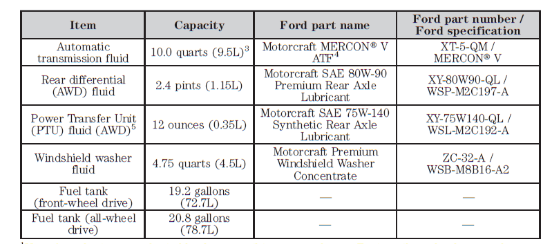

Sir gullible Posted January 23, 2020 Report Share Posted January 23, 2020 Transaxle fluid capacity Quote Link to comment Share on other sites More sharing options...
WWWPerfA_ZN0W Posted January 24, 2020 Report Share Posted January 24, 2020 Check owner.ford.com for the owner's manual which will have all the capacities and specifications you need. Quote Link to comment Share on other sites More sharing options...
Gadgetjq Posted January 24, 2020 Report Share Posted January 24, 2020 (edited) Check your owner's manual. Page 325 When you drain the transaxle fluid you'll only get about half of the total (5 to 5.5 quarts). The rest is trapped in the torque converter. That's the reason three drain/fill cycles are highly recommended. Here's a link to download your manual if yours is missing.: https://carmanuals2.com/d/29536 Edited January 24, 2020 by Gadgetjq added manual link Quote Link to comment Share on other sites More sharing options...
