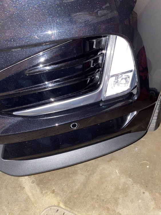

I have my front fascia removed now to install tow plates.
The Ford emblem has two protruding studs with a nut screwed on from the back.
The L shaped piece has tabs that appeared to be epoxied to the panel it attaches to, does not look like removal possible without breaking something.
Removing the front is not that bad, many small screws and plastic push pins. Several wiring connectors on the driver side.  Washer hose on the passenger side. Headlight removal is required first.
