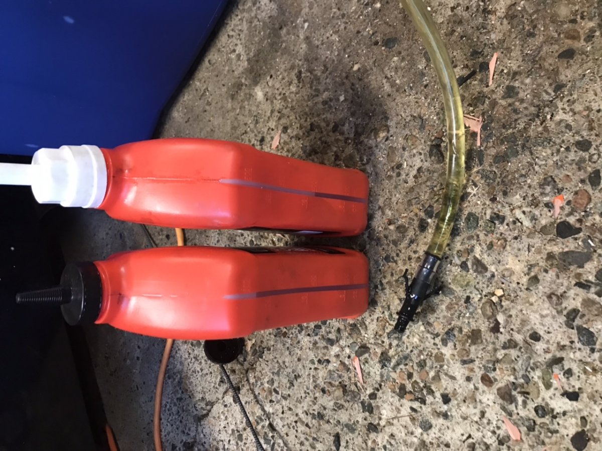

lightning4eva Posted January 11, 2020 Report Share Posted January 11, 2020 (edited) So, I have no excuse on why I never did a PTU fluid change. First one I “tried” to do at 159k. Used the auto hobby shop on base, had my siphon and got maybe an ounce out. Put in 2-3 oz, drove it for week or so. At ~159,250, did another drain and fill and this time got out 3-4 oz. Just did my 3rd at about 160k, while we had a 60-70 degree day in MA and got out a significant amount and then was able to put in 2/3 to 3/4ths of a quart. Feeling better about it but still regret waiting so long. I’ll do one more in the next few months to see if I can get any more out. Pic shows how much of a brand new bottle I was able to get in the PTU, the second and third time. Never had an issue with the PTU but after reading how semi-easy it is to change (and some scary YT videos) why not. I’ll be doing it on my 2015 Sport either tonight or very soon. Thanks for looking. Edited January 12, 2020 by lightning4eva Quote Link to comment Share on other sites More sharing options...

lightning4eva Posted January 12, 2020 Author Report Share Posted January 12, 2020 Totally forgot to mention the drain plug. Forgot to take a picture when I first got it out. The smell was pretty intense. I took this pic after taking a huge amount off. Maybe 1/4”. Both of the other drain and fills had minimal. Quote Link to comment Share on other sites More sharing options...
lightning4eva Posted January 12, 2020 Author Report Share Posted January 12, 2020 On 1/12/2020 at 6:18 PM, Mastertvtech said: Why not add a drain plug? Expand Valid point, never done it before. Watched a few videos of guys doing it. If I was planning on keeping it forever I will probably do it. Quote Link to comment Share on other sites More sharing options...
