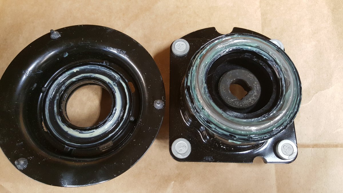

bb56 Posted January 11, 2020 Report Share Posted January 11, 2020 I'm about to replace my Strut mounts in my 2011 Edge AWD Limited. I decided to replace the actual strut too even though they feel great. I figured since I have to take the strut apart anyway... So I ordered the Motocraft strut mounts from Rock Auto. They arrived in one day which was pretty impressive. The problem is that one mount was in it's original box with no packing while the other was wrapped tight with shipping paper. Both original product boxes were shipped in a larger box with air pillow packing. The product box with no packing showed where the mounting bolts were poking almost through the cardboard. So upon opening that slightly damaged box, I see a new mount that was slightly cocked to one sice and i could wiggle the two halves. When I tried to straighten the two halves, they came apart and the ball bearings and races were open. Since the balls stuck to both races, I moved them to one and noticed that it looks like at least one, possibly 2 balls are missing as you can see in the following pic. I also noticed there wasn't much grease in there. So not knowing if this mount was defective or not, I opened the second box and fount it tightly wrapped in paper and not crooked. I gently pulled the two halves and it came apart as easily as the first one! It also looked like 1 or two bearings were missing so I'm thinking this is normal. After closing them back up and spinning it several times, the balls looked pretty evenly distributed. So the only thing I can think of is that they don't have enough grease and I packed them with wheel bearing grease and snapped the two halves together again. So before I put them in the car, can anyone with hands-on experience with these strut mounts tell me if I'm really way off base in thinking that: 1) It is normal for these mounts to come apart so easily. 2) That it is normal to see spaces between the roller balls in this type of bearing 3) That Ford makes them with just a small amount of grease and that's why they go bad so easily. I am assuming that when fitted over the spring and strut, the two halves are clamped tightly together and will be OEM quality fitment.The last thing I want to do is this job twice after finding out these are bad mounts. I hope to do this job this week so please send your thoughts. Thanks much. Bart Quote Link to comment Share on other sites More sharing options...
bb56 Posted January 18, 2020 Author Report Share Posted January 18, 2020 And here are the OLD ones that would make thumping noises when I turned my steering wheel. Interestingly enough, they also look like 2 bearing balls are missing: Neither looks bad to the naked eye except for the brownish look to the grease. I would hazard to guess that repacking them would refurbish them to usable bearings again. Unfortunately, it's a lot of work to pull the strut apart to not spend the $90 for new ones. Quote Link to comment Share on other sites More sharing options...
vega Posted January 18, 2020 Report Share Posted January 18, 2020 How about the thumping? Is there some dimple or gouge in the old ones bearing race responsible for the noise? Inquiring minds need to know. Quote Link to comment Share on other sites More sharing options...
1004ron Posted January 18, 2020 Report Share Posted January 18, 2020 As you've guessed after opening the originals, that spacing is normal. For that kind of thing I use a good water proof grease. Quote Link to comment Share on other sites More sharing options...
bb56 Posted January 18, 2020 Author Report Share Posted January 18, 2020 @vega I haven't cleaned them up so I do not see any irregularities in either mount that would cause the thumping. But then again, the thumping wasn't regular. It would happen often enough while turning AND going over a small bump like turning into my driveway but not all the time. When I would stop while waiting for the garage door to open, then turn/straighten the wheel, the thump would likely happen. @1004ron Yep - I basically concluded it must be normal. Actually, when the second new one was like the first, I pretty much accepted it as normal. I can understand some spacing but it seemed excessive at about 8 mm. (the balls are 0.15" or just under 4 mm diameter). I've forgotten what it was like to have normal quiet turning. It's been like that since I got it in 2016 and it was on this forum that I learned about the bad mounts making the thumping noise. It just took me a while to read enough posts to get there LOL! So I thought I would share what I found. Thanks all! 1 Quote Link to comment Share on other sites More sharing options...
1004ron Posted January 18, 2020 Report Share Posted January 18, 2020 The lubricant in the old bearings may be dirty, but doesn't look like they're worn out, at least not in a condition that would cause thumping - maybe the rubber cushions are bad? Quote Link to comment Share on other sites More sharing options...
bb56 Posted January 20, 2020 Author Report Share Posted January 20, 2020 @1004ron Just checked the rubber cushions and they look fine. I snapped them back together and they do sound noisier than the new ones. Maybe all they need is new grease, but too late now. I did not want to take the strut apart and reassemble with old parts so now I have 2 good struts (with ? miles left - who knows) and 2 questionable mounts to throw away. Wish I knew where to get rid of car parts. I have several others stacked in the garage. Thanks for the comments and suggestions - it always helps to discuss with others! 1 Quote Link to comment Share on other sites More sharing options...
