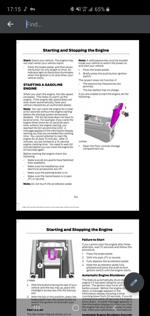

IcyFridge Posted January 9, 2020 Report Share Posted January 9, 2020 I was cleaning, and found out that there's like an opening of sorts in the front bottom of the armrest console area. Does anyone have any idea what it's for? 2019 owners, open the center console and stick your arm down and then forward. Quote Link to comment Share on other sites More sharing options...

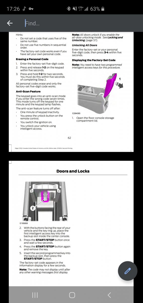

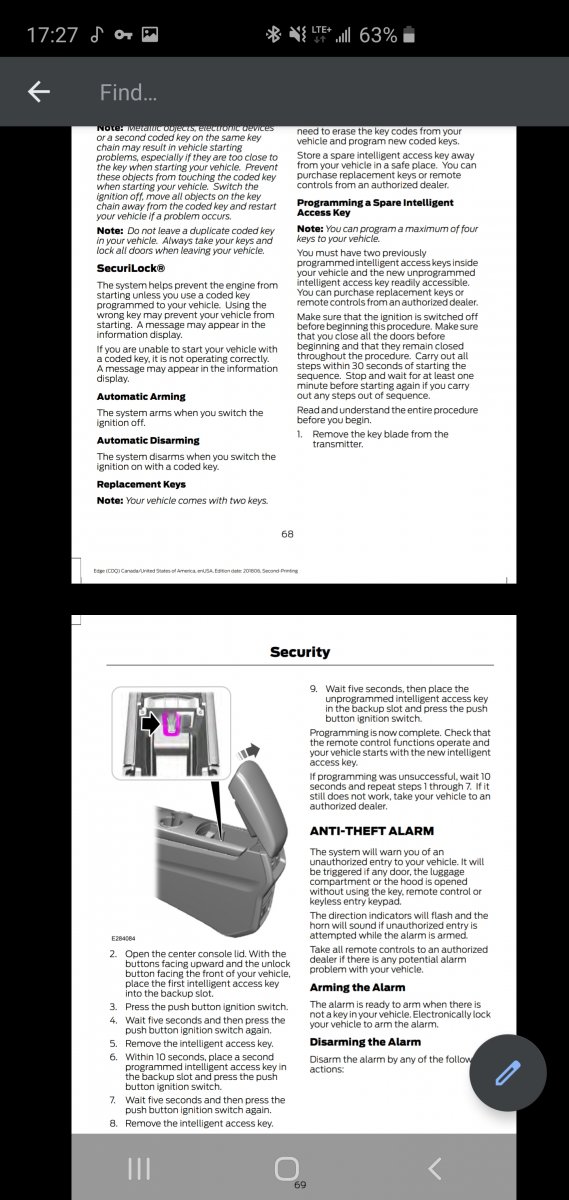

ONEDGE16 Posted January 9, 2020 Report Share Posted January 9, 2020 (edited) Few reasons it's there: 1- start the car in case your keyfob is dead 2- display factory set 5 digits code 3- program additional keyfobs (need both orohinam keyfobs in the car and you can program additional ones) Edited January 9, 2020 by ONEDGE16 1 Quote Link to comment Share on other sites More sharing options...
IcyFridge Posted January 9, 2020 Author Report Share Posted January 9, 2020 Completely and utterly awesome!!! So it would function as a close range chip reader if the fob battery is dead or frequency isn't picked up. Quote Link to comment Share on other sites More sharing options...
