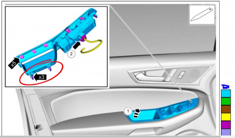

omar302 Posted December 2, 2020 Report Share Posted December 2, 2020 Check this from the service manual on how to remove the Driver Door Window Control Switch. Quote Link to comment Share on other sites More sharing options...
njbillt Posted December 2, 2020 Author Report Share Posted December 2, 2020 Thank you for this. Even though this post is almost a year old I still haven't been able to get it off. I can use a tool to get all the clips (X5) at the top, but cannot get the 2 of (X3) at the bottom. It feels like it will break before they let go. How do I access them? Quote Link to comment Share on other sites More sharing options...
