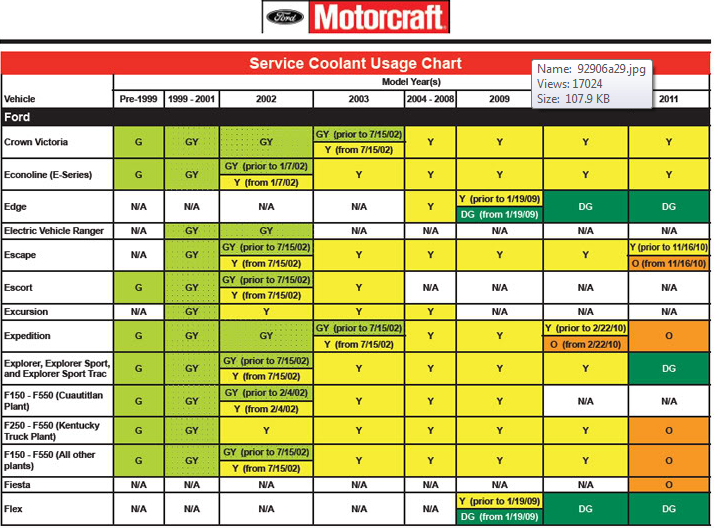

JoeVic Posted December 7, 2019 Report Share Posted December 7, 2019 2 Quote Link to comment Share on other sites More sharing options...
JoeVic Posted December 7, 2019 Report Share Posted December 7, 2019 (edited) Yours is showing the Gold is required. I know you can still get it from Ford, because I still use it in a 2004 Crown Vic. I would assume that you could switch to another flavor, as long as it is flushed well and make sure you continue to use the same type. Ironically I bought extra of the Motorcraft Orange Coolant for my 2015 and now my new 2019 ST was filled with the Yellow and there was an addition to the owners manual noting the change. Quick video on the different colors: Edited December 7, 2019 by JoeVic 1 Quote Link to comment Share on other sites More sharing options...

chotabeam Posted December 8, 2019 Author Report Share Posted December 8, 2019 Thanks everyone for their input. I spent some time in this forum as Non-member before buying the Edge. I have the Coolant chart as pdf in my computer. When I did search "Coolant" in this forum, the results came to 43 pages. I went through first 15 pages and still was not clear whether whoever had Gold coolant (from 07 to 09 MY) changed to Green. So, I posted the question. Now WWWPerfA_ZN0W cleared that doubt and Thank you sir. So, I will ask the dealer to change the coolant to Dark Green. I watched a lot of MacTFordEdge videos in the last 3 weeks and changed my steering fluid yesterday like he did. Thanks to him and all senior members here. Regards, Chotabeam 1 Quote Link to comment Share on other sites More sharing options...
WWWPerfA_ZN0W Posted December 8, 2019 Report Share Posted December 8, 2019 basically, the recommendation to change over to spec green was a result of this field service action from Ford 09M04 09M04-S1 Certain 2007 through 2009 model year Edge and MKX Vehicles - Cooling System Corrosion.pdf 1 Quote Link to comment Share on other sites More sharing options...
chotabeam Posted December 9, 2019 Author Report Share Posted December 9, 2019 WWWPerfA_ZN0W, Basically going from Coolant part number VC-7-B (which was put in my vehicle - Gold) to VC-10-A (or A2) Specialty Dark Green, right? Thanks. Quote Link to comment Share on other sites More sharing options...
