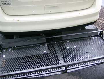

Mystery Posted August 21, 2008 Report Share Posted August 21, 2008 Hi Everyone, A problem I ran into with my Escape and it appears it will be the same with the Edge is exhaust melting gear on a hitch mounted cargo carrier. Because the after market hitches hang under the bumper it places your gear directly in the path of the heat. On the net I found many people recommend putting a turn down tip on the exhaust, but doesn't that affect the performance? The only time I really use this is when I am traveling a great distance so I would hate to put a turn down tip on for such limited use. I think that would look silly and then would require me to have two sets of tips to change out. That sounds expensive. Has anyone else came up with a solution for this? Thanks in advance for your help. Mark Quote Link to comment Share on other sites More sharing options...

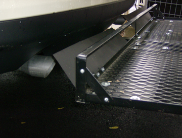

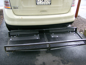

Mystery Posted September 29, 2008 Author Report Share Posted September 29, 2008 (edited) The easier thing would be to drill a few holes in the heat shiled and then simply attach it to the cargo frame with stainless wire. I actually think that thick tie wraps would work just fine. Good luck. Either one of thse option would not require any permanent mod to your cargo system. Thanks for the suggestions. Here is what I ended up doing. Compared to my Escape where I really had the problem the dual exhaust cools the temp quite a bit and this heat shield that I added only cost me about 25 bucks. It did a great job of diverting the exhaust. I was concerned that the shield may cause an issue with the bumper while idling or in traffic but no issues. I hope this helps. Mark Edited September 29, 2008 by Mystery Quote Link to comment Share on other sites More sharing options...
