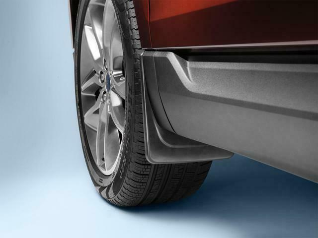

Gadgetjq Posted December 7, 2019 Report Share Posted December 7, 2019 (edited) 46 minutes ago, cleekoguy said: Okay, here is the bad news. Dealer wants for the parts and labor $600. Did you price out the parts only? Replacing a door seal and adding a splash shield shouldn't be difficult. Amazon has the OEM splash guards front and rear for under $100: https://amzn.to/345mXag Here's what it looks like on the front Edited December 7, 2019 by Gadgetjq Added photo Quote Link to comment Share on other sites More sharing options...
