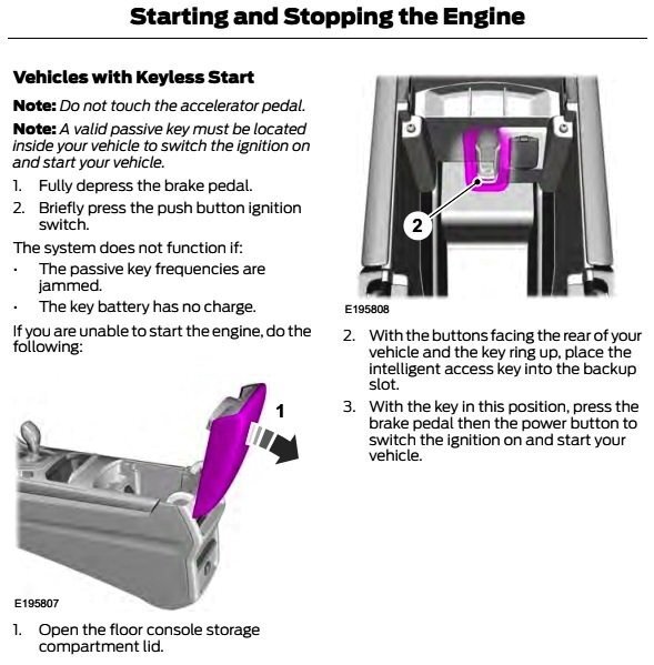

dabangsta Posted October 6, 2024 Report Share Posted October 6, 2024 5 hours ago, brentski said: Start stop button doesn't detect keyfob Help Is it detected for proximity unlock, or do you need to press a fob button to unlock or use the emergency key to get in it? If the battery is dead, you can place the key in the emergency slot in the center console (it is at the front under the coin trays) with the buttons up and the key ring to the rear, press brake and start button and see if that works. 1 Quote Link to comment Share on other sites More sharing options...
Haz Posted October 6, 2024 Report Share Posted October 6, 2024 From the 2015 Edge Owner's Manual, page 152... Good luck! 1 Quote Link to comment Share on other sites More sharing options...
