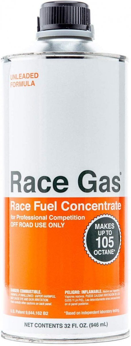

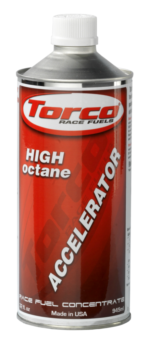

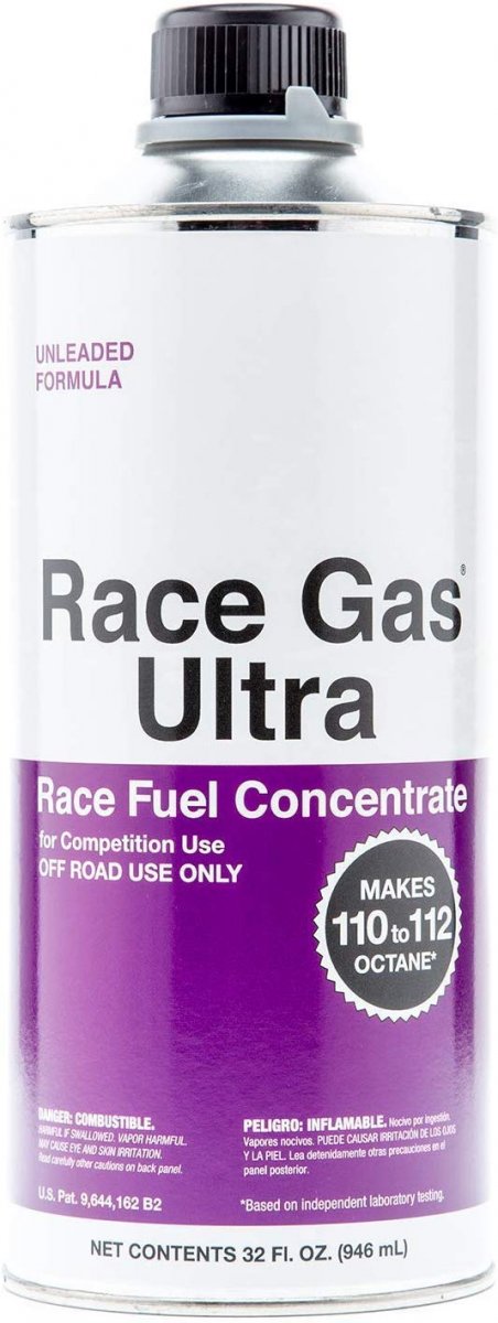

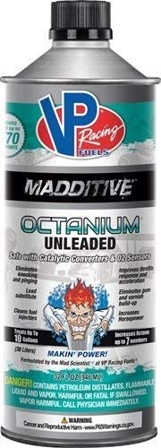

Xtra Posted November 26, 2019 Report Share Posted November 26, 2019 (edited) I have used VP, Torco and Race Gas products. The only one I have not tried is the Race Gas Ultra. Where I live 91 is the best you can get. Sometimes I like to run the 93 tune but to do that I have to buy 100 octane Race fuel at $9.40 per gal and blend it with 91, or use one of these additives. I decided to try all three bad to back with a tank of gas to compare. First up was the VP Madditive I rate it last place as my motor ran rough and did not make good power. I was concerned that it did not rase the octane enough to run the 93 tune although I did and there was no damage. I will not buy it again. Next place goes to Torco Accellrator this product worked well with the 93 tune providing smooth acceleration and noticeable power gains I would use it again if Race Gas was unavailable. In first place and making me a believer is Race Gas. I mixed one can to a tank of 91 and what a difference it made with the 93 tune. The car came alive and was making tons of power. The engine also sounded quieter and smoother than with Torco. I am going to try the Race Gas ultra next. It might be overkill as the normal Race Gas worked so well . I should have used my Dragy to have numbers to back up my butt dyno. Oh well next time. Edited November 26, 2019 by Xtra 3 Quote Link to comment Share on other sites More sharing options...
