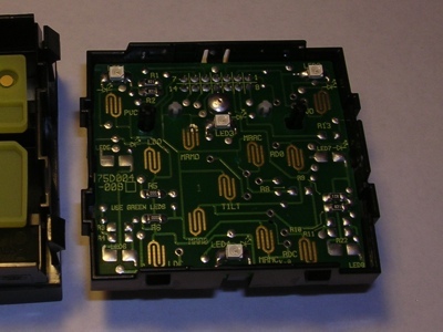

Attached is a pix of the switch un-assembled. I took this from another forum. The forum member claimed its from an '07 edge and all the hardware is there, just need to apply 12v and lights go on. I think the lincoln version is the same, but for some reason they omit (1) wire to power it on the edge.
I will look for the post were this pix came from on the other forum. It had all the details, but I never followed up.

I am now on a mission to do this. I already took the unit apart to scope it out. I have tackled projects WAY bigger than this here on my Edge and made them happen... this should be totally doable. I just need a little more understanding.

There appears to be 2 pins at the top of the board. There probably is a 2 pin connector on the pigtail.
I believe what you see as 'pins' are, in fact, actually slices in the plastic housing that are for the clips on the opposite piece to snap home. I have attached a blown up pixelated image of that board, you can see only circuits at the top of that board. no 'pins' that I see. The image below that I found also and it seems to show the motherboard taken out of the plastic housing - maybe giving access to actual pins on the other side?

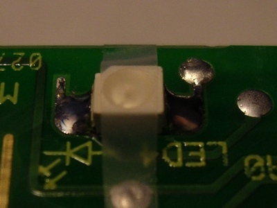

Why is there a piece of tape over the LED on one of your pics?
Thanks, Sanche

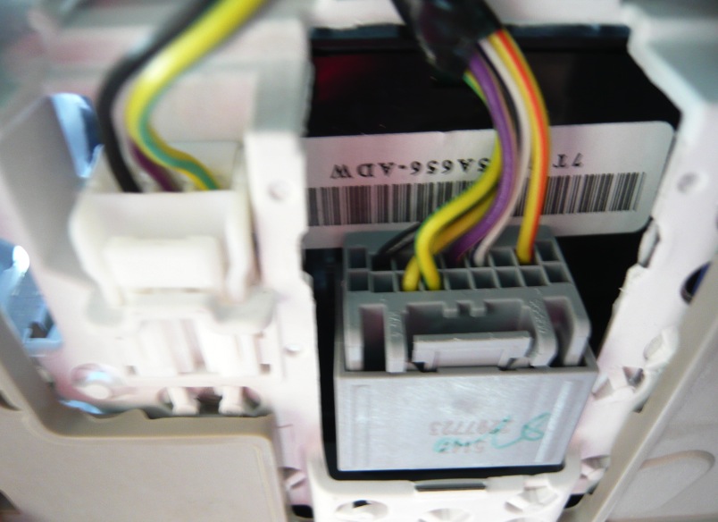

So, it dawned on me last night what this whole "pin" reference was and I am one step closer to solving this. :shades:
On the flip side of the mother board are 2 pinned harnesses ports that the 2 pigtails from the headliner plug into. Notice the 2 pigtails are white and gray. Notice the gray port on the motherboard has 14 "pins" while the white port has 3 larger pins. The gray one seems to power the BAMR roof controls while the white one seems to supply power to the overhead map lights. I believe these are the 'pins' Jpark reference, they were never seen in his photo as they are on the opposite side. :)
Now, look at just the gray pigtail - the key one in solving this I believe - coming from the headliner - as the pictures show, there are 18 lead/pin holes available in total, not 14. BUT also notice that we only use 6 of them (as seen by looking at the wires in the bundle that come into the backside of the gray pigtail). So, when you plug this pigtail in, it is contacting just 6 of the 14 open pins on the motherboard side. So, this tells me that in the Lincoln, there is/are another wire(s) coming into that gray pigtail in that wire bundle and in the end, making more than 6 pin connections. This lines up with Jparks reference to just needing another '3 feet of wire' as the ground is there already for us.
SO.. the million dollar questions are (1) what lead/pin hole would you run a wire into (notice there are 8 to select from that would line up with pins), which one is the golden pin and (2) what color existing wire would you tap into the existing wire bundle to get the correct power if you knew what lead/pin hole to tap into. Jpark mentions "accessory delay feed" - if so, what color is that currently?
Thanks, Sanche

(that tape on the led is not my photo, it is one I found and posted for reference)

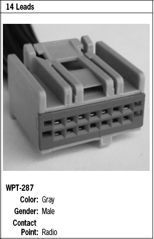

Thanks for the pictures, its the next best thing to being there.
I'm studying them and looking at the patterns (pin locations) of the m/b receptical/WPT-287 conn./production connector relative to the alignment key on all three.
I think the answer to # 2 question requires a test light (probe) or better yet a voltmeter. Ground one side of the meter(test light) and check each connector socket for voltage, with the ignition key on of course :reading:
I think you should see battery voltage, but to be sure, I would use a voltmeter. If it's other that 12v, problem may be a little more difficult to solve. You can then try finding which is live in accessory position as well, then you will have a voltage source to tap into and may also be the accessory lead your looking for.
For the #1 question, my guess at this point is the second pin from the left, top row in the picture showing the gray socket attached to the mother board. But before you try to light them up, PLEASE see if you can get continuity between the solder pin marked #2 and the LED's. If you do, the next thing to check is solder pin #2 to the pin I described in gray receptical.
Can you post a couple more pics that show the M/B solder pin #s and gray socket, like Jpark's pic, but one that shows the side w/ the gray receptical.
