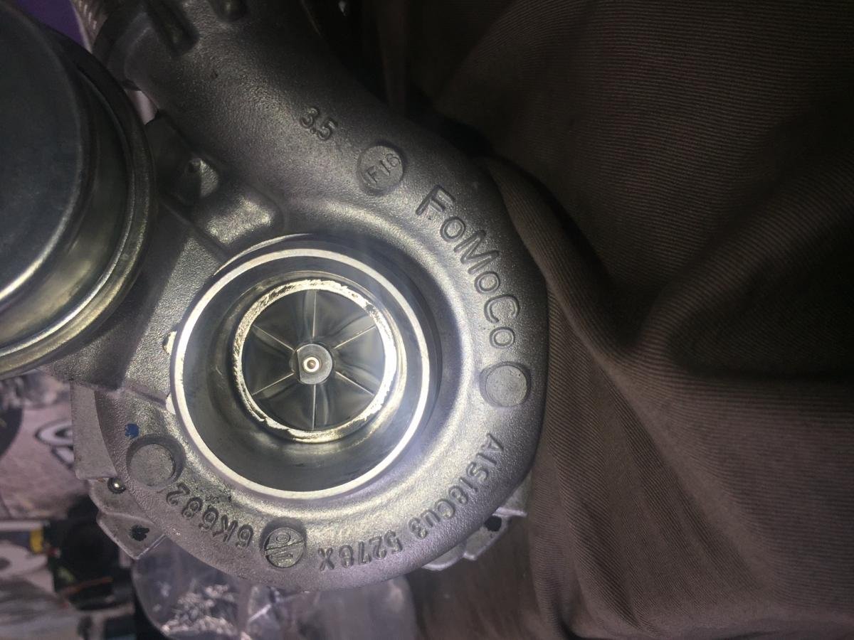

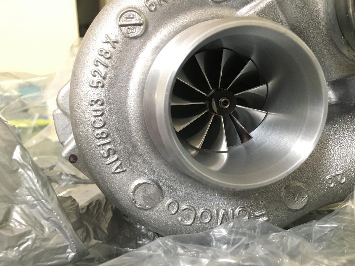

Xtra Posted November 17, 2019 Report Share Posted November 17, 2019 (edited) Both snmjim and I have custom turbo mods on our cars. I bought some used turbos for my car at http://car-part.com and had them upgraded at Comp Turbos in California https://www.compturbotechnology.com. By doing this they were a direct bolt in swap. Stock has a six blade cast and the mod has a 11 blade CNC you can see how it is hogged out to the max . Not sure but as I remember the stock turbos are 57mm and the mod turbos are 61mm. Here are the before and after photos. Not sure this will work but check this out https://www.steeda.com/atp-focus-st-gt2860rs-bolt-on-turbo-upgrade-13-14-st-987-atp-foc-010 .Good luck. Edited November 17, 2019 by Xtra 1 Quote Link to comment Share on other sites More sharing options...
