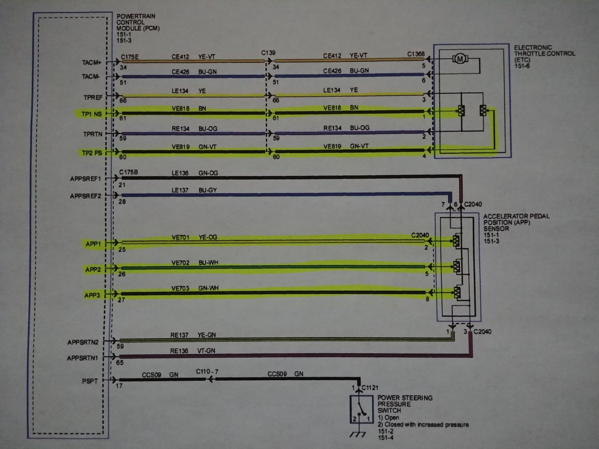

Deoxyrybose Posted November 9, 2019 Author Report Share Posted November 9, 2019 Nobody...? I have some wiring diagrams. I can locate the signal wires on both the throttle position sensors, signals on the 3 accelerator pedal position sensors, and the signals from the input and output shaft speed sensors (the ones in the trans that always go bad). The goal is to view the signals for any obvious issues, and try to view each during the bad shifting events. Today it was 30 degrees this morning, and the entire length of my street it wouldn't upshift. I'm going to double check fluid, but I feel like this is an electronic issue. Quote Link to comment Share on other sites More sharing options...
