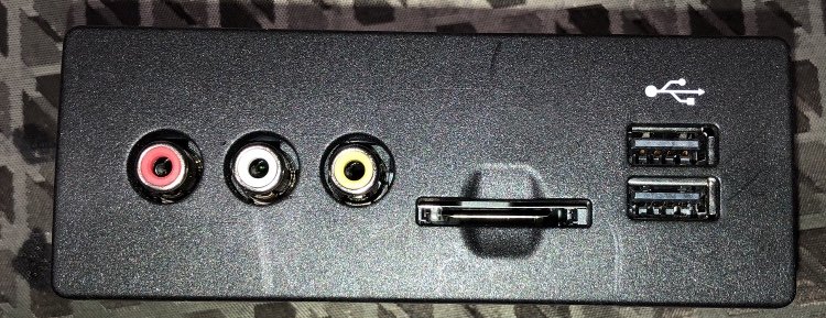

onyxbfly Posted December 11, 2019 Report Share Posted December 11, 2019 1 minute ago, Spaceman Spiff said: Hi onyxbfly, How did you connect the Sync 3 USB hub to the Sync 2 wire connector? Did you use the Dtech adapter or just made up something? I ordered the USB media connector from @TXFRDOwner I purchased 3 sync kits from him. One for my brother one for my lady and one for a coworker. I have another co worker who wants to do a SYNC3 conversion in his mustang which should be fun. He's also talking about doing the digital dash. If he pulls the trigger on the dash I'll take plenty of pics! 1 Quote Link to comment Share on other sites More sharing options...

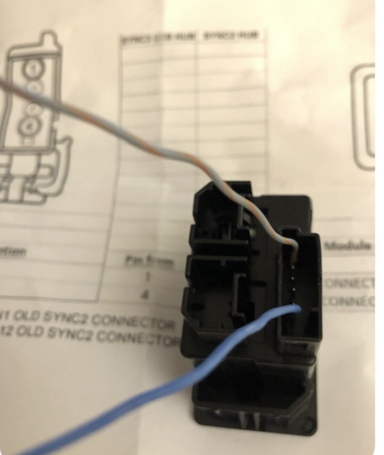

Spaceman Spiff Posted December 11, 2019 Author Report Share Posted December 11, 2019 (edited) Thanks again. I have the sync 3 installed now. The person I got it from has wire connected to pin spots on both connectors. It works but I’m not fussy on that connection I’d rather have it connected to real connectors but to cheap to spend $50 on the dtech connector. Lol Edited December 11, 2019 by Spaceman Spiff Quote Link to comment Share on other sites More sharing options...
onyxbfly Posted December 11, 2019 Report Share Posted December 11, 2019 (edited) I agree, I certainly do not blame you there. That connection looks fine for a quick test, but a permanent install not so much. The USB/ Media hub connectors were $30 each. (I just double checked for you.) Reach out to him, or I can drop him a line, and see what he will do for you..... Which media/ USB connection do you have? Edited December 11, 2019 by onyxbfly Quote Link to comment Share on other sites More sharing options...
onyxbfly Posted December 11, 2019 Report Share Posted December 11, 2019 He has them cheaper at the moment. HAHAH Point your browser in this direction: https://www.ebay.com/itm/143048747613 1 Quote Link to comment Share on other sites More sharing options...
Spaceman Spiff Posted December 11, 2019 Author Report Share Posted December 11, 2019 7 minutes ago, onyxbfly said: He has them cheaper at the moment. HAHAH Point your browser in this direction: https://www.ebay.com/itm/143048747613 Awesome. Thanks so much. i just have the standard sync 2 to 3. Quote Link to comment Share on other sites More sharing options...
onyxbfly Posted December 11, 2019 Report Share Posted December 11, 2019 (edited) 6 minutes ago, Spaceman Spiff said: Awesome. Thanks so much. i just have the standard sync 2 to 3. You got it. Happy to help when I can. Pick the one in the auction that applies to your edge. I usually receive it in a few days, always within the same week. But with the holidays coming up, you may want to get on it sooner than later. Edited December 11, 2019 by onyxbfly Quote Link to comment Share on other sites More sharing options...
Spaceman Spiff Posted December 11, 2019 Author Report Share Posted December 11, 2019 11 minutes ago, onyxbfly said: You got it. Happy to help when I can. Pick the one in the auction that applies to your edge. I usually receive it in a few days, always within the same week. But with the holidays coming up, you may want to get on it sooner than later. Mine doesn’t quite look the same as his eBay pics. I’ll send him a message. I’m sure he’ll have one that works. Thanks again Quote Link to comment Share on other sites More sharing options...
onyxbfly Posted December 11, 2019 Report Share Posted December 11, 2019 3 minutes ago, Spaceman Spiff said: Mine doesn’t quite look the same as his eBay pics. I’ll send him a message. I’m sure he’ll have one that works. Thanks again You would need the one that he is sold out on. Reach out to him, he will sort you out. Quote Link to comment Share on other sites More sharing options...
