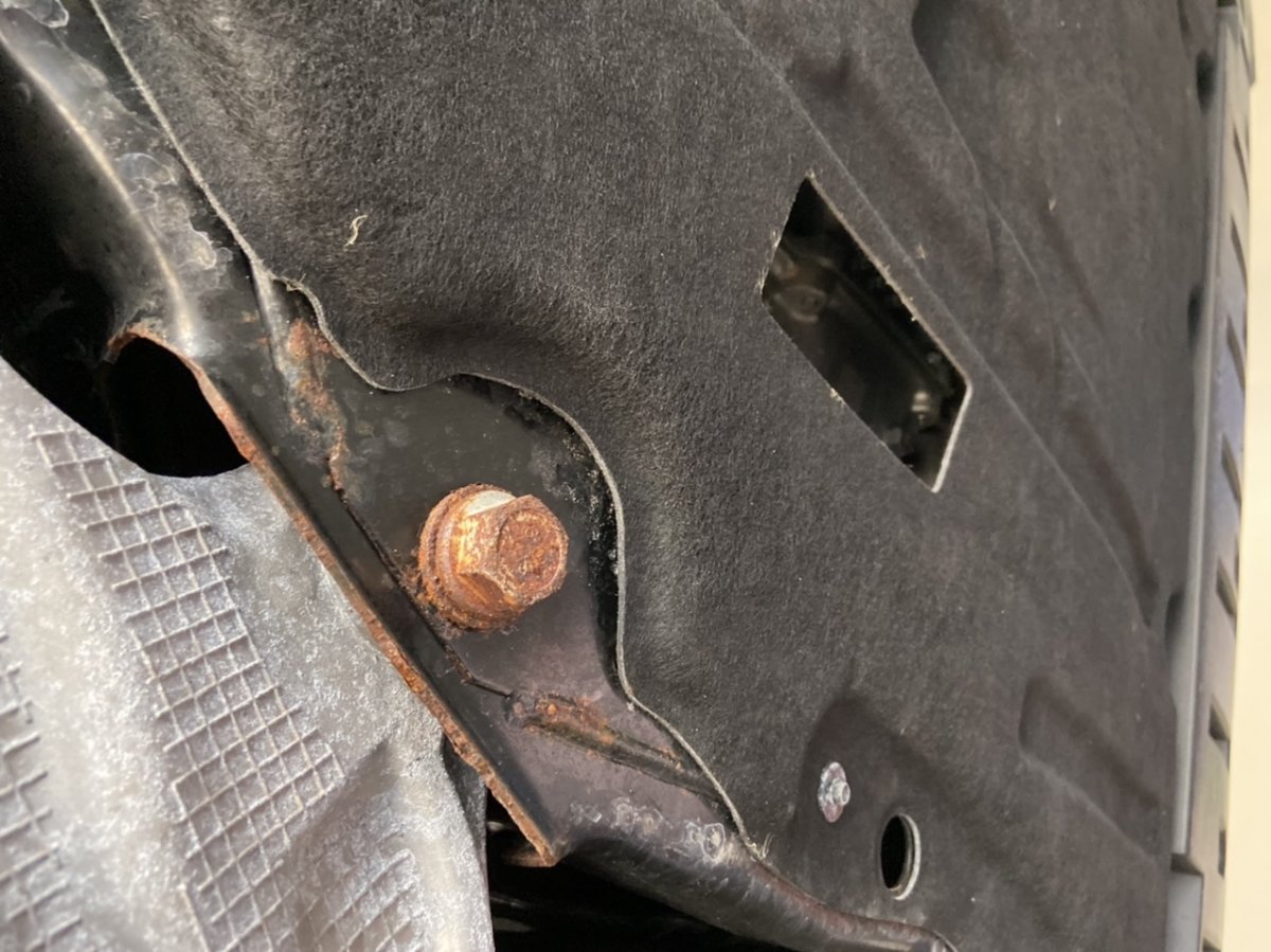

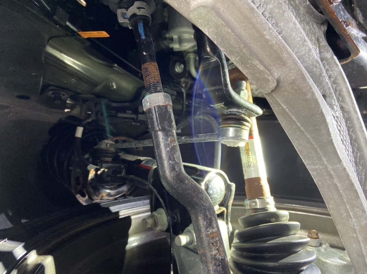

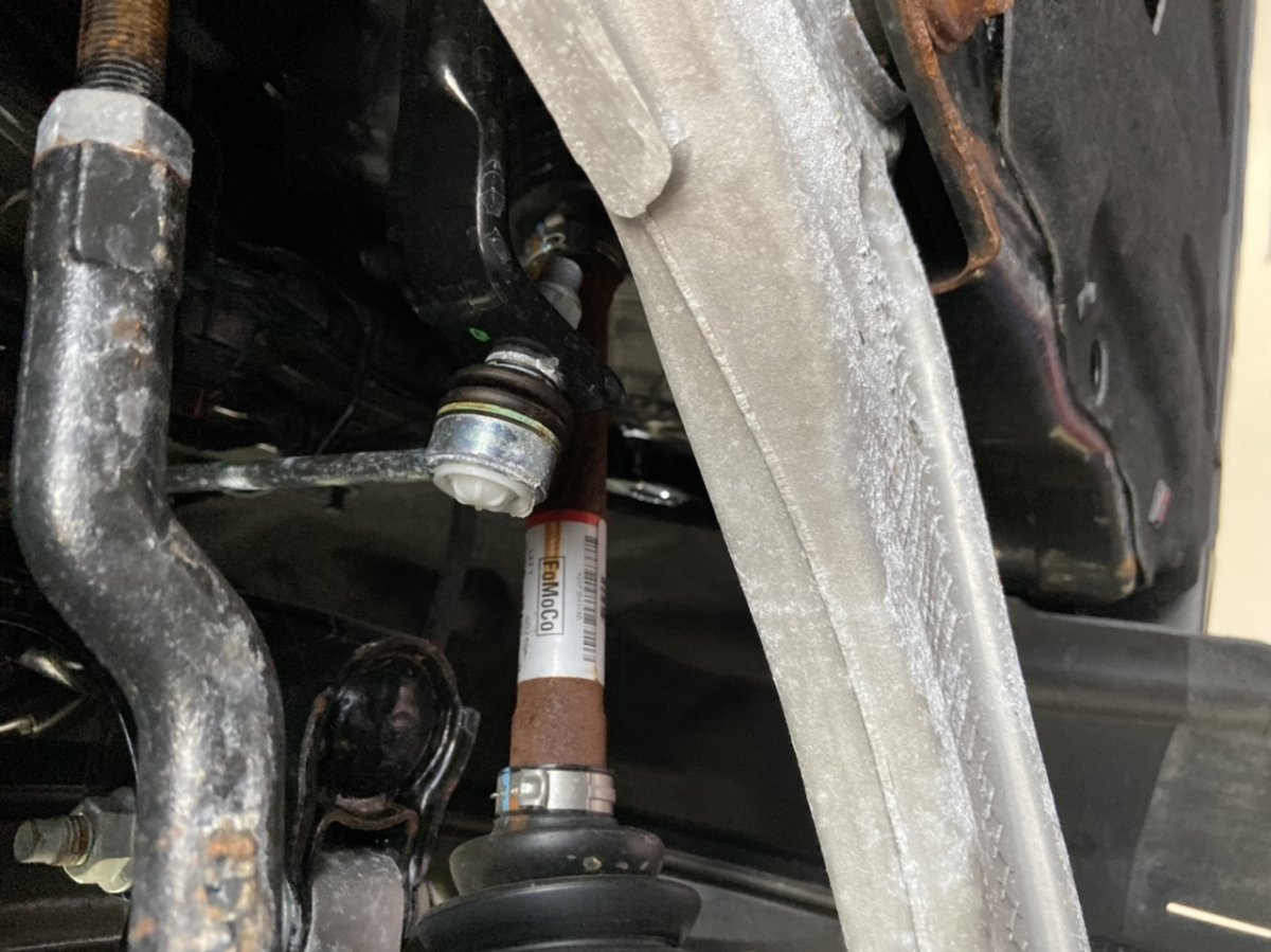

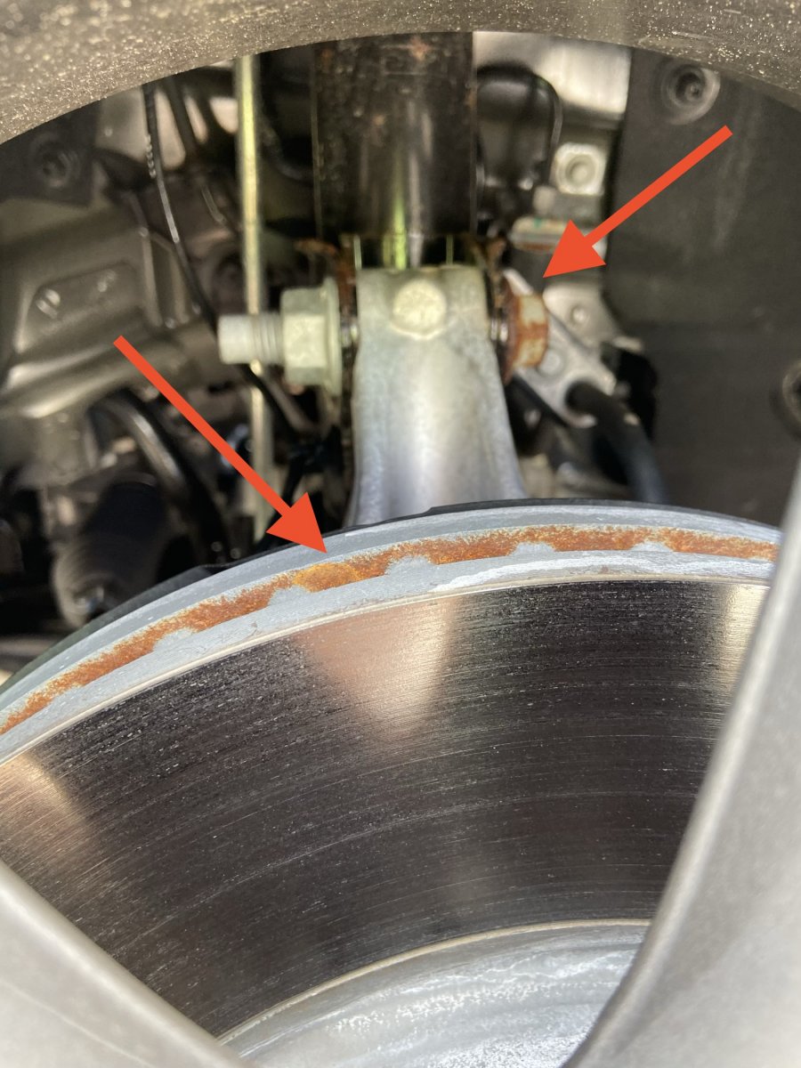

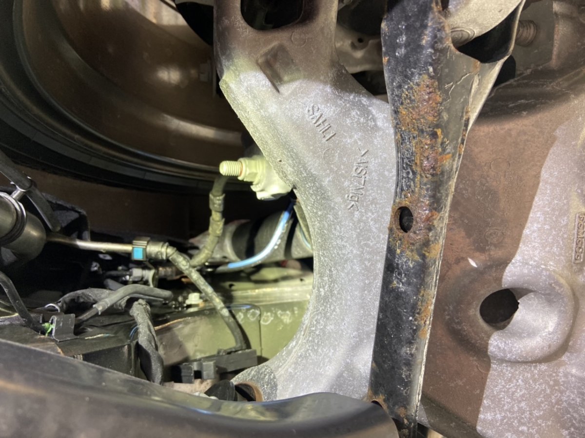

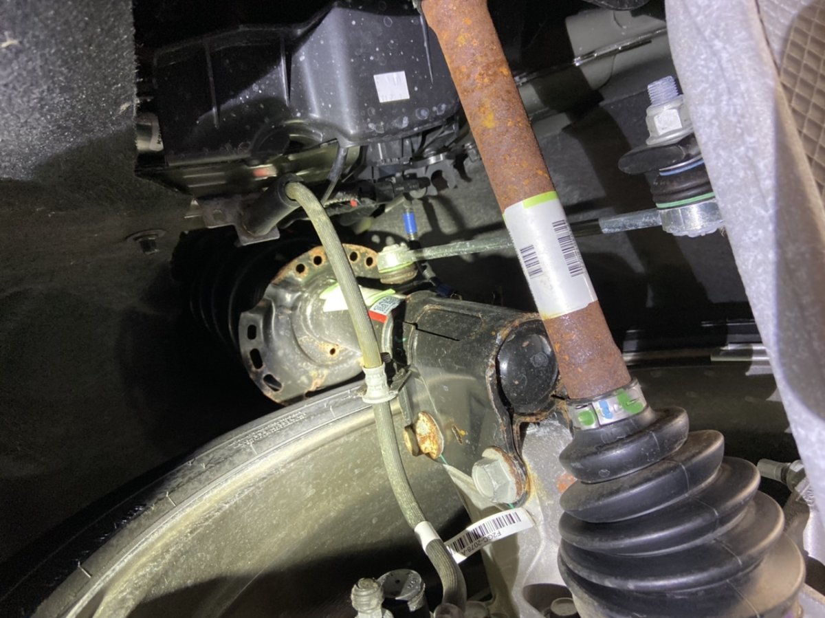

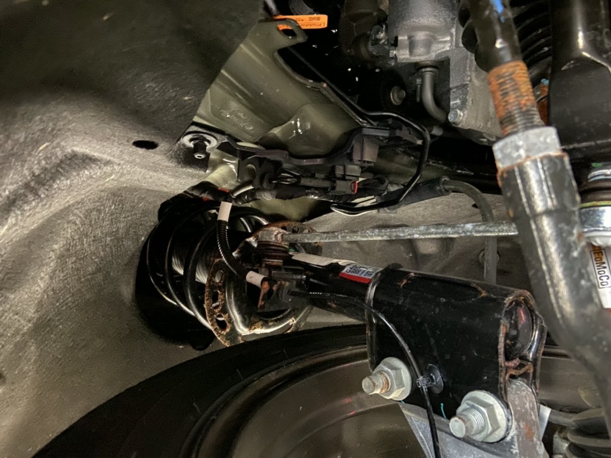

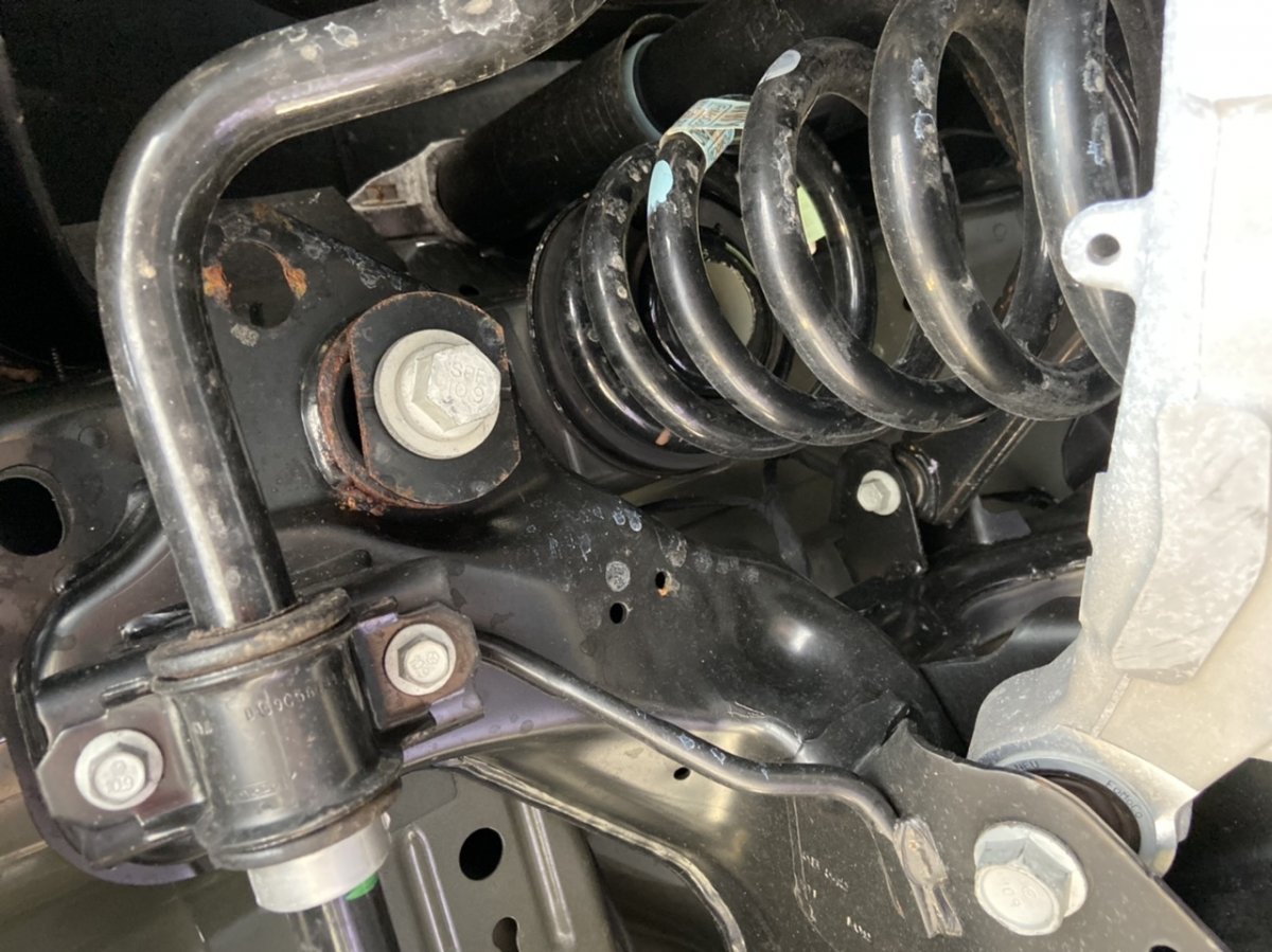

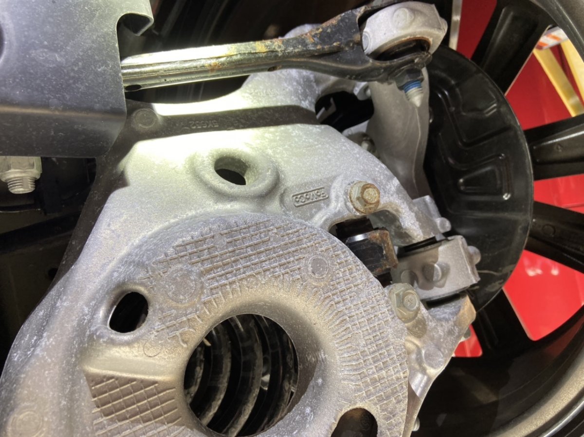

Do you know if it’s normal to have this type of “rust” in the front tire area? Pictures 1-3.

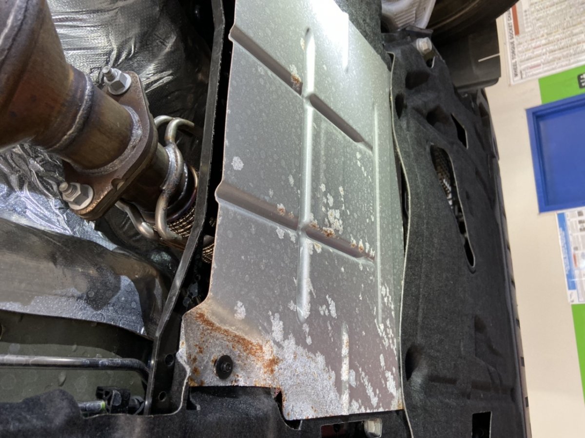

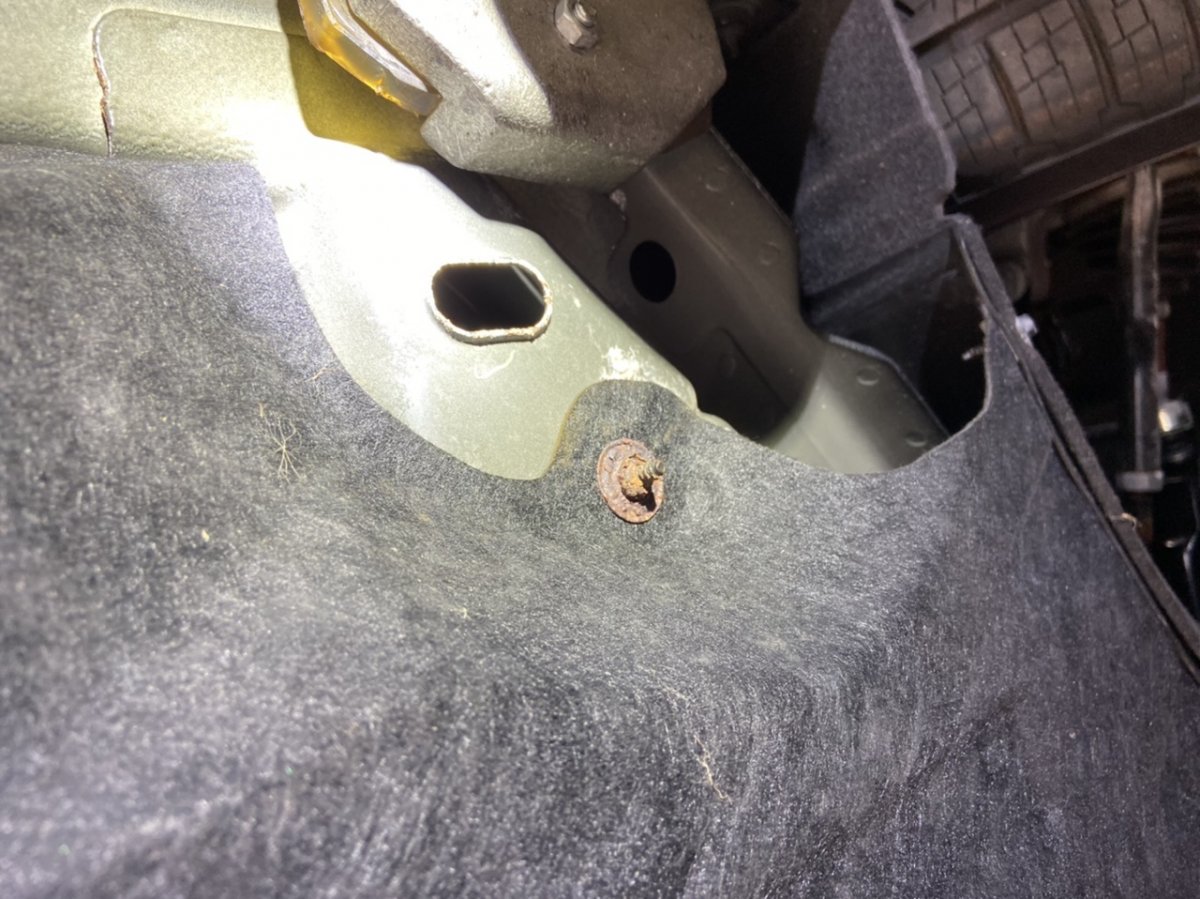

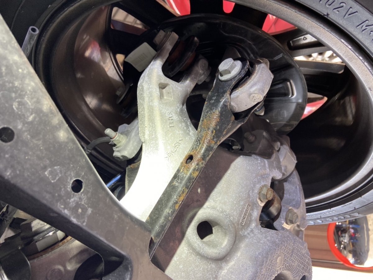

Does this look like corrosion or something on the back wheels? Picture 4

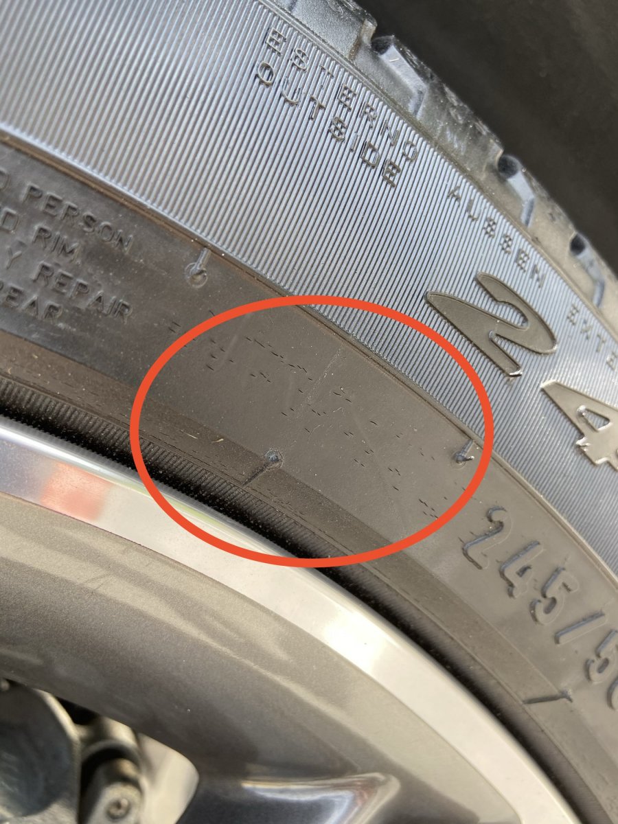

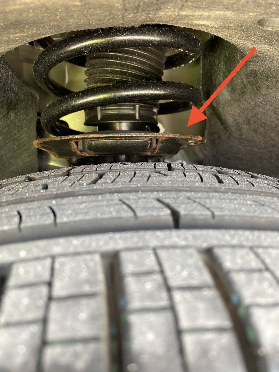

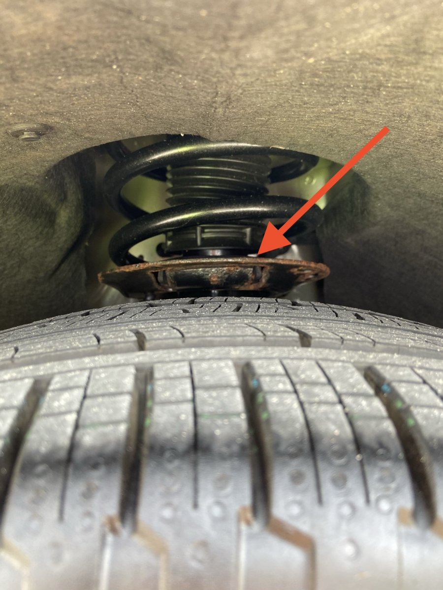

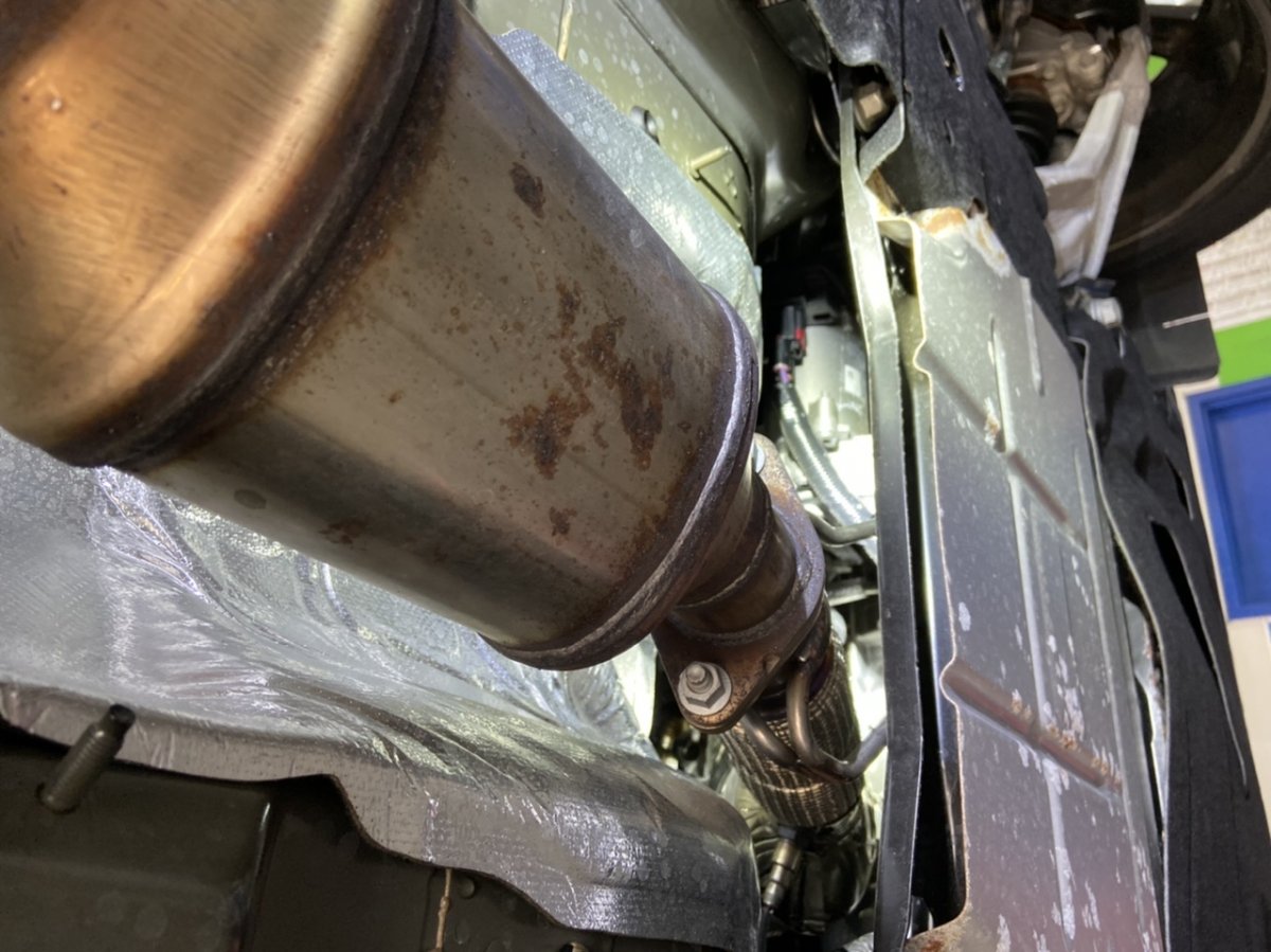

Also, there’s are these microscopic “cracks” on the side of the tire. Is this normal? Or could it be tire rot? Picture 5

Mild surface rust is normal and nothing to worry about.   I don't think the tires are rotten, but again I'd have a tire shop look at it.
They can test the runout on the tires the same way you test brake rotors to see if there is any variation.   They can also check the balance.

Ok this is just my opinion.
Pic 1 and 2 might bother me considering it's painted and hasn't seen 6 months of road abuse or so to start beating up the paint.
Pics 3 and 4 the rust is on the bolts where raw metal gets exposed during assembly and is expected. Inside the rotors is normal for steel rotors and can form within weeks of new ones being put on.
Pic 4 that is quite normal. It isn't cracking, its minor imperfections from the molding process and can be found on almost any tire in my experience and knowledge.

I had my mechanic take a look today. He said there’s a lot of rust and corrosion for such a new vehicle.
Looks fine to me, I wouldn't worry about any of that. Surface rust is completely normal and expected. If you live in an area with low dew points/rains alot, this kind of stuff happens nearly instantly after driving off the lot. At least you don't live in an area that salts roads, or in beach town. I drive to the coast alot and all the cars older than a few years have bad rust. That salt from the ocean that wafts in the air is killer.
