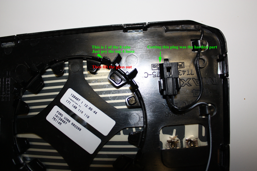

Lex Talionis Posted November 21, 2008 Report Share Posted November 21, 2008 Here's a picture that might help.Don't forget to rotate the whole mirror towards the front then push the glass down and to the left or right. Shine you flash light in and you'll see the tabs. I found it helped to push a small screwdriver into the gap created when you pry the first tab open, you'll have to remove it after the second tab so you can rotate the glass for access to the other 2 top tabs. Take your time and be gentle. Then just wiggle the glass out, unhook the heater wires. That small screwdriver will help with unhooking the Electrochromic plug. Hope this helps ab so your saying there is not enough wire to pull the glass away, turn it around and unhook the pigtail plug? you must undo the pigtail plug at the same time you undo the tabs & with a screw driver? Quote Link to comment Share on other sites More sharing options...

tpm419419 Posted November 21, 2008 Report Share Posted November 21, 2008 (edited) Here's a picture that might help.Don't forget to rotate the whole mirror towards the front then push the glass down and to the left or right. Shine you flash light in and you'll see the tabs. I found it helped to push a small screwdriver into the gap created when you pry the first tab open, you'll have to remove it after the second tab so you can rotate the glass for access to the other 2 top tabs. Take your time and be gentle. Then just wiggle the glass out, unhook the heater wires. That small screwdriver will help with unhooking the Electrochromic plug. Hope this helps ab I find it is much easier prying at the 3 tabs which I circled in the picture. pry the top tab and then one of the lower tabs and it will come right out. The picture shows the motor "Disc" still attached as someone yanked it off (they didn't twist the screwdriver) Edited November 21, 2008 by tpm419419 Quote Link to comment Share on other sites More sharing options...

ablb Posted November 21, 2008 Report Share Posted November 21, 2008 so your saying there is not enough wire to pull the glass away, turn it around and unhook the pigtail plug? you must undo the pigtail plug at the same time you undo the tabs & with a screw driver? Plenty of wire to pull the mirror a little way from the housing. ab Quote Link to comment Share on other sites More sharing options...

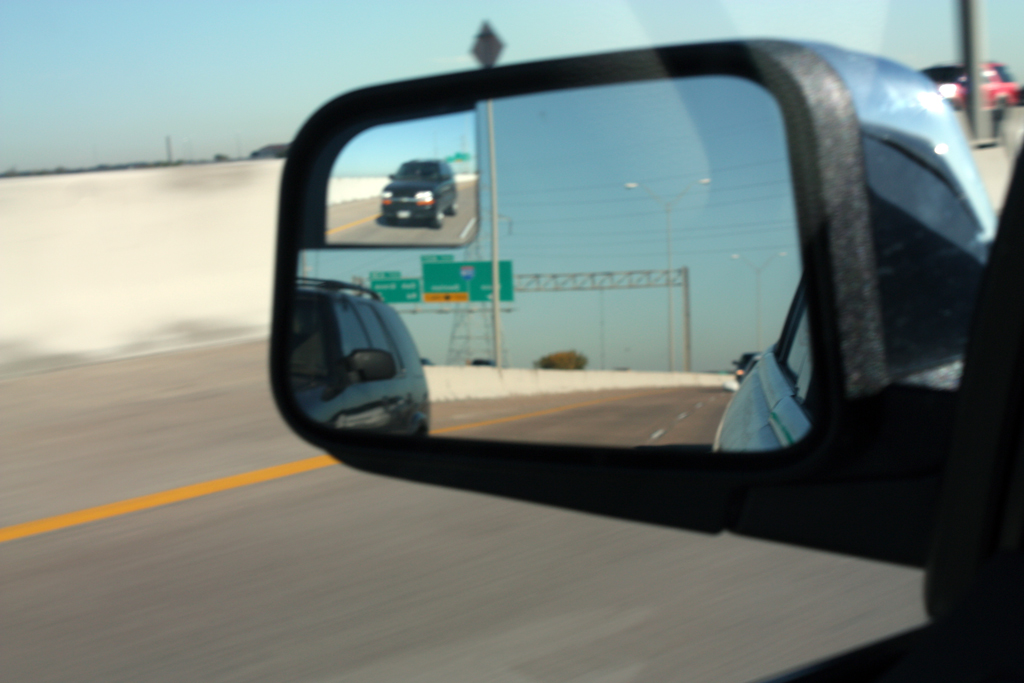

ablb Posted November 21, 2008 Report Share Posted November 21, 2008 ohhh man ablb.. akirby is gonna have a conniption fit when he sees what you did :do what: anyway.. you really do not see a need for both mirrors if that 1 is soooo great? These pictures were my first attempt and they did turn out pretty good. Big enough blind spot (see pic's 3 & 4 in my post above) to hide a Chevy Blazer. The camera was about where my wife's 5'6" eye would be. I didn't change the passenger mirror, I haven't noticed a blind spot. Plus I can't see the point in adding a convex mirror on top of a convex mirror . :beerchug: ab Quote Link to comment Share on other sites More sharing options...

ablb Posted November 22, 2008 Report Share Posted November 22, 2008 I spent less than 60 seconds adjusting my mirrors ONE TIME. Tonight I watched a car come up behind me in the left lane. It went from my rear view to my side view mirror and when it disappeared from my side view mirror the front of the vehicle was even with my rear door and I could see it without even turning my head more than a couple of inches. If you don't believe that then I don't really care. Stop trying to rationalize everything. I've been tought a little different method. Keep your eyes moving Look at the windshield mounted mirror, yep there's somebody behind me Look forward Look in the door mounted mirror, yep there's somebody back there Look forward Look at the windshield mounted mirror, nobody there Look forward Look in the door mounted mirror, yep there's somebody back there in the passing lane Look forward Look in the door mounted mirror, nobody there Look forward Turn on left sig Start moving to left lane, LOUD HOONKING Lean forward look in door mounted mirror, yep there's somebody back there Swerve back into lane This isn't a very good description but you get the point. You really need to be looking forward most of the time, don't look from one mirror to the other, PLEASE.... My wife might be making a emergency stop in front of you ab Quote Link to comment Share on other sites More sharing options...

Jaak in TO Posted November 26, 2008 Report Share Posted November 26, 2008 Installed the mirrors last night in about 10 minutes. The steps I used are as follows: 1. move the mirror body so that the mirror faces 90 degrees outwards from the vehicle. 2. Tilt the mirror so it faces downwards and towards the vehicle. 3. Use a standard width flat head screwdriver with a long shaft & a small flashlight. Look for a shallow slot on the outboard side where the mirror meets the motor that has two tabs, one on either side of the "slot". Place the screwdriver in this "slot" and twist it as if you are opening a "paint can". Wiggle it as you twist and you will notice the two halfs start to separate. Move the mirror slightly till you see the inboard slot. Repeat the same proceedure. Make sure you have a towel handy as the mirror will start to fall down. 4. The mirror should slide out with ease. Disconnect the two heated mirror leads from the mirror. This may be a bit tough as they are a tight fit. 5. Take the new mirror and connect the two heated mirror leads and connect it to the mirror leads. You may have to push it in a bit ... but not too hard. It will slide up the connector completely. 6. With a towel placed over the mirror, add a bit of force to get the mirror to seat in the motor housing. Use a rotating action (as listed earlier in this thread!) to seat the mirror. Make sure it is in. You may want to spend a bit of time doing this 7. With your hand & towel near the mirror give the mirror body a smack to ensure the mirror is set in place. First time mine was not properly seated and it popped out. The heated mirror power leads stopped if from falling to the floor. 8. Repeat on the other side. I then adjusted the mirrors to the optimum position and reset the "seating" position. The mirrors do take a little getting used to ... but the drive in to the office this morning on a very busy 12 lane highway was a little less stressfull as the vision to the sides is better. Too many lane changers trying to get a car length ahead. This is a good investment. My cost was $185 Canadian through my friends garage ... one could of gotten it cheaper on-line ... but the cost would of been more due to duty etc. Plus if there was an issue ... it could be returned with no issues. Hope this helps!!! Quote Link to comment Share on other sites More sharing options...
Kanatronic Posted December 21, 2008 Report Share Posted December 21, 2008 Installed the mirrors last night in about 10 minutes. The steps I used are as follows: 1. move the mirror body so that the mirror faces 90 degrees outwards from the vehicle. 2. Tilt the mirror so it faces downwards and towards the vehicle. 3. Use a standard width flat head screwdriver with a long shaft & a small flashlight. Look for a shallow slot on the outboard side where the mirror meets the motor that has two tabs, one on either side of the "slot". Place the screwdriver in this "slot" and twist it as if you are opening a "paint can". Wiggle it as you twist and you will notice the two halfs start to separate. Move the mirror slightly till you see the inboard slot. Repeat the same proceedure. Make sure you have a towel handy as the mirror will start to fall down. 4. The mirror should slide out with ease. Disconnect the two heated mirror leads from the mirror. This may be a bit tough as they are a tight fit. 5. Take the new mirror and connect the two heated mirror leads and connect it to the mirror leads. You may have to push it in a bit ... but not too hard. It will slide up the connector completely. 6. With a towel placed over the mirror, add a bit of force to get the mirror to seat in the motor housing. Use a rotating action (as listed earlier in this thread!) to seat the mirror. Make sure it is in. You may want to spend a bit of time doing this 7. With your hand & towel near the mirror give the mirror body a smack to ensure the mirror is set in place. First time mine was not properly seated and it popped out. The heated mirror power leads stopped if from falling to the floor. 8. Repeat on the other side. I then adjusted the mirrors to the optimum position and reset the "seating" position. The mirrors do take a little getting used to ... but the drive in to the office this morning on a very busy 12 lane highway was a little less stressfull as the vision to the sides is better. Too many lane changers trying to get a car length ahead. This is a good investment. My cost was $185 Canadian through my friends garage ... one could of gotten it cheaper on-line ... but the cost would of been more due to duty etc. Plus if there was an issue ... it could be returned with no issues. Hope this helps!!! Is there any version not heated, as my SEL has no heated mirrors, IMO to pay for something that will not be used is a waste. BTW do you have the part numbers for those at least??? Quote Link to comment Share on other sites More sharing options...
