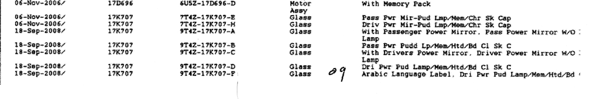

Lex Talionis Posted November 12, 2008 Report Share Posted November 12, 2008 Can u please post the left and right part numbers? Thanks use the part numbers already provided by Ablb, plug them into the websites search part number function, and you will see the same info he already provided 9T4Z17K707C $74.98 $0.00 $51.74 GLASS ASY - REAR VIE 9T4Z17K707D $74.98 $0.00 $51.74 GLASS ASY - REAR VIE but not sure where er65nsunny gets $120 for a pair? it is a pretty convoluted search function.. put in "glass" for example and you get no results, but clearly "glass" is used in the terms.. Quote Link to comment Share on other sites More sharing options...
tpm419419 Posted November 12, 2008 Report Share Posted November 12, 2008 use the part numbers already provided by Ablb, plug them into the websites search part number function, and you will see the same info he already provided 9T4Z17K707C $74.98 $0.00 $51.74 GLASS ASY - REAR VIE 9T4Z17K707D $74.98 $0.00 $51.74 GLASS ASY - REAR VIE but not sure where er65nsunny gets $120 for a pair? it is a pretty convoluted search function.. put in "glass" for example and you get no results, but clearly "glass" is used in the terms.. Maybe the 120.00 is with shipping and or tax?? Quote Link to comment Share on other sites More sharing options...
er65nsunny Posted November 13, 2008 Report Share Posted November 13, 2008 (edited) Items Ordered: Item: GLASS ASY - REAR VIE Price: $51.74 Tax: $0.00 Qty: 1 Total: $51.74 Item: GLASS ASY - REAR VIE Price: $55.80 Tax: $0.00 Qty: 1 Total: $55.80 ----------------------------- Items Total: $107.54 Shipping: $11.83 Handling Fee: $0.00 Order Total: $119.37 You want 9T4Z17K707B and 9T4Z17K707D if you have the puddle lamps. The passenger side is $55.80 and the drivers side is $51.74 Edited November 13, 2008 by er65nsunny Quote Link to comment Share on other sites More sharing options...
tpm419419 Posted November 13, 2008 Report Share Posted November 13, 2008 you want 9T4Z17K707B and 9T4Z17K707D if you have the puddle lamps. The passenger side is $55.80 and the drivers side is $51.74 Thanks for that clarification. I just ordered mine from my brothers body shop giving him an SEL Vin number. Just called him back to give him a Limited Vin. Just in time!!. The Limited comes standard with heat and puddle lamps as my '07 SEL does. The new '09 SEL does not have that as standard or perhaps even optional equipment. Quote Link to comment Share on other sites More sharing options...
Lex Talionis Posted November 13, 2008 Report Share Posted November 13, 2008 Items Ordered:Item: GLASS ASY - REAR VIE Price: $51.74 Tax: $0.00 Qty: 1 Total: $51.74 Item: GLASS ASY - REAR VIE Price: $55.80 Tax: $0.00 Qty: 1 Total: $55.80 ----------------------------- Items Total: $107.54 Shipping: $11.83 Handling Fee: $0.00 Order Total: $119.37 You want 9T4Z17K707B and 9T4Z17K707D if you have the puddle lamps. The passenger side is $55.80 and the drivers side is $51.74 Do you have a Limited? I will be curious to see this goes for you guys. I could see how heated mirrors matter, but not sure why having puddle lamps plays a role or not. the puddle lamps do not interact with the glass of the mirror like the heat does, so why would that matter. also, why would the passengers be more costly? Quote Link to comment Share on other sites More sharing options...
ablb Posted November 13, 2008 Report Share Posted November 13, 2008 Do you have a Limited? I will be curious to see this goes for you guys. I could see how heated mirrors matter, but not sure why having puddle lamps plays a role or not. the puddle lamps do not interact with the glass of the mirror like the heat does, so why would that matter. also, why would the passengers be more costly? I'm wondering the same thing? Why so many mirrors? After seeing them, I'm not going to change the passenger mirror ab Quote Link to comment Share on other sites More sharing options...

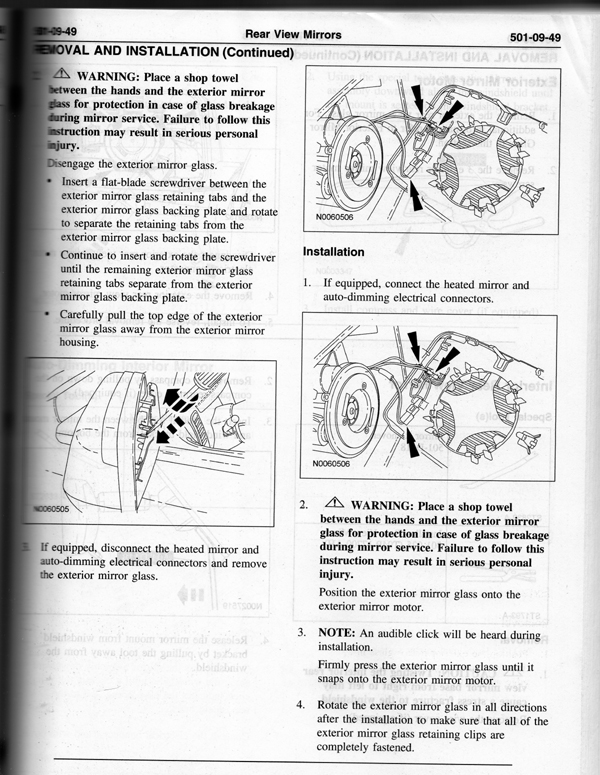

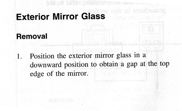

tpm419419 Posted November 13, 2008 Report Share Posted November 13, 2008 OK so now that we have that out of the way does anyone know the easiest way of removing and replacing the mirror glass? I found this procedure pertaining to a 2004 F150 so maybe the Edge has it's own little trick (which I couldn't find) 1. Position exterior mirror glass in the full UP position. 2. Locate the notch at the bottom of the exterior mirror glass. 3. Release the mirror glass Insert a long flat head screwdriver in the notch. Push the screwdriver into the notch until the glass is released. Note: If equipped with heated mirrors disconnect the electrical connector from the exterior mirror glass. Installation: 1. If equipped with heated mirrors, connect the electrical connector to the back of the mirror. 2. Position the exterior mirror glass onto the mirror motor. 3. Place one hand on the back of the exterior mirror housing and hand flat on the exterior mirror glass. Press the mirror glass in place until fully seated. You could place a towel between your hand and the mirror in case the mirror breaks while you are applying pressure. Quote Link to comment Share on other sites More sharing options...
ablb Posted November 14, 2008 Report Share Posted November 14, 2008 OK so now that we have that out of the way does anyone know the easiest way of removing and replacing the mirror glass?I found this procedure pertaining to a 2004 F150 so maybe the Edge has it's own little trick (which I couldn't find) 1. Position exterior mirror glass in the full UP position. 2. Locate the notch at the bottom of the exterior mirror glass. 3. Release the mirror glass Insert a long flat head screwdriver in the notch. Push the screwdriver into the notch until the glass is released. Note: If equipped with heated mirrors disconnect the electrical connector from the exterior mirror glass. Installation: 1. If equipped with heated mirrors, connect the electrical connector to the back of the mirror. 2. Position the exterior mirror glass onto the mirror motor. 3. Place one hand on the back of the exterior mirror housing and hand flat on the exterior mirror glass. Press the mirror glass in place until fully seated. You could place a towel between your hand and the mirror in case the mirror breaks while you are applying pressure. Looks like Lex might know. But you might as well wait until you get your mirrors, maybe you'll get instructions. My 05 F250 instructions say to "(1) On both electric and manually actuated mirrors push the convex spotter glass both upward and outboard as far as possible as shown in Figure A. (LH shown - RH opposite) (2) Remove the Backing Plate assembly by inserting a screwdriver between the Backing Plate and the case rear (as shown in Figure A), and prise the backing plate from its pivot with the screwdriver." No notch just push up/out and pry it off, the main mirror instructions are the same. ab Quote Link to comment Share on other sites More sharing options...
er65nsunny Posted November 14, 2008 Report Share Posted November 14, 2008 (edited) From the Edge shop manual Edited November 14, 2008 by er65nsunny Quote Link to comment Share on other sites More sharing options...
tpm419419 Posted November 14, 2008 Report Share Posted November 14, 2008 Thank you for the proper instructions Sunny Quote Link to comment Share on other sites More sharing options...
