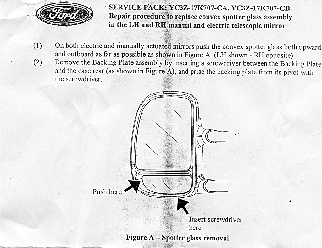

Lex Talionis Posted November 6, 2008 Report Share Posted November 6, 2008 If it's like my F250 2 screwdrivers 1 on top the other on the bottom (or either side) and just pry it off. I'll let you experiment with prying it apart & postin up the results Limited mirror bodies are painted, so not to excited by that prospect But the instructions should come with the new mirror. not sure how many parts you have bought from a parts department at a dealer, but in my experience, I wouldn't expect any directions. I would expect a box and a mirror. you might get directions if you buy an 'accessory', and they will suck if you do, but not really for "parts" as they are assuming the dealer is installing and don't often have directions for sold parts. case in point, I just installed a new sliding glass window motor in a Ford Mustang for a buddy to help him save money, not a single instruction included with that 'part'. Quote Link to comment Share on other sites More sharing options...
druck52 Posted November 7, 2008 Report Share Posted November 7, 2008 I'll let you experiment with prying it apart & postin up the results Limited mirror bodies are painted, so not to excited by that prospect not sure how many parts you have bought from a parts department at a dealer, but in my experience, I wouldn't expect any directions. I would expect a box and a mirror. you might get directions if you buy an 'accessory', and they will suck if you do, but not really for "parts" as they are assuming the dealer is installing and don't often have directions for sold parts. case in point, I just installed a new sliding glass window motor in a Ford Mustang for a buddy to help him save money, not a single instruction included with that 'part'. Lex you are right. There will be no instructions included. I believe on those you grab the mirror and pull. But without looking it up i can't be 100% sure of that. Quote Link to comment Share on other sites More sharing options...
Lex Talionis Posted November 7, 2008 Report Share Posted November 7, 2008 But without looking it up i can't be 100% sure of that. what do you mean, do you have some sort of reference manual or access to something that would confirm/deny this? Quote Link to comment Share on other sites More sharing options...
ablb Posted November 7, 2008 Report Share Posted November 7, 2008 If it's like my F250 2 screwdrivers 1 on top the other on the bottom (or either side) and just pry it off. But the instructions should come with the new mirror. ab I'll let you experiment with prying it apart & postin up the results Limited mirror bodies are painted, so not to excited by that prospect not sure how many parts you have bought from a parts department at a dealer, but in my experience, I wouldn't expect any directions. I would expect a box and a mirror. you might get directions if you buy an 'accessory', and they will suck if you do, but not really for "parts" as they are assuming the dealer is installing and don't often have directions for sold parts. case in point, I just installed a new sliding glass window motor in a Ford Mustang for a buddy to help him save money, not a single instruction included with that 'part'. Not to sure about the Edge/MKX, looks like we'll have to wait a few more weeks. But sometime a picture is worth a thousand words. ab Quote Link to comment Share on other sites More sharing options...
Lex Talionis Posted November 7, 2008 Report Share Posted November 7, 2008 (edited) I am a bit surprised that those F series mirrors came with instructions.. but sure enough, looks like you got some. I have bought many parts for many of my cars over the years from dealers - if I could not get them from the web - and cannot ever recall getting instructions with a single part. We will see what will happen I suppose... "looks like we'll have to wait a few more weeks" why, are you ordering some for the Edge then? if so, post up part numbers (drivers & passengers) for just the mirrors BTW.. I was actually thinking today, on a hunch, that of you tilted them to the uppermost (or lowest) position they can be in, there might be some kind of release behind them to pop out the glass. these directions hint that I was kind of on track with how to access a release method as when I changed out my custom puddle LED lamps, I notice if I really allowed the adjustable mirror to tilt all the way up (or down) I could kind of get finger access behind the glass Edited November 7, 2008 by Lex Talionis Quote Link to comment Share on other sites More sharing options...
ablb Posted November 7, 2008 Report Share Posted November 7, 2008 I am a bit surprised that those F series mirrors came with instructions.. but sure enough, looks like you got some. I have bought many parts for many of my cars over the years from dealers - if I could not get them from the web - and cannot ever recall getting instructions with a single part. We will see what will happen I suppose... "looks like we'll have to wait a few more weeks" why, are you ordering some for the Edge then? if so, post up part numbers (drivers & passengers) for just the mirrors BTW.. I was actually thinking today, on a hunch, that of you tilted them to the uppermost (or lowest) position they can be in, there might be some kind of release behind them to pop out the glass. these directions hint that I was kind of on track with how to access a release method as when I changed out my custom puddle LED lamps, I notice if I really allowed the adjustable mirror to tilt all the way up (or down) I could kind of get finger access behind the glass If the budget allows I'll be ordering the drivers side from Lincoln. The F250 mirror cost $90.00 so I figure you can add a 1 in front of the 9 for the MKX. I was working with a Ford dealer till someone mention that the MKX mirror is "Driver's Side Electrochromic (Auto Dimming)". Which brings up the passenger mirror. Why would they put a concave (wide angle) mirror on a mirror that already has a wide angle view :wacko: ? If they do I won't be replacing ours. The instructions for the F250 are very detailed (5 pages), maybe the Edge/MKX will be the same. A word to the wise: If Ford or GM file bankruptcy and you car is in their service dept. you WILL get you car back SOMEDAY. ab Quote Link to comment Share on other sites More sharing options...
druck52 Posted November 8, 2008 Report Share Posted November 8, 2008 If the budget allows I'll be ordering the drivers side from Lincoln.The F250 mirror cost $90.00 so I figure you can add a 1 in front of the 9 for the MKX. I was working with a Ford dealer till someone mention that the MKX mirror is "Driver's Side Electrochromic (Auto Dimming)". Which brings up the passenger mirror. Why would they put a concave (wide angle) mirror on a mirror that already has a wide angle view :wacko: ? If they do I won't be replacing ours. The instructions for the F250 are very detailed (5 pages), maybe the Edge/MKX will be the same. A word to the wise: If Ford or GM file bankruptcy and you car is in their service dept. you WILL get you car back SOMEDAY. ab You were very lucky to get instructions. I would say about 90% or more of fords parts do not come with instrctions. Quote Link to comment Share on other sites More sharing options...
druck52 Posted November 8, 2008 Report Share Posted November 8, 2008 what do you mean, do you have some sort of reference manual or access to something that would confirm/deny this? I'm a ford tech. I don't post often, but I post once in awhile when i can help. To take it off. you pretty much just pry it off and then snap the new one on. Quote Link to comment Share on other sites More sharing options...

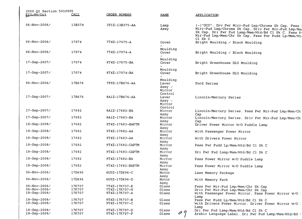

tpm419419 Posted November 11, 2008 Report Share Posted November 11, 2008 Ok The simple question remains... Does the 2009 mirror fit the 2007-8 Edge? I took a peek at an '09 and do like the new mirror. I am willing to pay almost 200.00 for the pair but need to know it is going to fit first. Due to a neck injury my head doesn't swivel so easily and a built in convex mirror would be a tremendous help. I do have stick on convex mirrors on my 2007 Edge but it is not as good as an integrated one. Thanks Quote Link to comment Share on other sites More sharing options...
akirby Posted November 11, 2008 Report Share Posted November 11, 2008 Are they safer? Of course - especially for drivers who don't aim their mirrors properly and don't glance over their shoulder when changing lanes. Am I glad they're being offered? Yes. Would I want them on my next vehicle? Sure. I just wouldn't go to all that trouble to add them to my Edge now. Then again I don't have a problem operating the Vista Roof controls at night, either. Quote Link to comment Share on other sites More sharing options...
ablb Posted November 12, 2008 Report Share Posted November 12, 2008 Ok The simple question remains... Does the 2009 mirror fit the 2007-8 Edge? I took a peek at an '09 and do like the new mirror. I am willing to pay almost 200.00 for the pair but need to know it is going to fit first. Due to a neck injury my head doesn't swivel so easily and a built in convex mirror would be a tremendous help. I do have stick on convex mirrors on my 2007 Edge but it is not as good as an integrated one. Thanks Don't quote me on this , but yes they will fit. I spent some time at a Ford parts dept today and I got some part #'s, see attached. BUT The parts guy said to do this. Go find an 09 with your trim level (Limited, SEL etc) and get the VIN # off of that Edge then go inside and order a mirror for that Edge. I searched on Amazon and found these http://www.amazon.com/Ford-9T4Z-17K707-C-G...19&sr=1-237 http://www.amazon.com/Ford-9T4Z-17K707-D-G...03&sr=1-252 and a few more. Looks like each mirror will be about $75.00 at Ford. And should just snap off then on. Note to MKX owners: He said if I bring him a 09 MKX VIN he can order a mirror for me. ab Quote Link to comment Share on other sites More sharing options...
