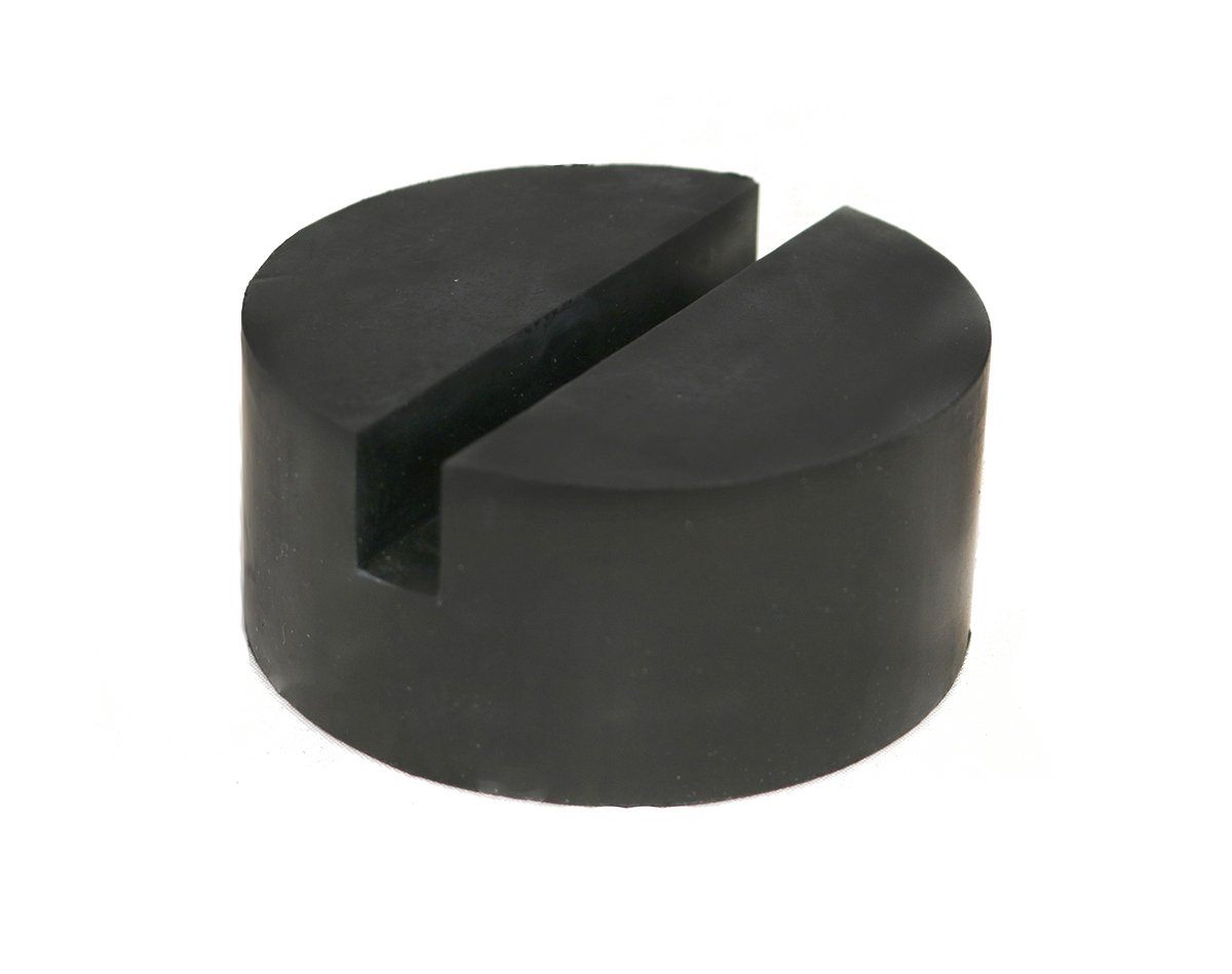

Gadgetjq Posted October 4, 2019 Report Share Posted October 4, 2019 (edited) I can't tell you whether it'll work or not, much depends on the capacity of your jack but, two things. 1. You'll need a pair of hockey pucks with slots cut in them so you don't crush the seam while lifting ( https://amzn.to/2IqOqel ) 2. HF frequently offers 20% off coupons in their emailed ads. Wait for one of those if you don't already have one lying around and save a few $$$. Edited October 4, 2019 by Gadgetjq added photo 2 Quote Link to comment Share on other sites More sharing options...
