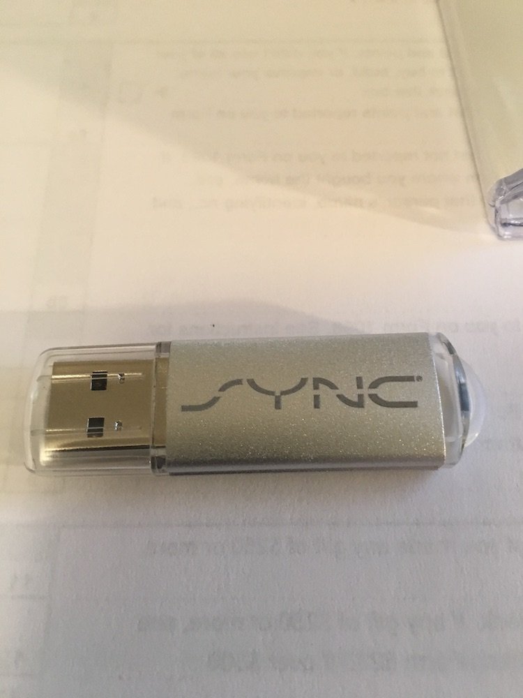

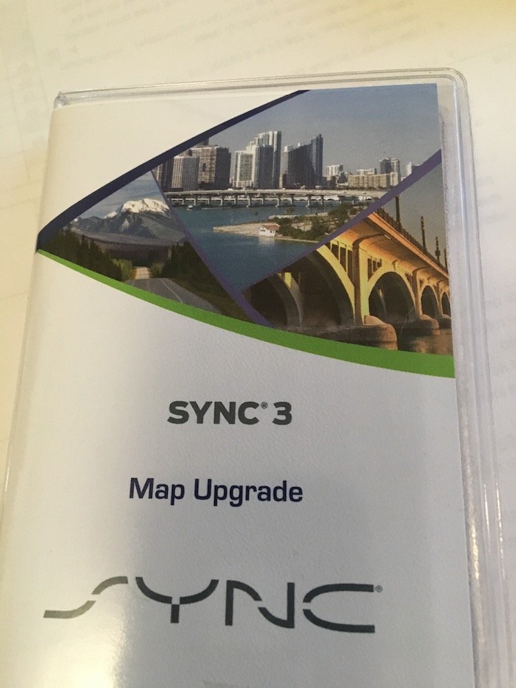

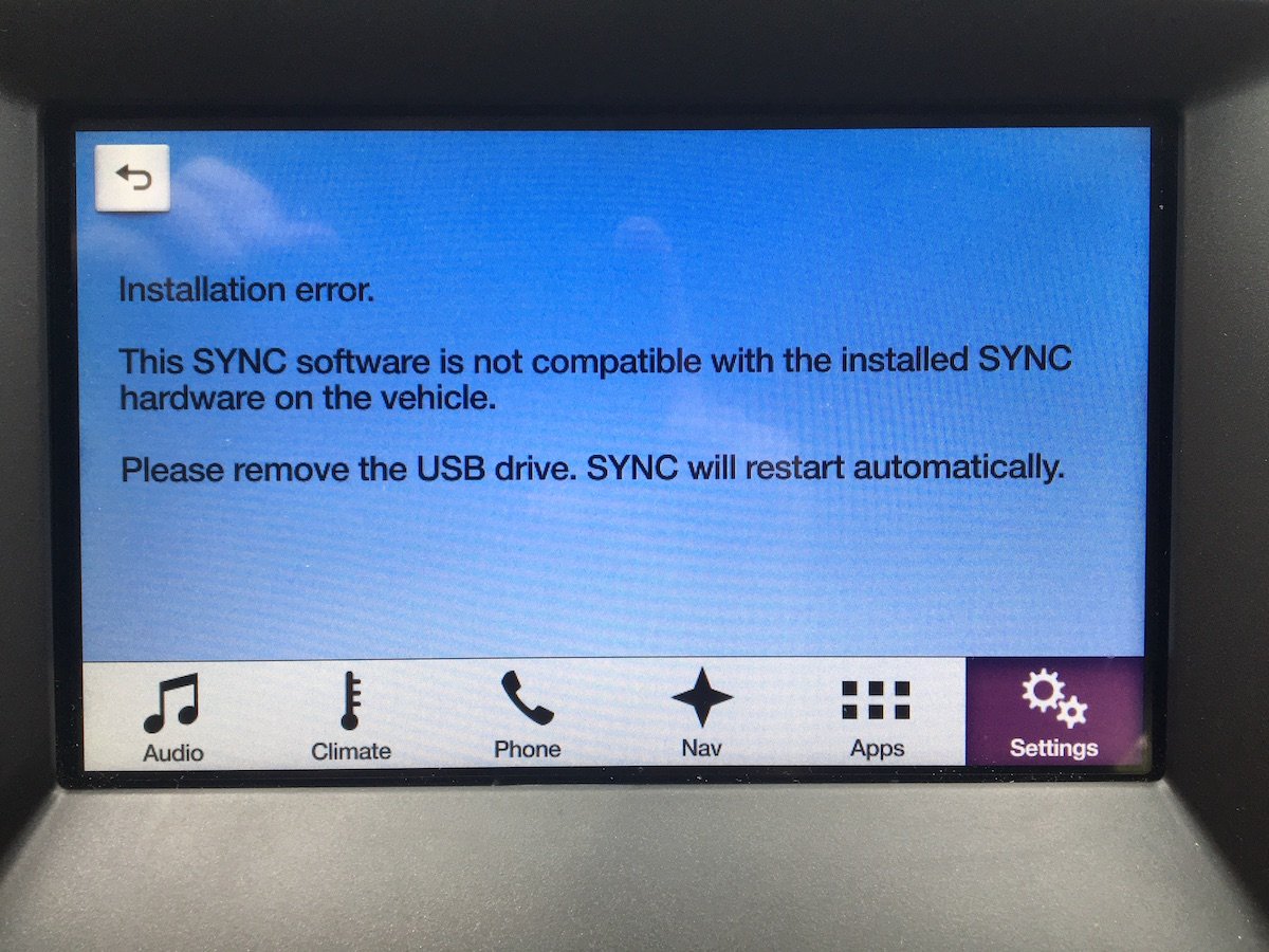

Xtra Posted October 3, 2019 Report Share Posted October 3, 2019 (edited) I also have a 2016 Sport and I bought the SYNC upgrade thumb drive from Ford. Carefully following all instructions when I ordered to guarantee compatibility with my car. Just plug it into the port and follow the instructions. How easy is that ? Well it turns out not so easy at all. !! As soon as I plugged the drive into the port an error message appeared stating that the software is not compatible with my hardware. What? I attempted several times to no avail so I contacted Ford where I bought the drive. The customer service rep was very nice and took my information and told me Ford was going to contact me with a fix. It has been 4 days and no call back or email from Ford . . ... Ford just called as I am typing this!! I was just told to contact Ford CRC ( Customer Care Center 800-392-36673 ) . I will do that now. OK then I just got off the phone and I was just told that I need to update my SYNC to version 3.3 and then the thumb drive will work . It takes about 45min to one hour to do the 3.3 update and another 45 to one hour for the maps. Lets hope this works. Edited October 3, 2019 by Xtra Quote Link to comment Share on other sites More sharing options...
jmr061 Posted October 3, 2019 Report Share Posted October 3, 2019 On 10/3/2019 at 4:43 PM, Xtra said: I also have a 2016 Sport and I bought the SYNC upgrade thumb drive from Ford, it was a very expensive way to go. Carefully following all instructions when I ordered giving my VIN # and SYNC ESN # to guarantee compatibility with my car. I was willing to pay more to save me time and for the ease of installation . Just plug it into the port and follow the instructions. How easy is that ? Well it turns out not so easy at all. !! As soon as I plugged the drive into the port an error message appeared stating that the software is not compatible with my hardware. What? I attempted several times to no avail so I contacted Ford. The customer service rep was very nice and took my information and told me Ford was going to contact me with a fix. It has been 4 days and no call back or email from Ford . . ... Ford just called as I am typing this!! I was just told to contact Ford CRC and they gave me the # to call. I will do that now. Expand Are you running Version 3.0? Quote Link to comment Share on other sites More sharing options...

jmr061 Posted October 3, 2019 Report Share Posted October 3, 2019 ah a 2016 doesn't support 3.3, only 3.0 Quote Link to comment Share on other sites More sharing options...
Gadgetjq Posted October 3, 2019 Report Share Posted October 3, 2019 On 10/3/2019 at 4:43 PM, Xtra said: OK then I just got off the phone and I was just told that I need to update my SYNC to version 3.3 and then the thumb drive will work . It takes about 45min to one hour to do the 3.3 update and another 45 to one hour for the maps. Lets hope this works. Expand Please let us know if you manage to update your system to V3.3 and how you did it. The most recent update I've seen for my '16 is V3.0. I'm thinking you've gotten some bogus information from support but who knows, maybe there's a way 1 Quote Link to comment Share on other sites More sharing options...
Xtra Posted October 3, 2019 Report Share Posted October 3, 2019 (edited) On 10/3/2019 at 5:13 PM, jmr061 said: ah a 2016 doesn't support 3.3, only 3.0 Expand Just got off the phone with my dealer service manager and found out there is no such thing as SYNC 3.3 only 3.0 . I called Ford again to verify and for sure there is no 3.3. only 3.0 .The guy at CRC had no clue 3.3 wow !! He also told me if I have any problems to call the SYNC support line .. They were the first people I called 4 days ago .I also discovered that I am running SYNC3 version 2.0 and it can be upgraded to 3.0 easy enough. I am going to do that next week and then we will see if the navigation and maps update. Fingers crossed. Edited October 3, 2019 by Xtra Quote Link to comment Share on other sites More sharing options...
jmr061 Posted October 3, 2019 Report Share Posted October 3, 2019 On 10/3/2019 at 8:04 PM, Xtra said: Just got off the phone with my dealer service manager and found out there is no such thing as SYNC 3.3 only 3.0 . The guy at CRC had no clue 3.3 wow !! He also told me if I have any problems to call the SYNC support line .. They were the first people I called 4 days ago .I also discovered that I am running SYNC3 version 2.0 and it can be upgraded to 3.0 easy enough. I am going to do that next week and then we will see if the navigation and maps update. Fingers crossed. Expand One of the first thing the map update instructions should say is that you system has to be running version 3.0 It is a requirement. 1 Quote Link to comment Share on other sites More sharing options...
Xtra Posted October 3, 2019 Report Share Posted October 3, 2019 (edited) On 10/3/2019 at 8:06 PM, jmr061 said: One of the first thing the map update instructions should say is that you system has to be running version 3.0 It is a requirement. Expand Agree completely and they should tell you that before you buy it. . Edited October 3, 2019 by Xtra Quote Link to comment Share on other sites More sharing options...
ONEDGE16 Posted October 3, 2019 Report Share Posted October 3, 2019 (edited) On 10/3/2019 at 8:04 PM, Xtra said: Just got off the phone with my dealer service manager and found out there is no such thing as SYNC 3.3 only 3.0 . I called Ford again to verify and for sure there is no 3.3. only 3.0 .The guy at CRC had no clue 3.3 wow !! He also told me if I have any problems to call the SYNC support line .. They were the first people I called 4 days ago .I also discovered that I am running SYNC3 version 2.0 and it can be upgraded to 3.0 easy enough. I am going to do that next week and then we will see if the navigation and maps update. Fingers crossed. Expand They are referring to Sync 3.0 Version 3.3 Edited October 3, 2019 by ONEDGE16 1 Quote Link to comment Share on other sites More sharing options...
Xtra Posted October 3, 2019 Report Share Posted October 3, 2019 OMG there is a version 3.3, this has been such a mess. I have been told so much different conflicting information my head is spinning. I need to call my service manager and talk to him again. Quote Link to comment Share on other sites More sharing options...
jmr061 Posted October 3, 2019 Report Share Posted October 3, 2019 On 10/3/2019 at 9:59 PM, Xtra said: OMG there is a version 3.3, this has been such a mess. I have been told so much different conflicting information my head is spinning. I need to call my service manager and talk to him again. Expand The 16-18 Edge max out currently at 3.0, 3.2 and above is for the 19+ Edge only. 1 Quote Link to comment Share on other sites More sharing options...
ONEDGE16 Posted October 3, 2019 Report Share Posted October 3, 2019 (edited) you'll be fine once you update your Sync from Sync 2.0 to 3.0 version 3.1 to 3.3 are minor updates to Sync 3.0 Minimum requirement for the map updates is the Major version Sync 3.0 FordInstructionsSyncPre Sync3.2.pdfFetching info... Edited October 3, 2019 by ONEDGE16 1 1 Quote Link to comment Share on other sites More sharing options...
Xtra Posted October 4, 2019 Report Share Posted October 4, 2019 (edited) ONEDGE16 the PDF you gave has the exact answer needed in the troubleshooting section. This forum is an amazing resource and it is the members that make it so. Thanks to everyone for your help. Edited October 4, 2019 by Xtra Quote Link to comment Share on other sites More sharing options...
